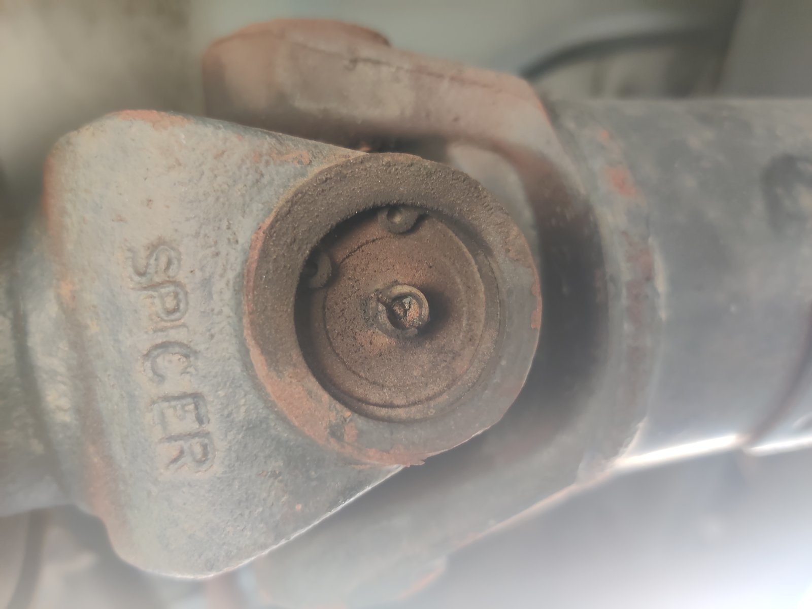

    I don't detect any slop in the U-Joint...but I don't know if trying to move it around by hand should show anything. The only U-Joint I have ever replaced on a truck was at the point of total failure when I bought that particular truck (not this one) and it was obviously worn. The one on this truck has surface rust and looks like it could use grease, but does not appear to be greasable. When I flex the shaft by hand the shaft moves in the rubber around the carrier bearing a bit, but the joint does not slop or jiggle at all. When I look online those parts a super cheap ($50 bucks at the most) so I might just go ahead and replace the carrier bearing and the U-joint and see if that solves the problem. If it is not this It is likely something that I would need tools I don't have and experience that I don't have. All I need to buy is a ball joint c-Press. Those are only about $30 also.

    If the cap looks like it has rust coming out where the seal is, most likely it is a dry joint which will cause a vibration under a load.

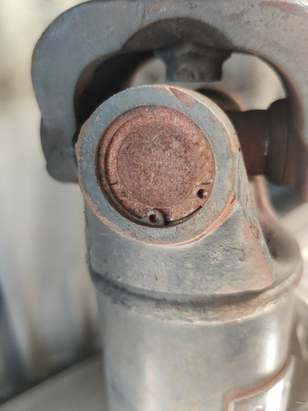

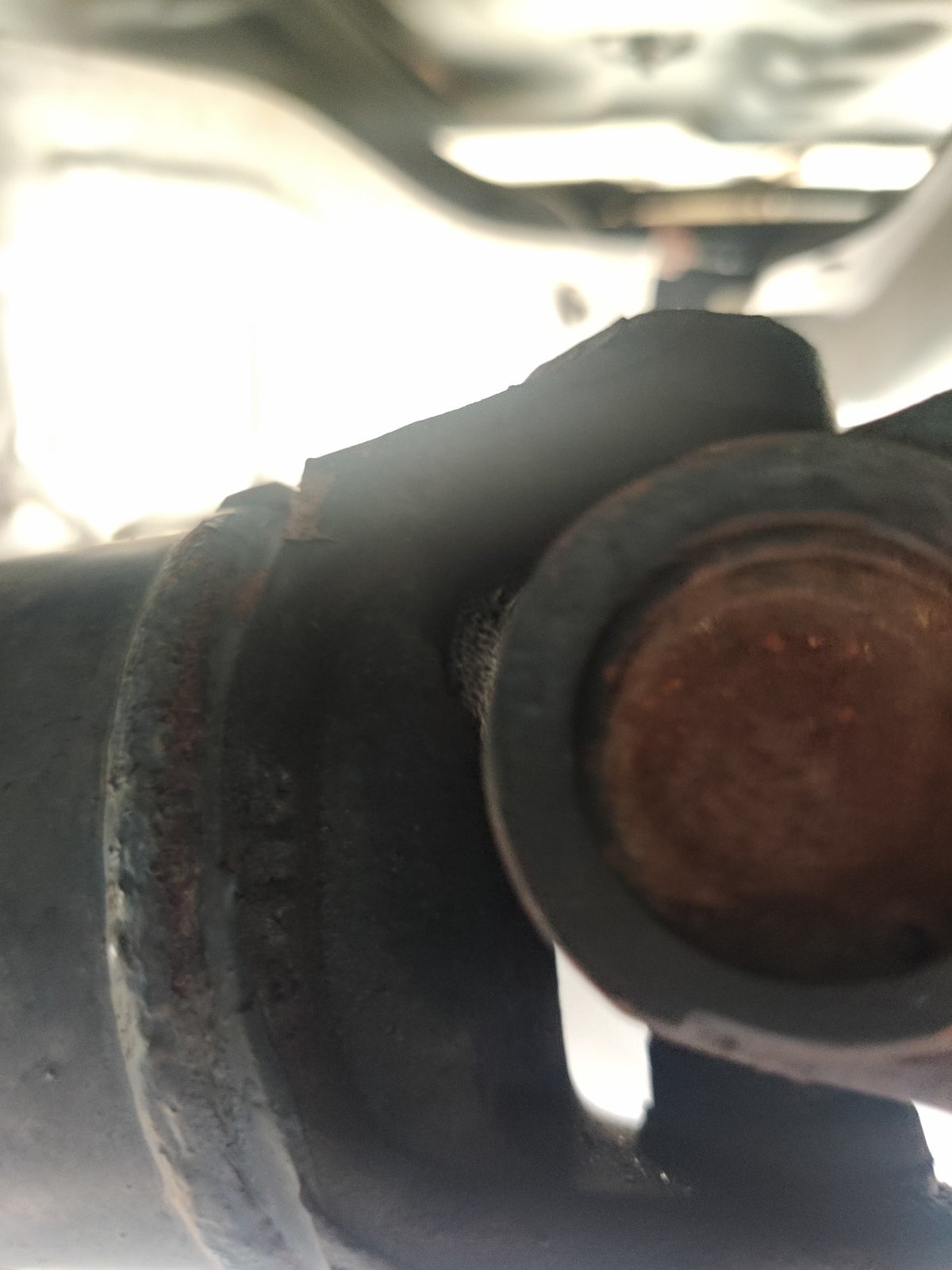

    Just to show all four caps

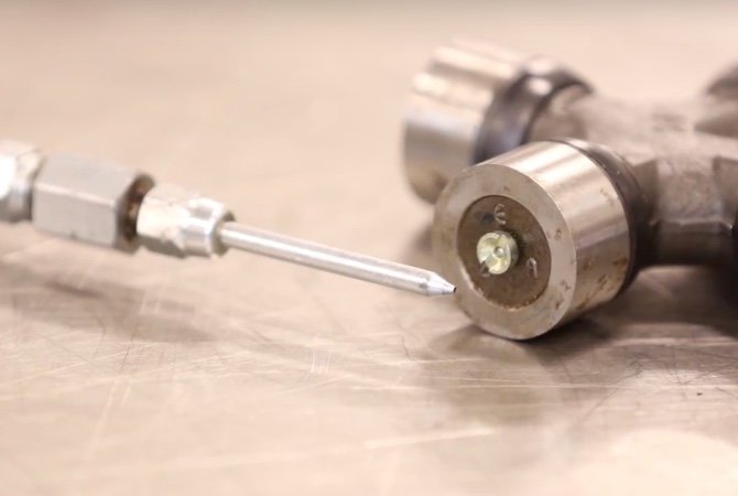

    That u-joint has a grease fitting, it uses a flush type adapter.
