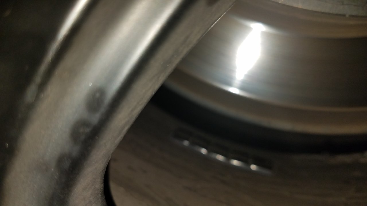

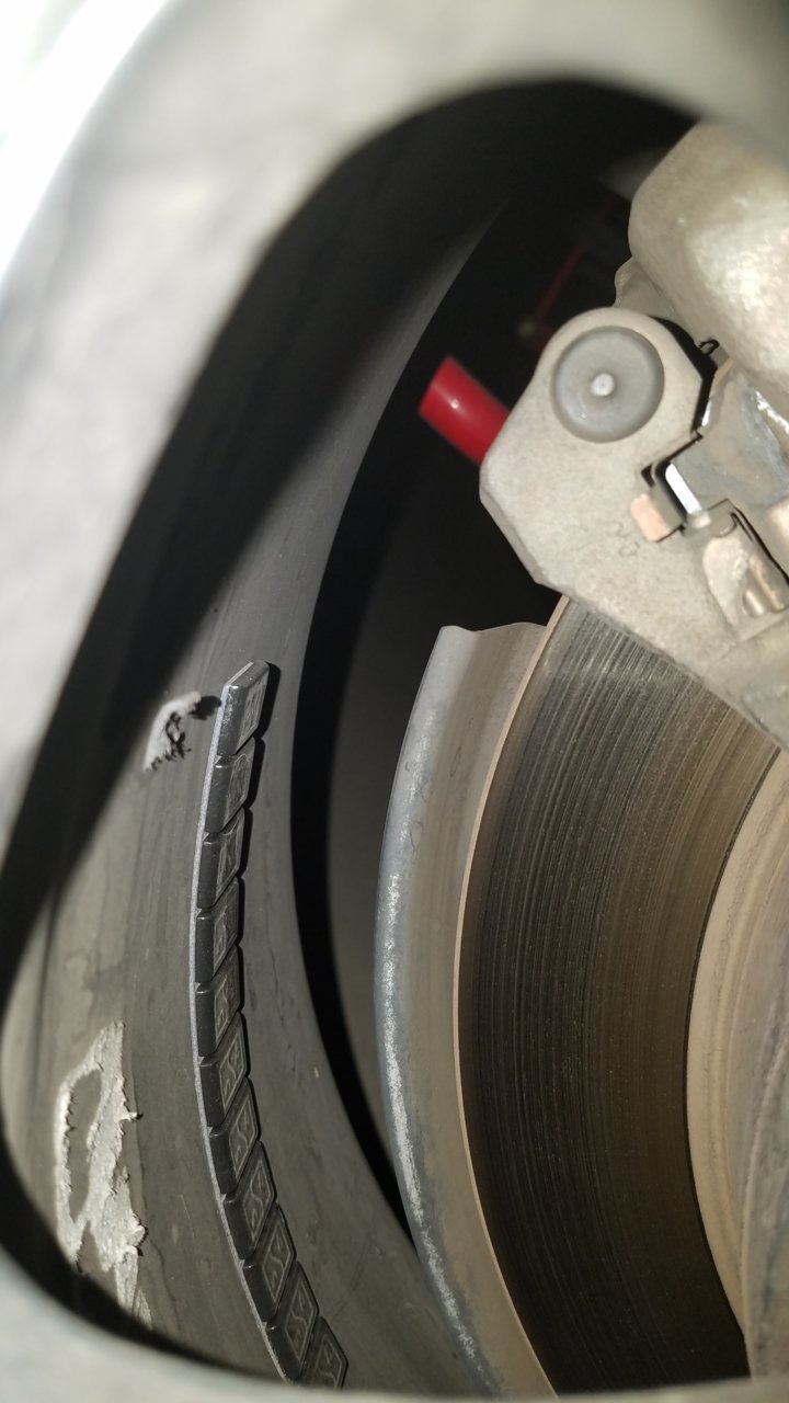

    Yes, dynamic will be a better balance. One of the pictures you posted is hard to see but the other one looks like it is just static balanced.
    Typically an aftermarket wheel will not have a flange for weights on the outside. However you can do a dynamic balance with tape weights right behind the spokes and right next to the inside flange. That's how mine are balanced. That's the first step to eliminating any vibrations caused by incorrect balancing.

    When I had my Nitto Ridge Grapplers that's the way they were but when I went to the Michellin LTX at2 they started back to the single weights
