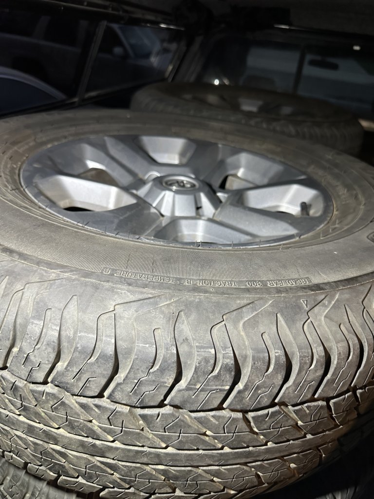

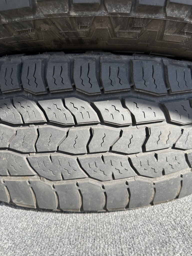

  8. May 8, 2025 at 8:48 PM
    #38
    Stock63
    Stock63 Clueless
    Jan 8, 2024
    #109885
    204
    2005 Tundra DC 4WD
    The front tires were definitely cupped closer to the middle of the vehicle, the front driver had an uneven wear like it was hopping. Truck drives way smoother now, I think it’s time for an alignment though. I swapped all wheels plus tires. Didn’t take them to a shop jet put them on my
  9. May 9, 2025 at 9:01 AM
    #39
    shifty`
    Jun 20, 2020
    #48239
    31,531
    ATL
    '06 AC Limited V8/4WD
    Yeah, that's some pretty wicked toe wear, and definitely cupped on the outer edge too. Notice in that outer edge that's worn smooth, on two of three middle lugs you can see the tread lines, but there are no tread lines visible elsewhere.
    You definitely need toe corrected. And
