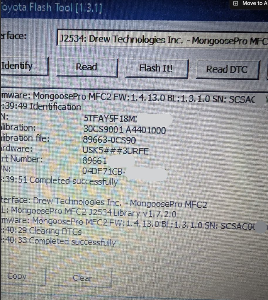

    now that tech stream is being phased out for GTS+, the VF Tuner cable won’t work well with GTS+. I gotta get one of those $500 mongoose cables
