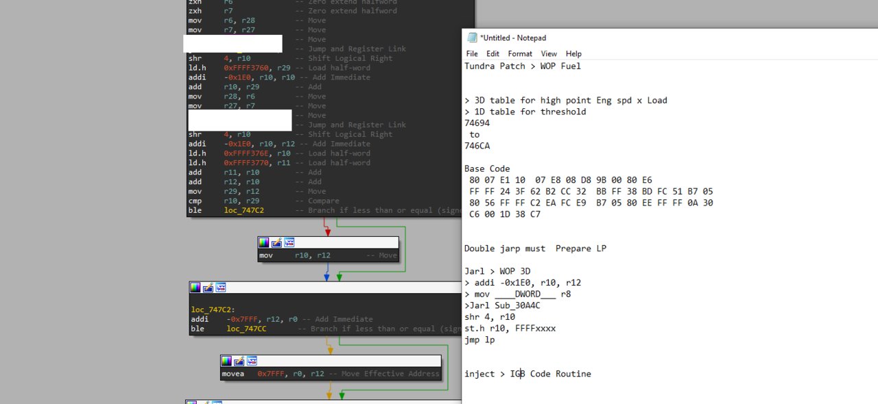

    Okay, I believe we have solved the flex fuel throttle loss issue on cold weather. It actually looks to be an error mis-match with injector scaling within Flex code.
    Not even related to throttle at all, and why it was so hard to find.
    Final thing being worked on before we can get everyone updated.
    A few of you have mentioned to us about supercharged trucks feeling "choppy" at lower rpm (around 1200 to 2000 rpm) moderate throttle. Especially the harrops.
    This is due to lack of fuel enrichments at these low rpm.
    So, a new way of controlling when fuel is to be enriched is being writ right now...in hex.
    (take a look at this pic, you'll understand why this takes so long!)
    should have it wrapped up by the end of the week.

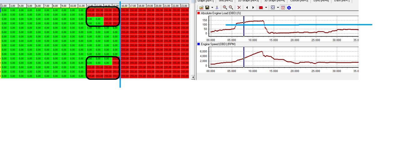

    yes, direct shift works issue free from the first implementation. so definitely still in it.
    here is our 3D fuel RPM v Load for SC trucks. (1 = fuel enrich ON)
    Testing tomorrow.
    This should be the end of code writing and then all in on updating everyone

    Yes I can change the shift point for any gear including 1rst.
    regarding the rpm v load fuel enrichment factor table
    You can see on the RIGHT > the blue line is 100% engine load, and the ECU normally enriches only above 70+% throttle open, which means load of 110-120%
    At moderate throttle, and low rpm (lets say 50%) you are still locked into 14.7 AFR, and you do not get enrichment at these loads (80,90%).
    This is causing the choppiness / sputtering / rough feeling on the Harrop.
    By altering it with 3D mapping, the areas in black are enrichments under 100% load so that the ECU will give this needed additional fuel.
    blue line is @100% load.
    I'm testing this today, hopefully it all goes smooth and we have this ready for S/C folks along with all other features.
