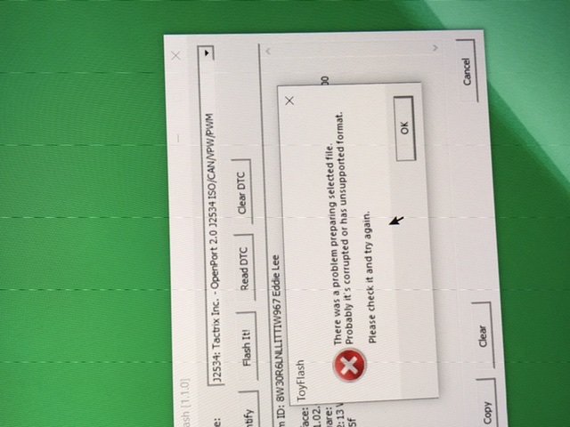

    Got my base tune but, can’t flash it for some reason. Keep getting this message, please help!!

    Have you deleted the file and tried to download it again? You may (although I've never had to) need to disable your antivirus software while doing so.

    In the email I got from Mat today he said to use the updated flashing program. It was in the email as one of the attachments. I got that same message until I deleted the old P5 and used the new one.

    All done! Thanks for pointing this out, exactly what was wrong.

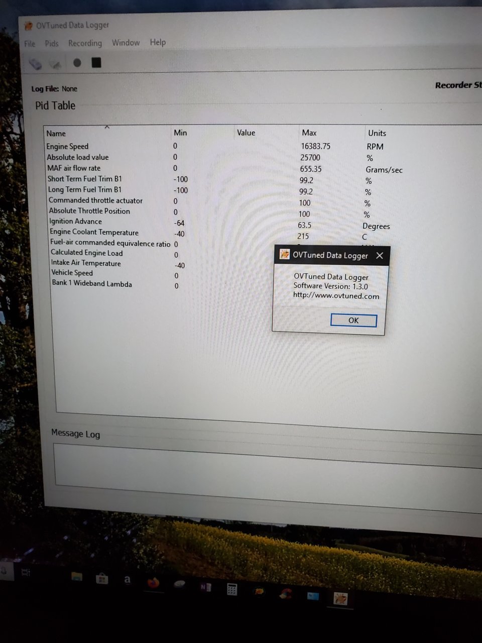

    Maybe a stupid question, can someone please show me how to data log?:oops:

    Charge your laptop, take to Truck, plug in OBD to laptop. Warm up truck. Hit Record or the red dot in the program. Start driving in town stop and go, normal driving. Stop recording. Then go to a county road. Hit record again, mash it and get up to 6500 rpm going through all the gears. I did this three times. Stop recording.
    take laptop inside. Within program you'll see FILE - OPEN LOG DIRECTORY. Within are 2 . csv files. Mail these to OV Tunes Zendesk with your order number. Don't expect a short turnaround for the return modded tune. (Anyone correct me if I missed anything)

    i went a few miles normal driving. Floored it 3 times for the second file

    Are you referring to another program that I need for logging? Cause I can’t find the record button or the red dot in toyflash.

    This is my version. 1.3.0.
    the record button turns red when you plug into vehicle with the cable.
