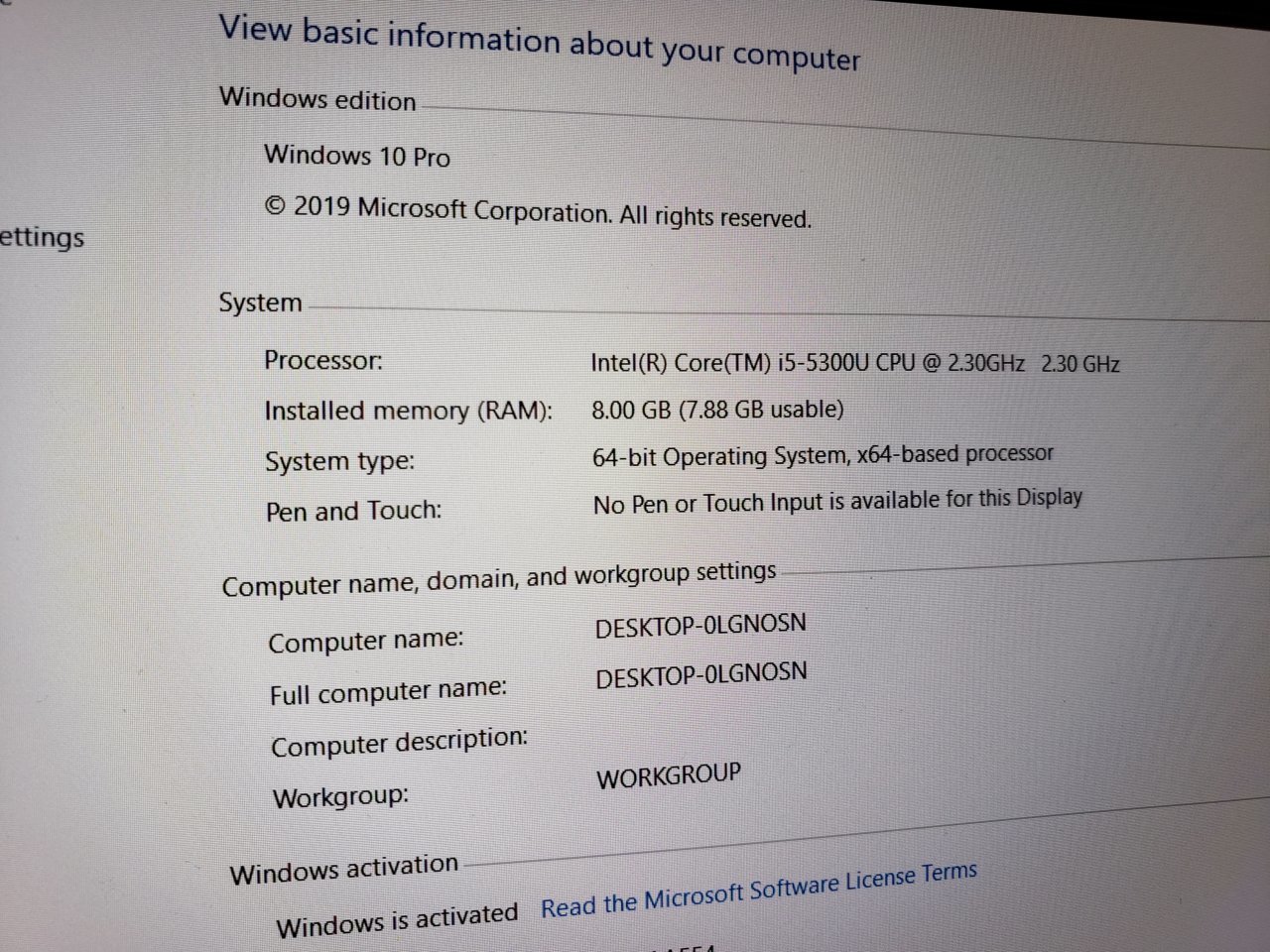

  28. Nov 20, 2019 at 6:50 AM
    #1978
    osidepunker
    osidepunker OsidePunker
    Oct 19, 2016
    #4918
    3,000
    Alex
    SoCal
    2013 Tundra DC 4x4
    Full LT, full armor, fully self contained Speed Glamper
    I will definitely report on MPG. I normally get 11mpg hwy haha If I can get even one more MGP that would make me happy LOL
    So I'm confused on the x64 thing. I thought I bought a normal 64 bit laptop. Here is what windows says I have:
