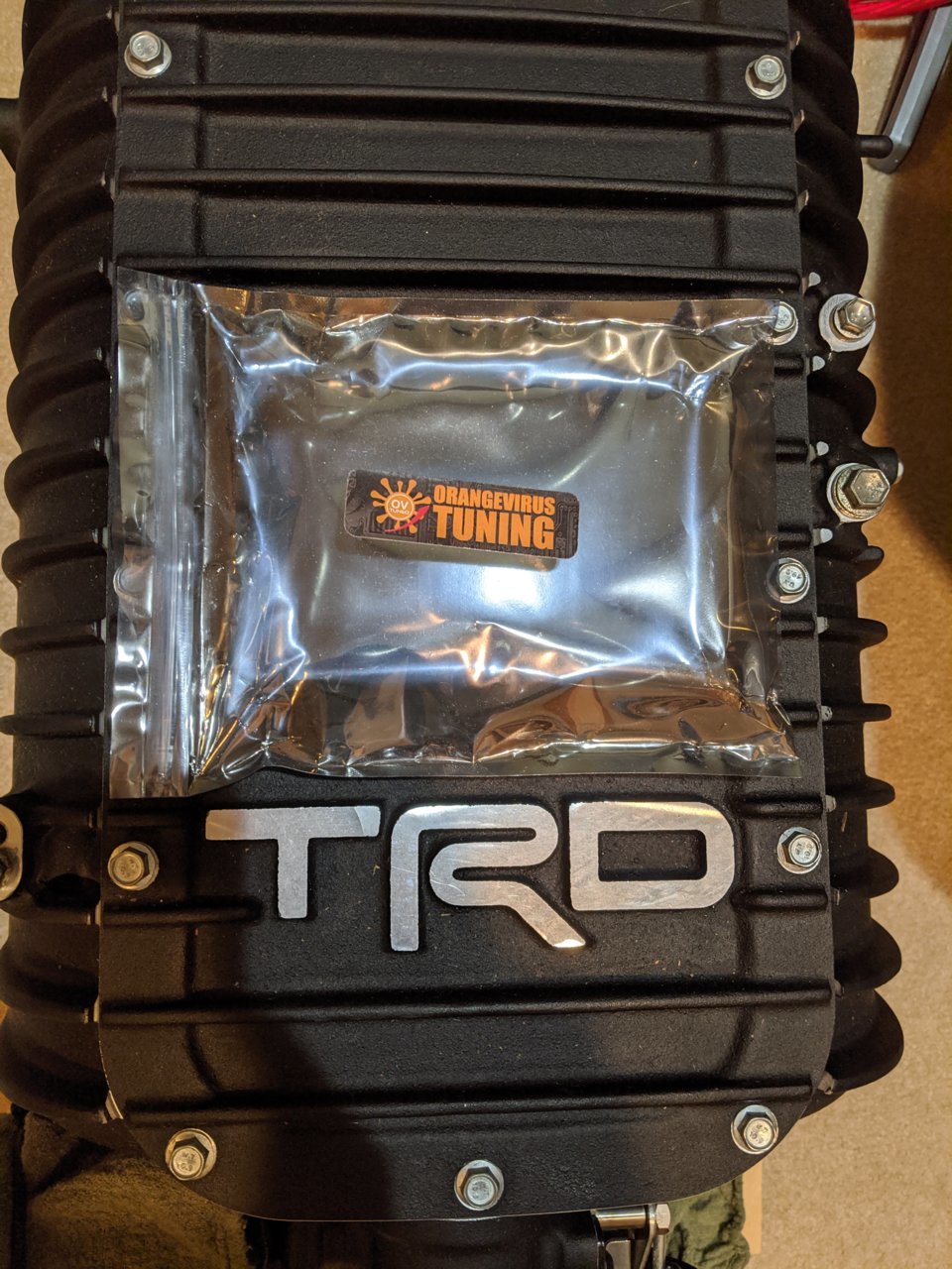

  15. Sep 29, 2019 at 9:36 AM
    #1245
    Wynnded
    Wynnded What MPG...
    #379
    5,708
    Rockies
    Souped up truck
    Project...
    AZTundra, Vr0ck, Stroke250 and 5 others like this.

  19. Sep 29, 2019 at 11:53 AM
    #1249
    Wynnded
    Wynnded What MPG...
    #379
    5,708
    Rockies
    Souped up truck
    Yes, yes I did. Waiting on a couple more hard parts though (dealer snafu in the shipping department). @OVTune (thanks man!) emailed me the base tune for it this morning, so when the planets align I can get everything installed in one fell swoop. Effing jazzed:headbang:, I wish that some days had a fast forward button...:pout:
  20. Sep 29, 2019 at 11:57 AM
    #1250
    roy2015
    roy2015 Waterproof
    Aug 18, 2019
    #34811
    178
    Houston
    Super White = Super Fast
    @Wynnded STOKED FOR YOU BRO!!!
    You mentioned dealer, but that's an older TRD supercharger . . . ? What's the story behind it? You planning to install yourself?
    TruckyTruck and Wynnded like this.
  21. Sep 29, 2019 at 12:12 PM
    #1251
    Wynnded
    Wynnded What MPG...
    #379
    5,708
    Rockies
    Souped up truck
    It was a CraigsList find, removed from a hail damage totaled '15. There probably were still some TRD units available then, I don't recall. The fella I bought it from paid a dealer to have it removed from the totaled truck and he was sitting on it with plans to purchase a Tundra and have it installed on that truck. Has but 6k miles on it, the paint isn't even worn from the idler pulley. The fit-kits aren't the same for all model years, there are some differences between the 2nd and 3rd Gens and the engine oil cooler lines were missing. Not all models have these lines, it may only be the ones equipped with the Tow Package, which mine has, so I ordered the hose and clamp kit from a dealer and there was a miscommunication and a resulting delay in my receipt of those parts, otherwise I would've been wrenching on it yesterday and probably driving it today with the calibration that was emailed to me this morning. I'm a little bit ahead of the game though, I've already changed the spark plugs, fuel pump, and mounted the Low Temperature Radiator.
    ZPMAN, AZTundra, MrMax and 3 others like this.
