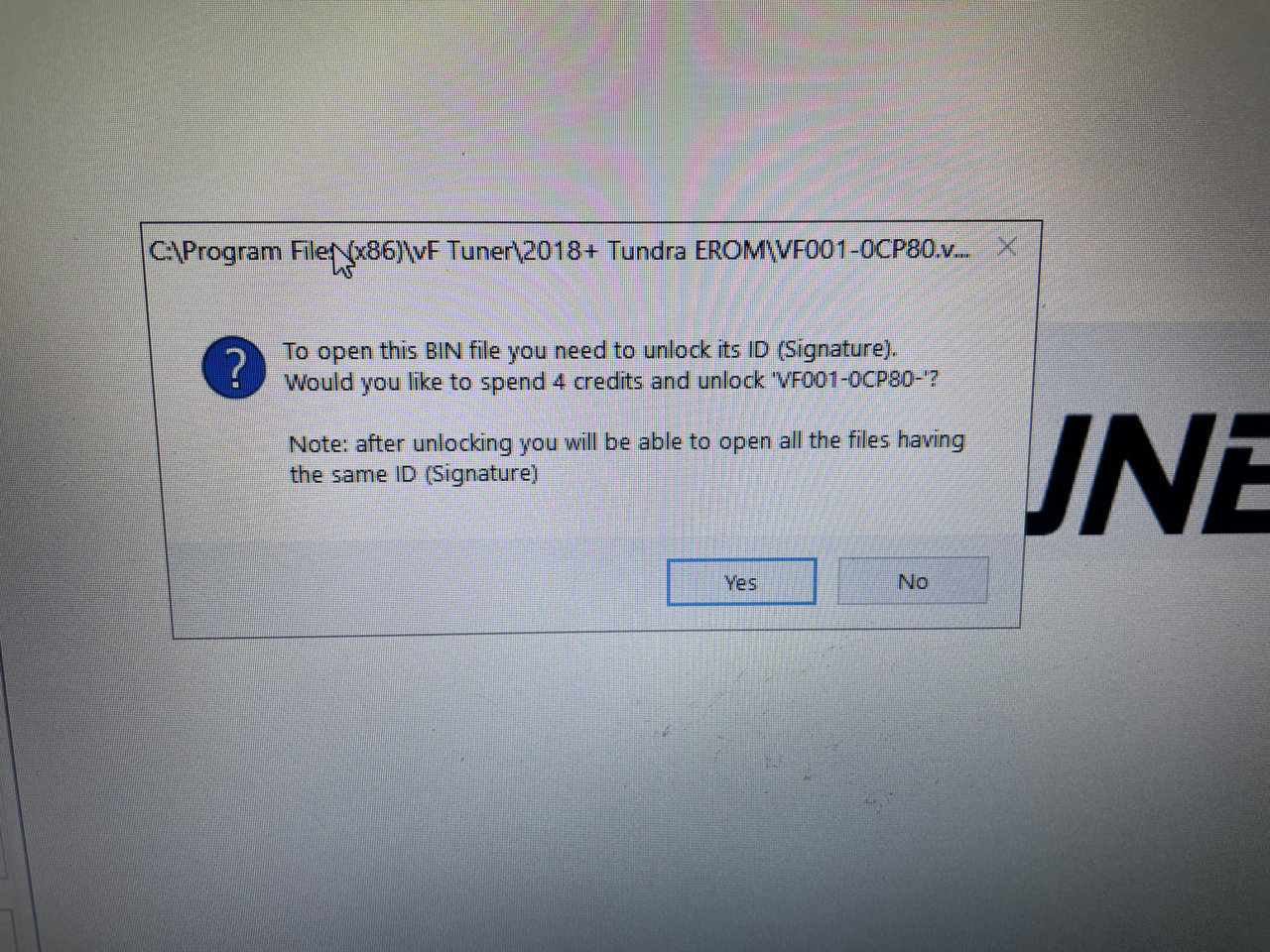

    When you open vFTuner, then Help > License Information, does the box on the right labeled Unlocked IDs have anything listed, like 89663-0CP80-?
    You should also have at least one credit in the Credits box on the left.
  8. May 17, 2021 at 7:28 PM

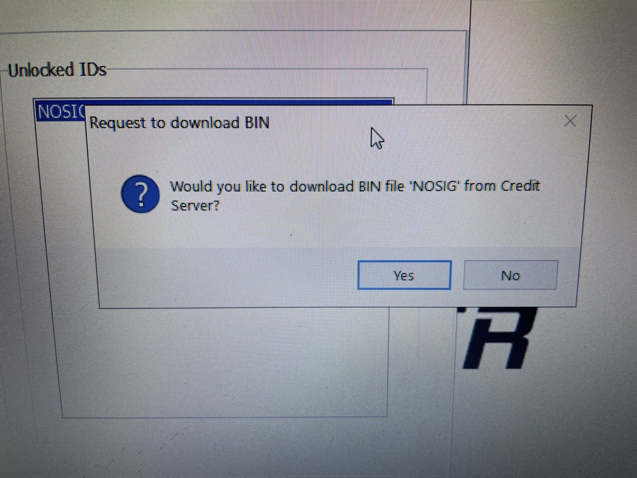

    looking at it now your right there is one credit.. but it says it need four to open..
    Nothing in Unlocked IDs? Everynow an then I will see NOSIG sometimes show up and disappear.

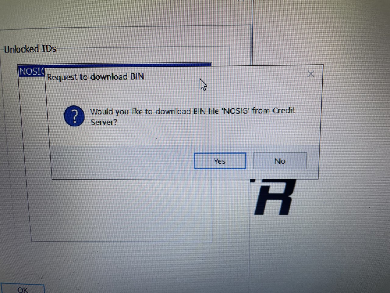

    Whats does mean?image.jpg Im just needing some assistance on properly getting this configured right..as of right now Im unable to more forward at the moment with all this.

    One credit is normal, it will always be there. Do you recall how many credits you had at the very beginning? There should've been nine. Four are used to "register" and get the ball rolling, and then four more are used to unlock each ECU ID (which will remain unlocked forever) leaving one credit. I appears that you're trying to flash a file from a Tune Pack, and I haven't dabbled with those yet as I haven't received mine. I suggest that you reply to Mat at his support email, that way it will include your Order Number and any relevant information about you so that he can look into what's going on. Also, start reading things over at his forum, Forums - vF Tuner Forums

    NOSIG means you haven't unlocked any actual file(s). No reason try to download.

    You don't need credits to go back to stock and it's not credits per file it's per UNIQUE ECU ID. Hop on our forum there is tons of info on how to do / use / everything
