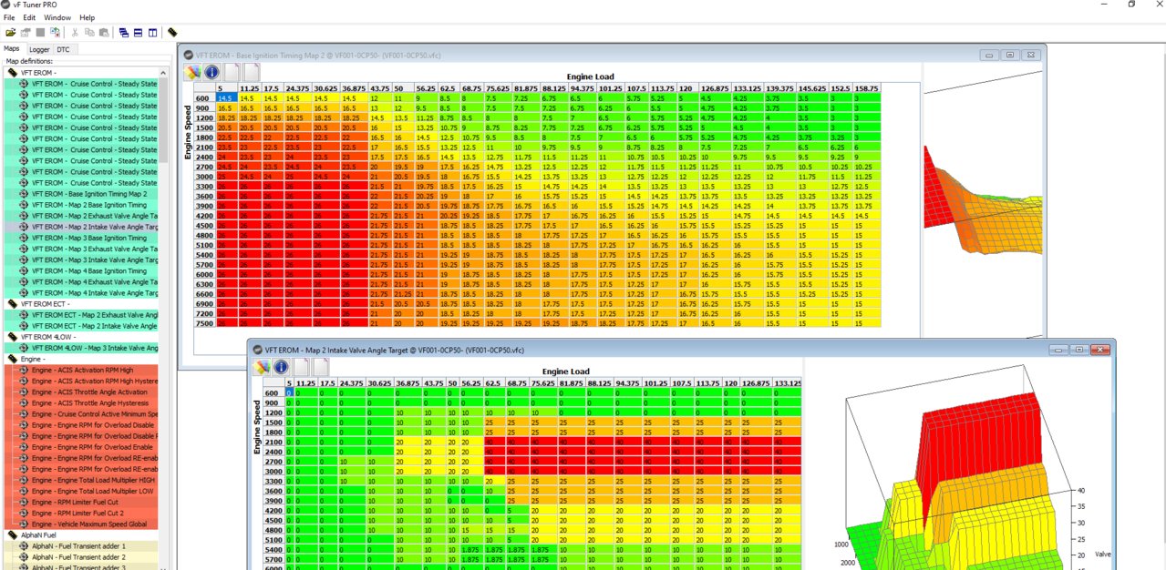

    I open two calibrations in one instance and can compare each map directly next to each other in the same right-hand window of the app.

    I've opened up 2 files simultaneously on vF tuner--base tune and the 91-GL, just to see the differences on the tables. You can arrange the tables side by side or top to bottom to compare values on rows and columns.
    If you can hook up a bigger and wider screen on the laptop, the better.

    Yep, same here.

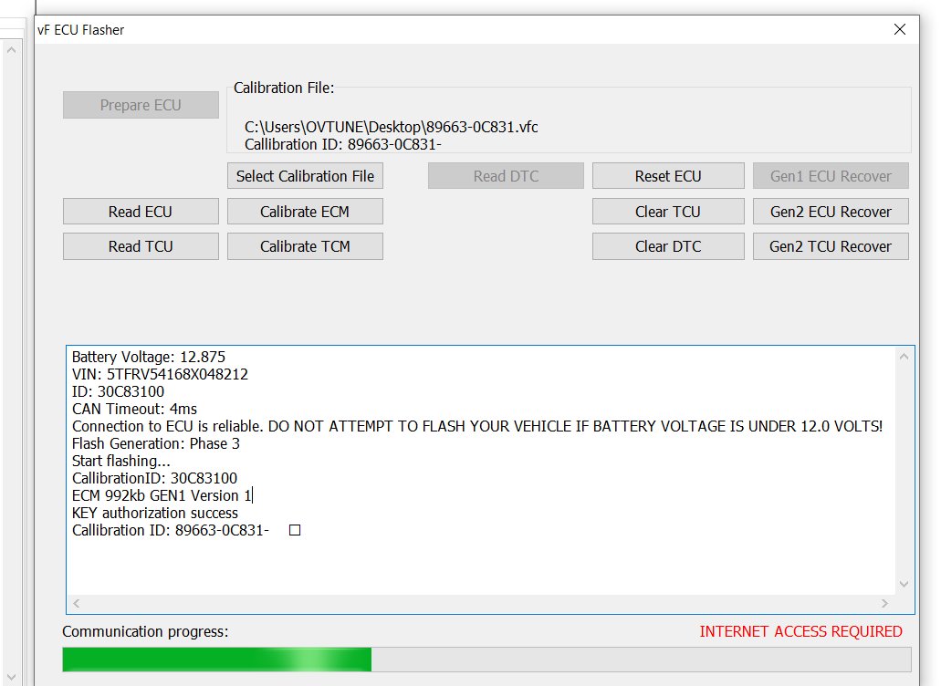

    Flash issue is fully resolved and will be ready in this upcoming update.
    Made sure to test it myself with an 07 ECU, as old as it gets

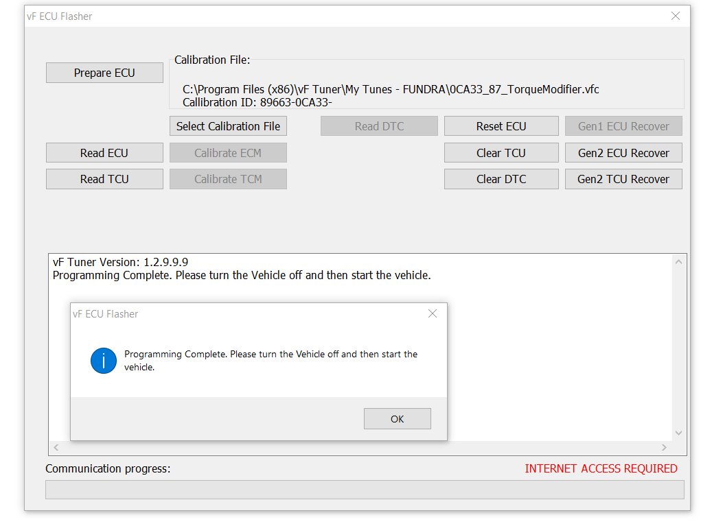

    No more errors on flashing!!! Thank You.

    @OVTune :thumbsup: Flashed from .P5F to .VFC. Nooo problem. It was a little disconcerting when the ECU Flasher window disappeared though. Clicking the Minimize button on VF Tuner brought it back though. I don't know if that's normal (read only one comment about it) or if I accidentally touched the laptop touchpad.

    awesome!
    yep I am aware it happens on some PCs. If you just click anywhere it comes right back.
    That means I was wrong I thought your issue was different. Glad it's working!
