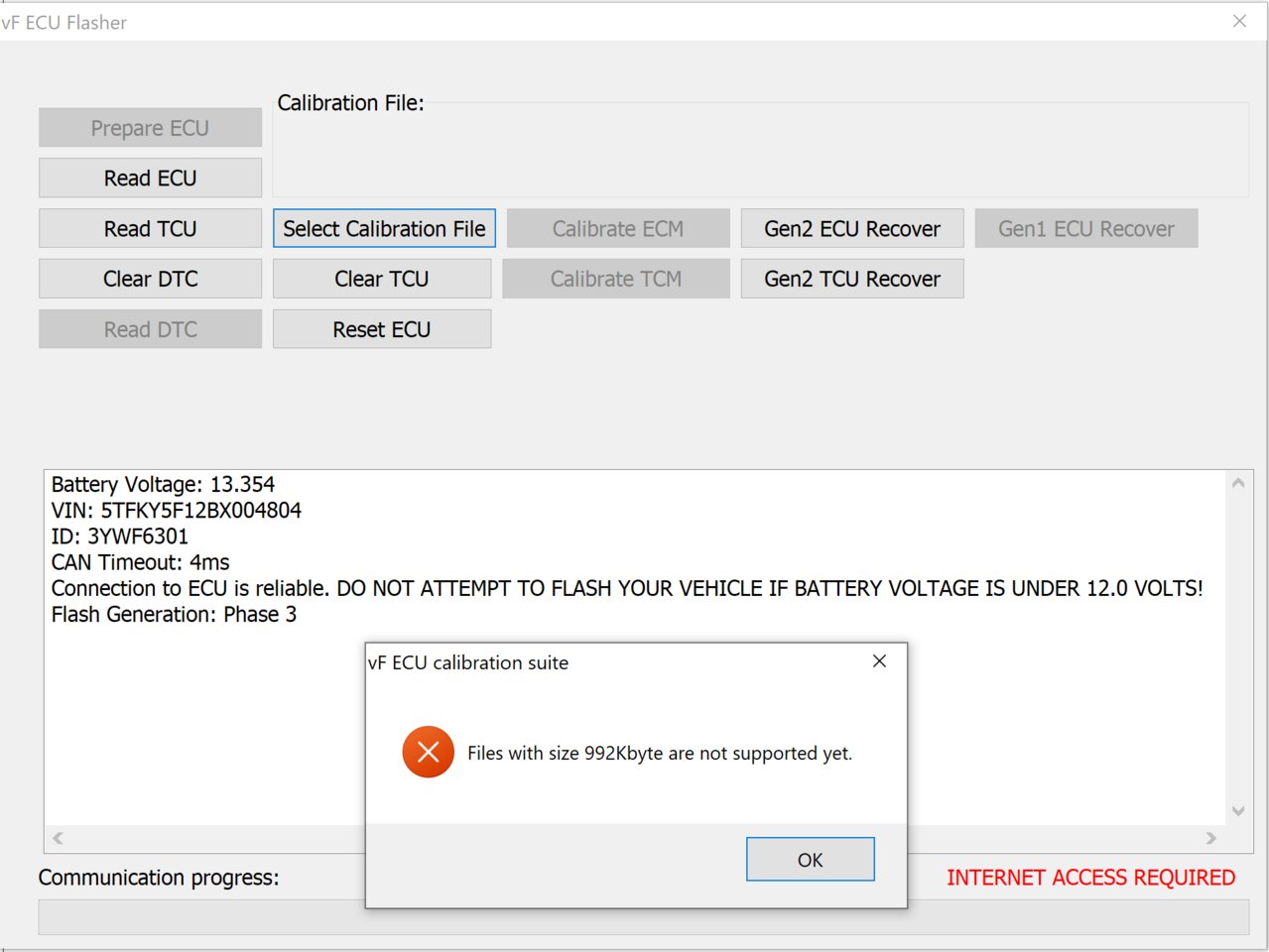

    But there happens to be this.

    did you select a VFC file? I'm not sure how that's even possible! let me check this right now

    Ya, I've been breaking a lot of rules. :oops:
    I tried a .vfc and a .vft file.

    1.2.9.9.8 fixes this

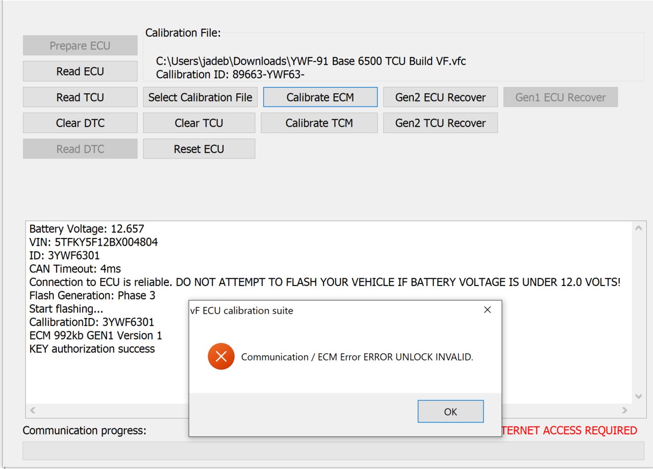

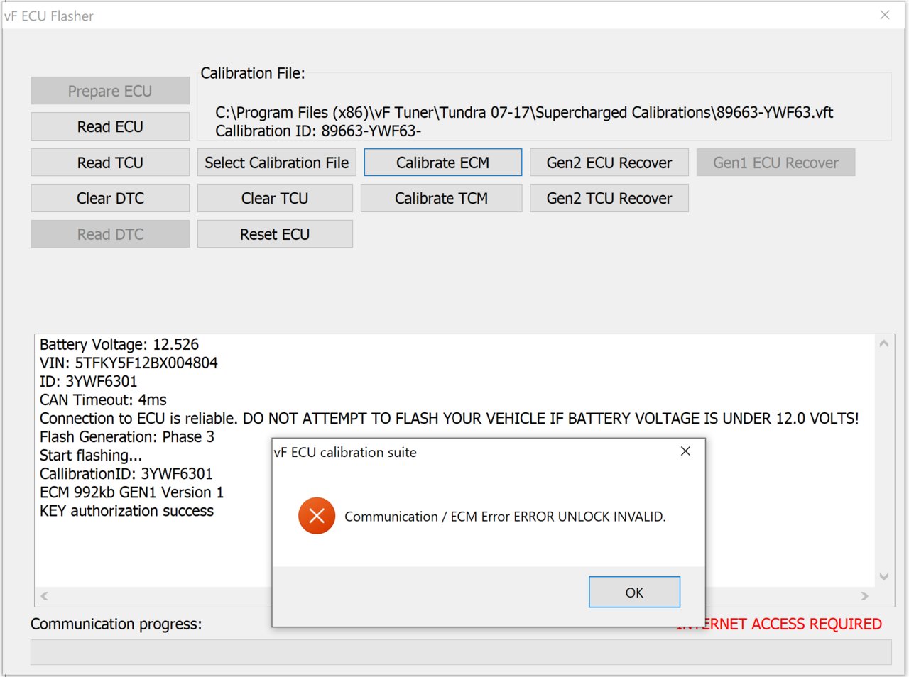

    But now we're here again, at least with my particular ECU...
    Tried .vfc and .vft

    Yep your ECU is a special case situtation I need to send you a different file to flash

    I have the same error code. I also had the file size error code but that one is already fixed with the latest vF tuner version.

    Peculiar, I wonder if it's particular to the first generation of ECUs for the 3UR...
