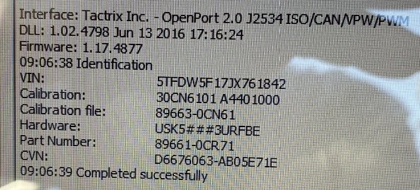

  22. Aug 29, 2020 at 5:48 AM
    #4372
    DanoDavis
    DanoDavis New Member
    Jul 9, 2020
    #49062
    24
    Dallas
    2018 White Tundra -5.7 -4x4 -TRD Sport - Leather
    Shell - OV Tune
    I’m not 100% sure which ECU I have, here’s the screenshot.
    (I’m assuming 0CR71)
    Any idea how far along the line you are with this model?
    #6841
    thanks!

    OVTune
    OVTune [OP] New Member
    Apr 25, 2019
    #29624
    982
    Mat
    2016 FFV CM
    OVTune RD Vehicle
    your ECU is 89663-0CN61, same as the guy requesting a few posts up
