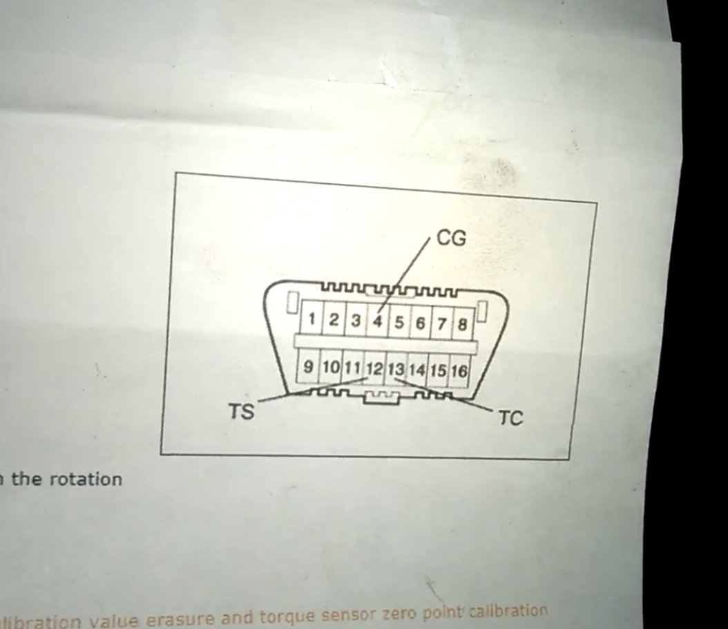

    this is what worked on my 19
    Jump Pins 4 & 13. Turn key to on for 20 minutes. Turn off. Truck should start.
    https://youtu.be/HQXgbSUQ0Yo

    that’s the thing with my 20, for pin 13 there is nothing there. Meaning there is not a wire on that pin. So if I jumped 4 and 13 as is then it would do nothing. Since I can’t get TIS to work I’m stuck since I can’t look up the diagrams.

    Are you sure you are looking at the connector the right way? If I remember right, in mine it’s upside down (rotated 180 from the picture). So 13 is actually the top row and 4 is the bottom row. And 14-16 are all blanks like you describe.
    so it’s the 4th pin from the left in the top row, then you go straight down and one to the right.

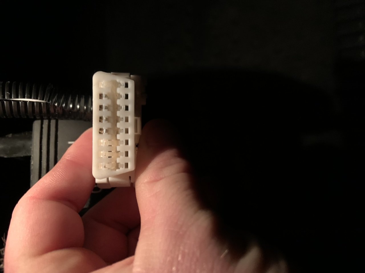

  6. Mar 24, 2020 at 3:31 AM
    #3096
    nlg4021
    nlg4021 New Member
    Sep 25, 2019
    #36600
    34
    Nick
    Ocean Springs, MS
    2020 Super White TRD Sport Tundra
    2" level, 34 Mickey Thompson ATZ, tint, Magnuson SC, pedal commander and katzkin leather
    this is my connector. Sorry for the picture quality.

  8. Mar 24, 2020 at 7:02 AM
    #3098
    PeakIT
    PeakIT Old Member
    Sep 18, 2019
    #36326
    244
    Utah
    2019 OR Tundra Double cab
    Coachbuilder 3” shackles, King extended travel, SPC upper arms, 5:29 gears, FN FX rims,35"tires, leer shell, grill
    if you can get the wiring diagram you should be able to do it at the ECU as well if they don't run it up to the OBD connector any more.

    That’s super weird. Yeah that’s definitely different.

    I finally got access and that terminal is gone on the 2020. So you can force it through techstream but when I try to connect to the ecu @OVTune sent me it will not connect to it in techstream. I get communication errors.
