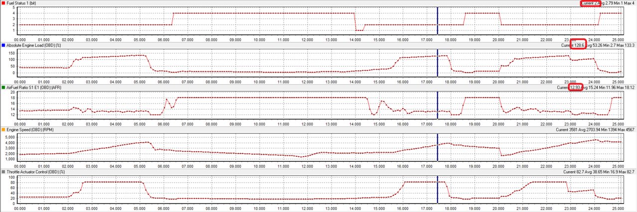

    I'm speculating that being locked @14.7 AFR in that scenario would also result in elevating EGTs over time (under those specific conditions only, not the life of the engine). Not desirable.
  6. Mar 10, 2020 at 10:03 AM
    #2976
    OVTune
    OVTune [OP] New Member
    Apr 25, 2019
    #29624
    982
    Mat
    2016 FFV CM
    OVTune RD Vehicle
    Yes being locked at 14.7 until you reach whatever commanded throttle % allows enrichment not only makes the truck respond worse in part throttle situations, but at the lower end of the rpm, 2000 and below, you can definitely feel that it is unstable.
    This is especially an issue on the Harrops where there is considerably more air being moved even at these lower throttles.
    So at 50% throttle, the ECU is not allowing ANY enrichment, and the truck is constantly bouncing back from leaning out. It will enrich only back to 14.7, > lean out > go back to 14.7 > lean out. This creates that choppy, unstable, and sputtering feeling. This happens whenever there is a change in throttle position that remains under the commanded throttle % to enrich.
    Instead now it will activate based on RPM and engine load. The Engine can achieve 100%+ engine load at relatively low throttle % at low rpm. But it's NOT fueling for it (in the stock code). In our code, it will fuel for it as soon as any engine load is achieved at whatever the 3D map is tuned for, regardless of throttle position.
    (engine load is calculated by air, so it makes sense to enrich based on air demand NOT throttle position!)

    My AFR need work with this new patch but..
    patch is in action > Closed loop feedback control with target richer AFR regardless of throttle position, instead RPM vs Load
