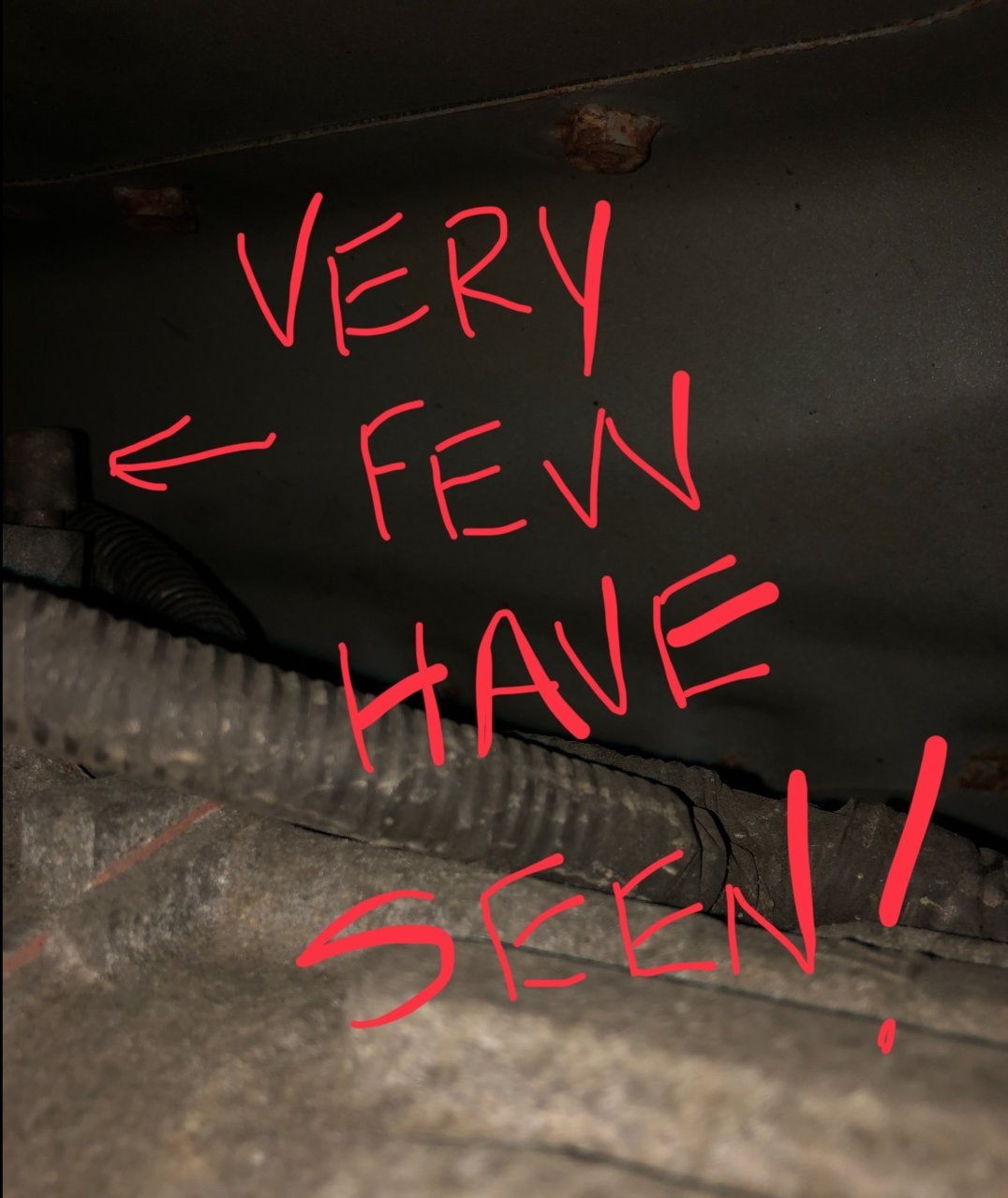

    There is another (transfer case?) breather directly on top of the transfer case. Its screwed right into the top. You’ll need gorilla arms to reach it and spin it. It feels spring loaded and the action was bouncy so I feel its good to go. Not sure how one would replace it, unless the trans is dropped.

    The one next to the your shiny one goes to the front diff ADD actuator. Are you sure it's two way? Mine holds a vacuum, but it is pretty crusty. When I yanked on it, it let a bit of air in, but just the one time.
    Both of the front diff breathers (that terminate below the fuse box) can be extended from behind the driver shock mount where they connect to hard lines. It's a lot easier with the upper control arm taken out. The small hose is 4mm.
    Regarding your last picture, do you have the push button 4wd? And what side is that picture taken from? It seems like mine just has a hose that runs from the passenger side of the transfer case cover (where the shifter would go) and runs a few inches forward to between the transmission and the transfer case. The transfer case actuator hose goes to the same general area, just on the other side. Post #7 on says that dead space is where the transfer case vents in Tacomas and 4Runners so it makes sense. But I'm not sure how that area vents.. Is it through the transmission breather in the bell housing?

    The one you are saying goes to the front ADD actuator: I wasn’t sure where it went which is why I put a question mark. I did remove it and its a skinny posted plastic type breather. I cleaned it and tested it both ways using lung power. Seemed good to go.
    Yes on the push button 4WD. That picture was taken while laying under the truck at its midpoint with my arm extended up between the muffler and transfer. I had to use Crane Technique with the phone in my hand while snapping the picture by feel one handed. Not much room up there between the top of transfer and bottom of cab. Or maybe this is the back end of the transmission case area?

    Thanks for this link to this photo. I circled in red the breather that ‘few have seen!’.
    I often wondered, with all the paranoia about breather extensions in the 4WD community, why nobody talked about this one. Seems very vulnerable in water crossings.
