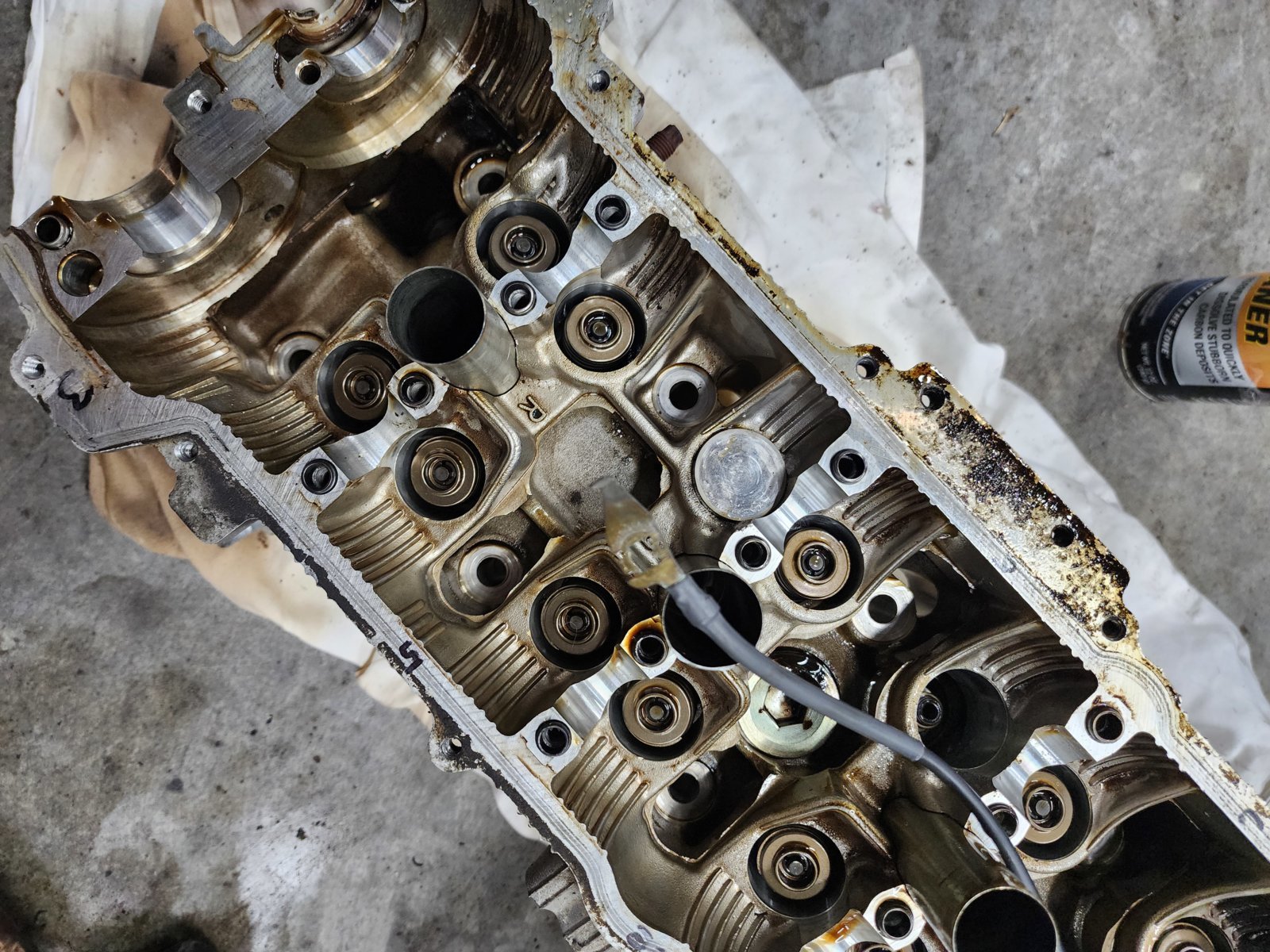

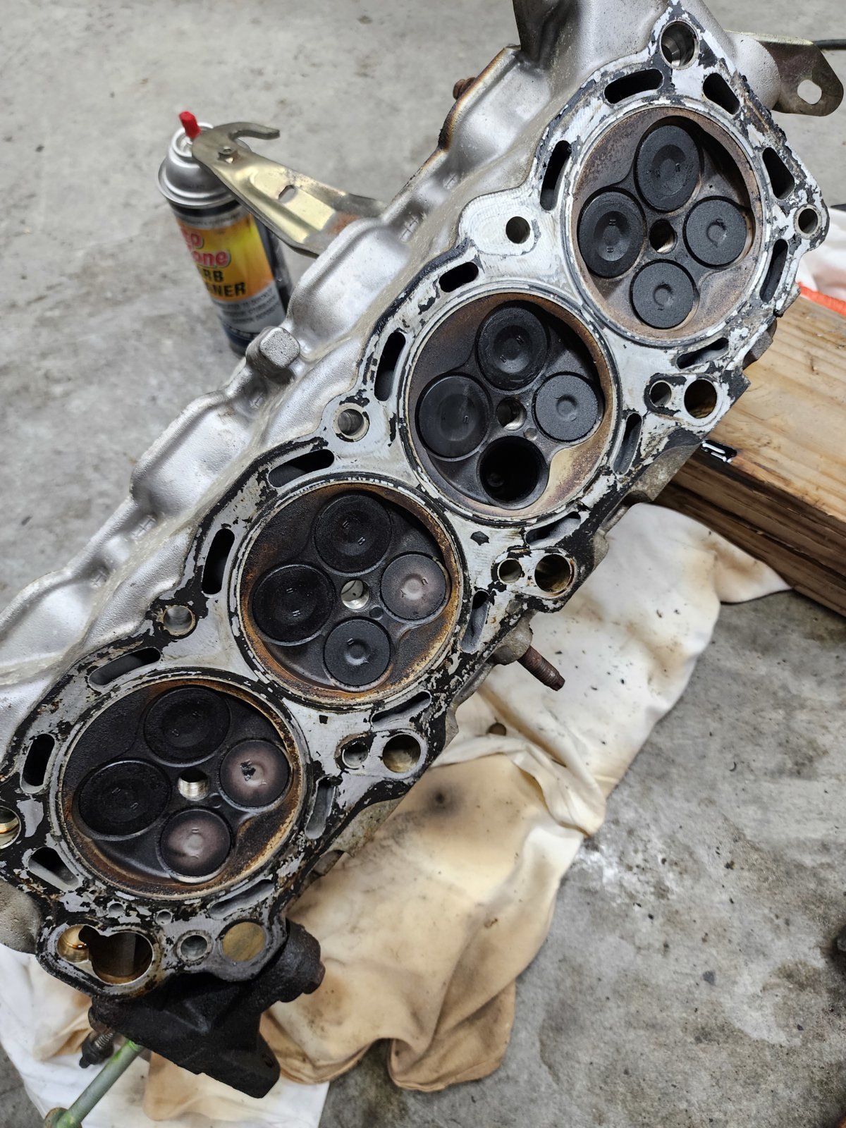

    I will try to attach photos for reference. I've removed the valve that lost the keepers. One of the buckets won't come out though. I'm thinking one of the keepers found it's way under that bucket and damaged it. They are a close fit, but all the others came out easily.
    Anyone seen this kind of issue?

    You can use a long punch slightly smaller in diameter than the guide and gently drift out the bucket. Condition of this particular exhaust valve system will be critical to being able to use this head again. The fact that the bucket does not simply lift out is definitely of some concern. Let us know what you find out.
    Dan
    Edit: Looking at the pictures again the valve with the stuck bucket isn't the valve that lost the keepers is it? So the stuck bucket is over another exhaust valve?

    Yes, the stuck bucket is over another valve. The valve spring of the bent valve is intact, as is the retainer, shim, and bucket... just no keepers.

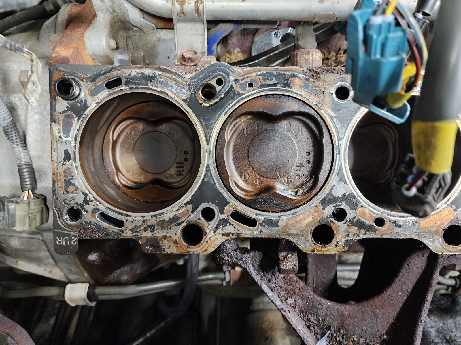

    Yikes. I'm not sure what your options are in attempting to remove the stuck bucket. Outside of a super-strong magnet or some sort of industrial strength suction cup, I'm not aure how one could approach this. But the reason it is stuck obviously needs to be fully investigated as to cause.
    Also, the ding on top of the piston that got hit by the exhaust valve does not appear to have twisted the con-rod (which often happens). My guess is there is no need to pull the pan and remove that piston assembly for inspection, but that is just a guess on my part.

    Drill thé bucket. Slide hammer it out.

    If you have a welder available you can just tack a nut on the bucket to pull her out.

    They are hardened, I doubt any drill would touch it.

    Yes I know, not easily at least. That's one reason I suggested welding a nut on it. That said, tapping it down a few times might also get it free.
