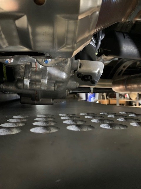

    So I was unloading the bare steel that was going to be shipped and I wanted to see how the new Z brackets turned out, well, there was a communication mistake between the plasma cutter and I and they were bent wrong. I am trying to get this fixed ASAP.

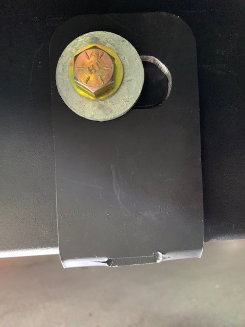

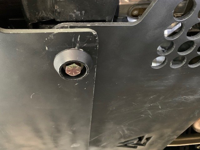

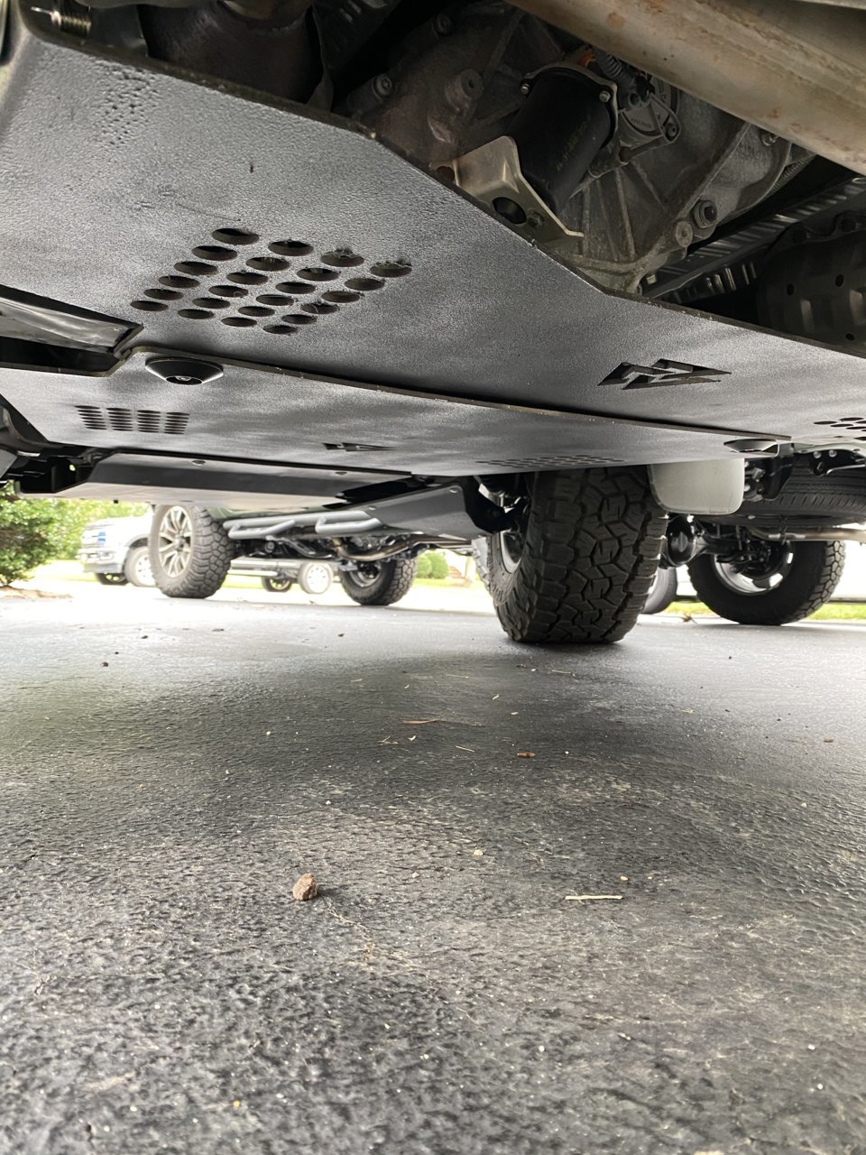

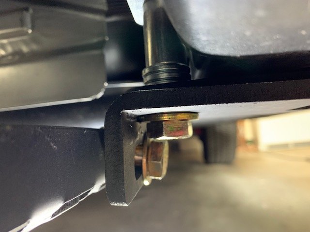

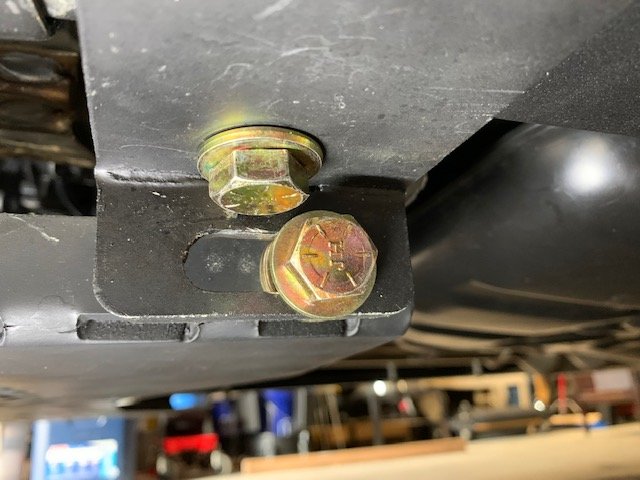

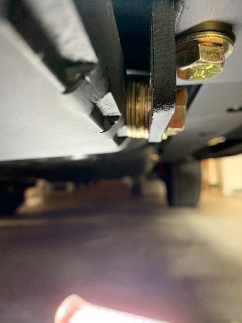

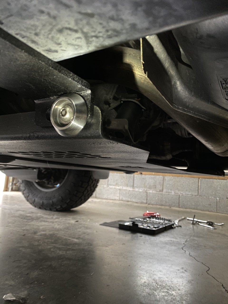

    The final chapter - I took Friday off to install the rear plate on the truck. My original plan was to fabricate a new bracket for the rear plate (replacing the Z-bracket) but after drilling out the first bolt slot hole, I realized there would be more dry fitting than I wanted to do, so I moved back to Tyler's original Z-bracket.
    So, I ended up drilling an extra hole in the Z-bracket because of my Cali-Raised rock sliders (which I think makes the Z-bracket tough as shit now. All fastener hardware were upgraded to 1/2" Grade 8.
    Here shows the Barnes bolt head protector between middle and rear plate - 1/2" bolt here upgraded.
    I had to heighten the top Z-bracket hole to accommodate the sliders - I just used a larger washer to secure it.
    Here's where I drilled the new hole in the Z-bracket - I believe it makes the bracket more robust.
    The bolt from the Z-bracket to the rear plate did need some washers as spacers.
    Overall, I installed the 1/4" square spacers on each side of the new 1/2" bolts installed between the middle and rear plates because when dry fitting, the Z-bracket on top of the slider steel created a little extra fractional amount toward the ground and the spacing from transfer case to rear plate was perfect.
    This is a great product - good innovative spirit from @Classy63 taking good and bad commentary to make his design better. Anyone who doesn't think the same...well, that's what is great about America, you can spend your money wherever you wish. I'm glad I spend mine here and appreciate everyone who provided insight on the install it was good stuff!

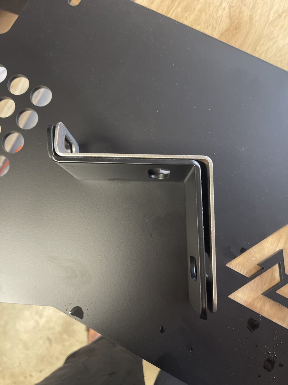

    Thank you for the honest review. I don’t get better by churning out the same product, I get better by learning. So, I had a thought, this massive amount of Z brackets I have now are actually a 1/4” long in the way you are having to space your plate. They would fit your slider perfectly if you would like to go that route.
    Attached is a picture of the aluminum Z brackets in black from the last order that fit well to the rear cat plate but still needed the spacer for proper distance from the transfer case. The steel one along side it is exact in every way expect it is longer by a 1/4”. For normal applications, this would mean overlap and difficulty installing, which is why I am getting the remade. BUT for you it would mean a Z bracket the same as you have but would fit to the edges of your rear cat plate without spacers

    The new Z bracket fixed the spacing problem with the short rear plate. Mounted them today and was able to get rid of all the washers used for spacing.

    Tyler, I appreciate it but I'll stick to what I have...the new hole is drilled and I don't mind the additional washers used as spacers. If someone can get under there and remove all that shit, then maybe they deserve to saw them off. I'll hit it with a little matte black paint like I used on the plates and a person will never know the difference.
    Some of these folks (which I've seen in comments) do not get what you are doing - trying to make something fit every situation without modification. It's damn hard to do...and I've worked in one company (Big Ass Fans) where innovation was the lifeblood of the company. Was every idea perfect or marketed...absolutely not, but I helped grow the company from $30 million to $270 million in sales and fully believe in the innovative spirit. It takes a lot of guts to start something not knowing how it will do...so hat is off to you!
