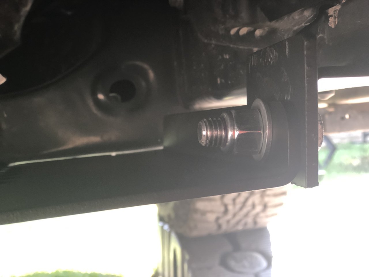

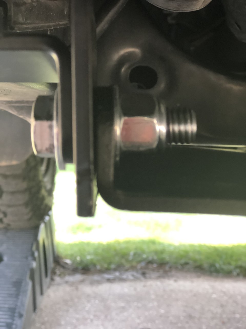

    Hey Everyone, my mechanic just mounted my shield using everything Tyler sends but did it with just slight modification that all you with a stock Tundra might like. So you get four square spacers and mine only needed one to make the front plate flush. So my mechanic used two of the spacers in between the back mounts instead of a washer. He cut off the part of the spacer so the skid and mount were flush. There is also enough space that we did not remove the transfer factory guard. I also used three 4 inch long pieces of neoprene 1/4 inch thick tape between the plates. Cheers 88A7080B-638F-4811-A6F6-B48F72CB1AD6.jpgB02C4FEC-23E3-425B-9650-7358ABC76E8C.jpgCDC0705C-B529-4D31-BFD7-C2942B0E8674.jpg

    So my most recent modification to the Z bracket also adds more room to clear the transfer case that may allow keeping the factory plate on there

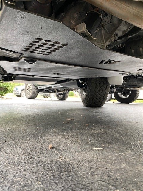

    FRAC harness / camera & Full set of Valhalla plates

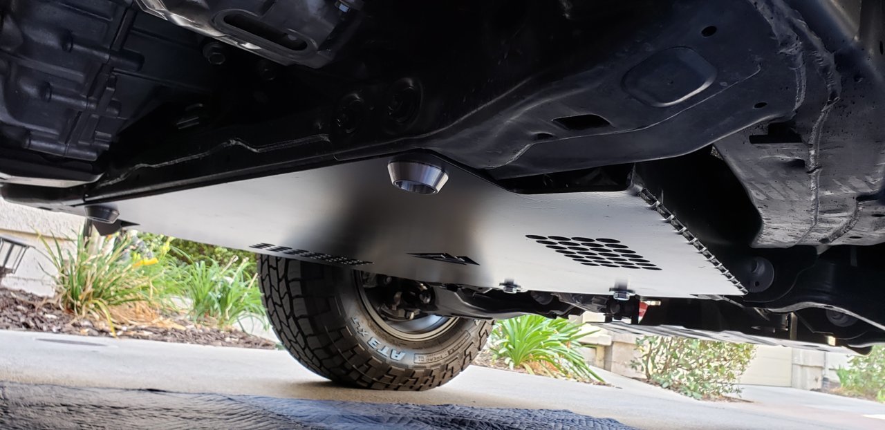

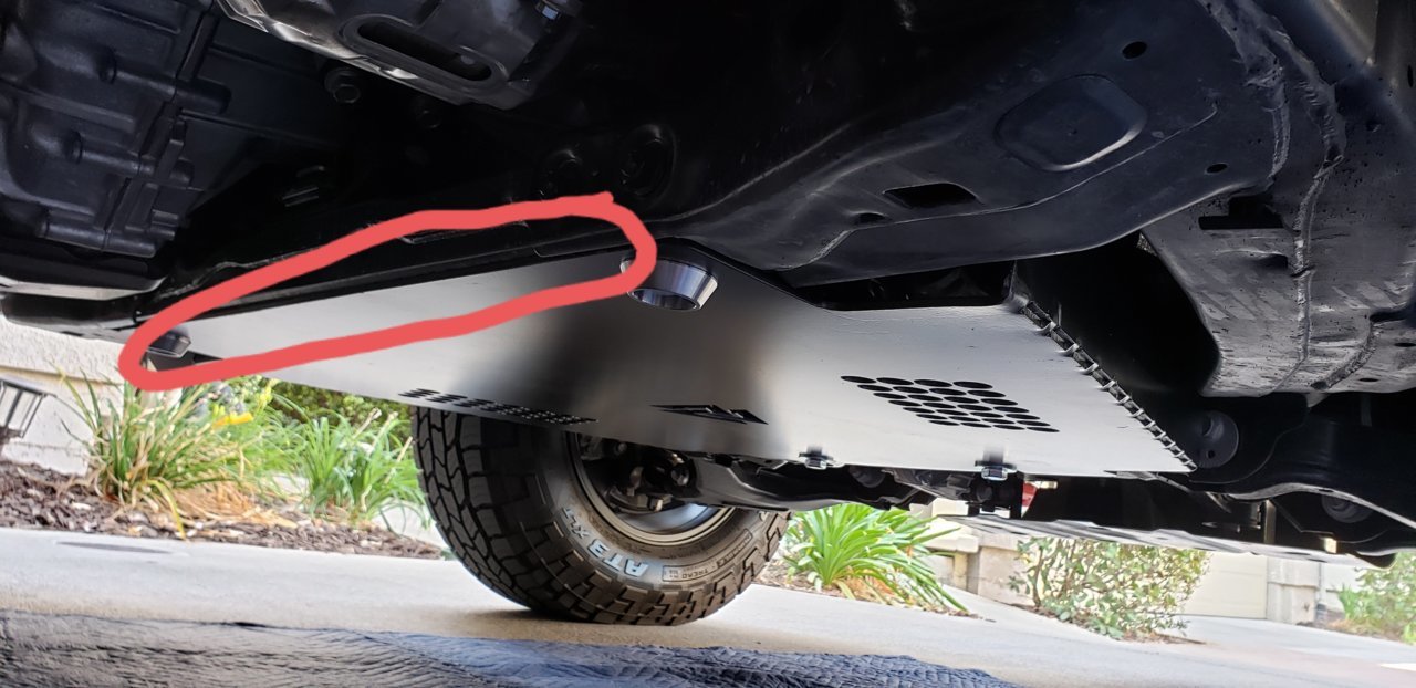

    Installed my steel front plate. For anyone that's going to be installing this themselves and using the provided bolts make sure you have size 24 socket and/or wrench. That's the size of the front bolts, back is size 14. Also a jack to help you carry it up. On the 2nd picture where its circled if you hit it, it hits the cross member and rattle but took it around the block to test for any rattle and I didn't hear any even going over speed bumps. All 4 bolts are nice and tight so I think my plate just didn't come flat, a solution if you run into this is a double sided rubber pad. I didn't put one on mine yet. Sorry for the long post, overall very satisfied with plate and added some peace of mind.

    The aluminum plate has a slight bow as well. Another reason why I put a rubber strip between the plates.

    Could you correct the bow with some spaced lumber and carefully stepping on the high point to correct the contour?

    After looking at mine again more closely, I think the slight contour is because I did use a rubber strip between the front and rear plates. The rubber is compressed at the bolts but the center is contoured by the thickness of the rubber strip.

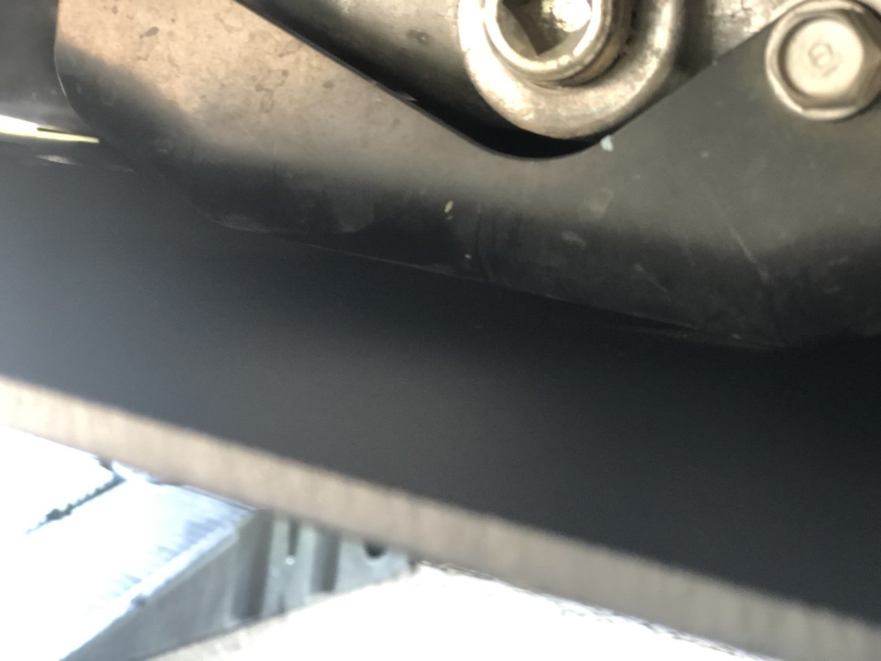

    I have GREAT NEWS!!!! I figured out why the rear plates aren’t fitting! It wasn’t the Z brackets, the bend on the rear cat plate was just alittle off but it was enough to cause an issue. I suggest all who have had this issue to space the plate to the Z bracket. Part of the steel will have rear cat plates that aren’t bent right, I will try to include extra washers for this, but for the rest of the steel and all of the aluminum going forward, will be bent correctly
