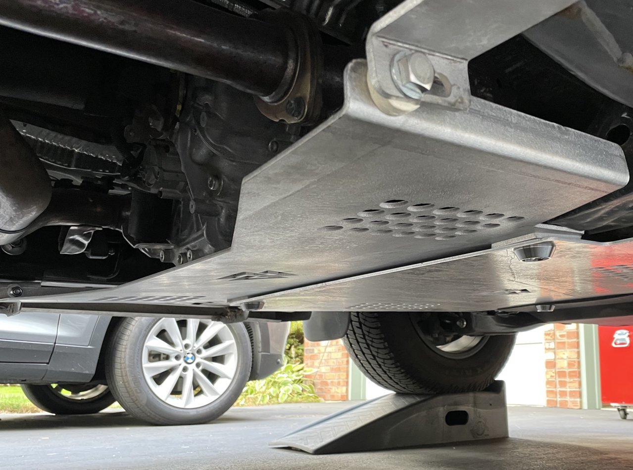

    Received my 3/16 aluminum shields last Saturday in good shape. Installed them today with my RCI shield. I ended up using the smaller diameter 4 inch bolts for the front and the small diameter 4 inch penta head bolts for the middle. There was a gap as mentioned in the previous posts so i fabricated a spacer out of piece of 1/2 inch starboard I had left over from years ago. Starboard is a marine board, impervious to saltwater and a lot of other things. It could have been thinner but it worked. Some photos of the fabrication and install. I also installed 1/8 neoprene pieces between the plates in places to eliminate any rattle. Also included a photo of the clearance of the rear shield. The existing small shield was removed per instructions.
    (sorry about the order, operator error)

    The spacers go against the frame, not between the plates, but if you clear everything I guess you are good

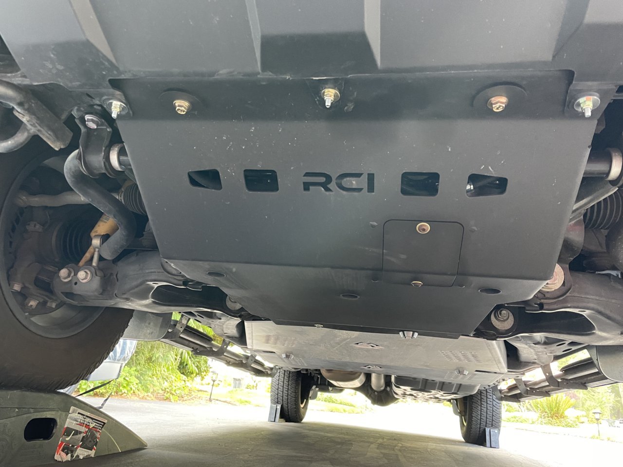

    Regarding the Z bracket, I had the same exact issue with spacing on the driver side. I was in contact with Tyler after I finished doing the install and he told me that an impact would fix the gap issue. Sure enough, I was able to borrow an impact from a friend and it fixed it.

    Curious as to why you didn’t just use the RCI supplied bolts to connect the RCI skid to the front cat plate? Due to the rounded heads they are already secure. I just simply loosened the rear RCI bolts and slid the front cat plate between it and the cross member.

    Yep, I noticed that also. As mentioned it seemed to have clearance. I kinda like the idea of a gap for keeping dirt and water from being trapped imo.

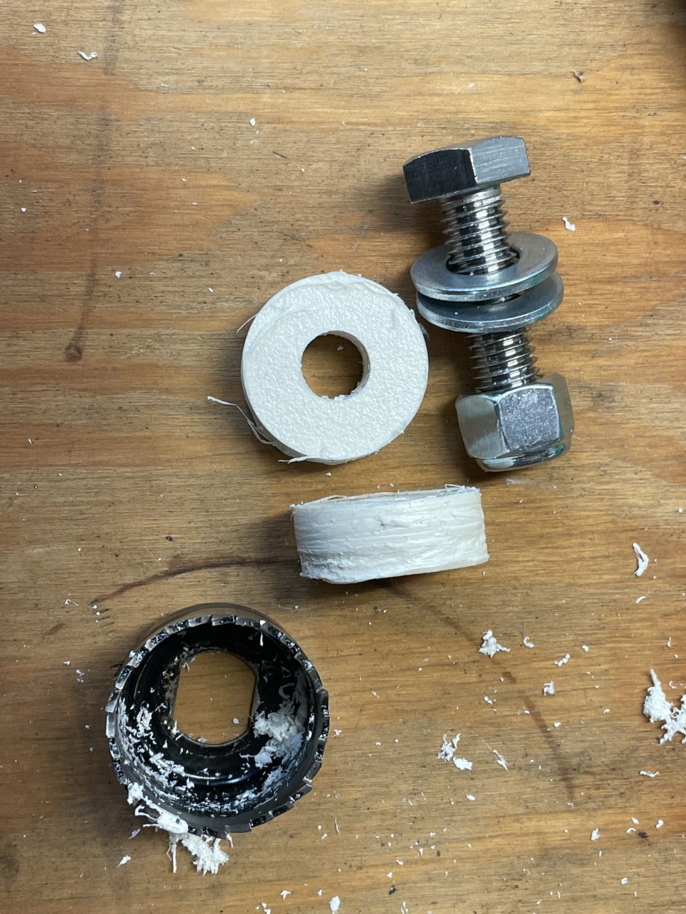

    I added a piece of neoprene between the frame and the cat plate to prevent vibration. It was just a U shape cut out, with 3/4 inch of material on the sides. It ended up being: frame, neoprene, cat plate, spacer, Cat plate.

    II thought it was easier to just hold the nut with a wrench and use an impact wrench to tighten the bolt head. I tend to hit my knuckles on everything…
    I also had them available as I bought the penta bolts for the other location.
