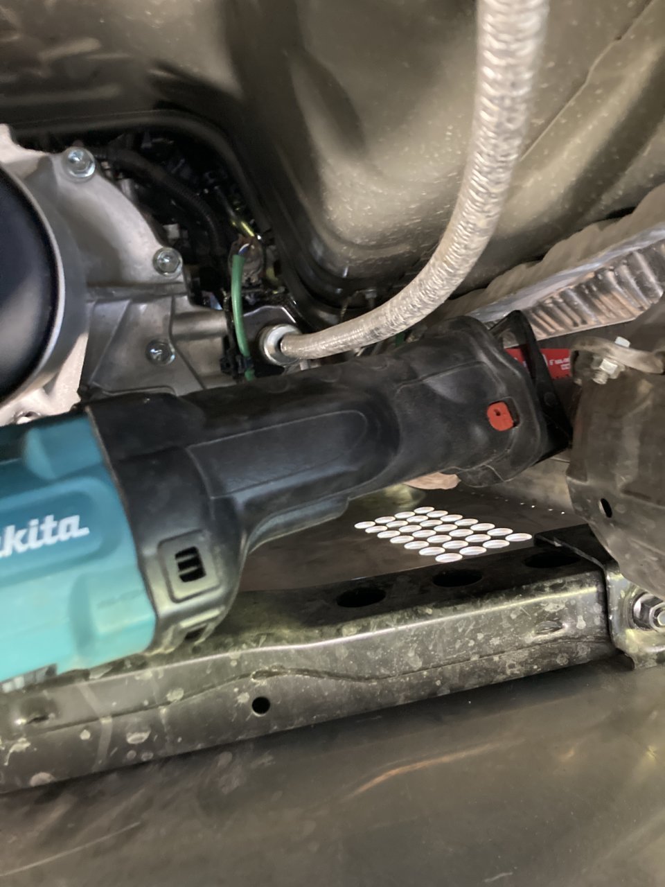

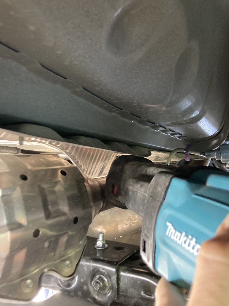

    I installed the aluminum plates today. With the standard hardware, I'm not longer worried about anyone trying to remove the plates. What I think is going to happen in reality is, they will cut out the rear cats and move on. The rear plate offers no real benefit and in hindsight, I wish I had just bought the front plate. If the rear plate didn't have the cutout design on the back side then it would be much more difficult to get a sawzall in there. As it is now, I had no problem sticking my full size Makita sawzall in there and could cut both frontsides of the rear cats easily. The thieves operate with smaller battery power units from what I've seen, which make it even easier. Perhaps the plate cutout is to make it easier to reach in and secure the bolts but it seems to render the rear plate pointless, in my opinion. I could still tighten the bolts properly if the cutout wasn't there. which I verified. Also the rear plate seems to be at least half the aluminum of the front plate but is only $50 less in cost. This leads me to believe that the cost is more in the labor to prepare the plate and if that's the case, not adding that cutout would be preferable to me.
    If this post in inappropriate in a vendor thread, I can move it to a review thread. See the provided pictures.

    Leave it, I want honest feed back. Honestly, the 2 wheel drive trucks have a lot of room back there, the 4 wheel drive trucks have a big ole transfer case there that makes it much more inconvenient.

    Why does the plate have the cutout? Is it to account for 4wd trucks?
    My apologies if I missed some disclaimer that the rear plate was designed for 4wd trucks. If not then my suggestion would be to either add it or offer a 2wd plate option.

    When you say cut out, what are you speaking about?
    These plates were designed for both 2wd and 4wd, but 4wd obviously has better protection. Adding anything in the rear like a vertical plate could be done, but I worry about creating an air dam and holding heat

    Not sure about the 2wd but for 4wd, there is no way anyone is getting a saw in there crawling on their back or belly. Even if they manage to cut the 3/16 side brackets, they are not bending that rear plate down.

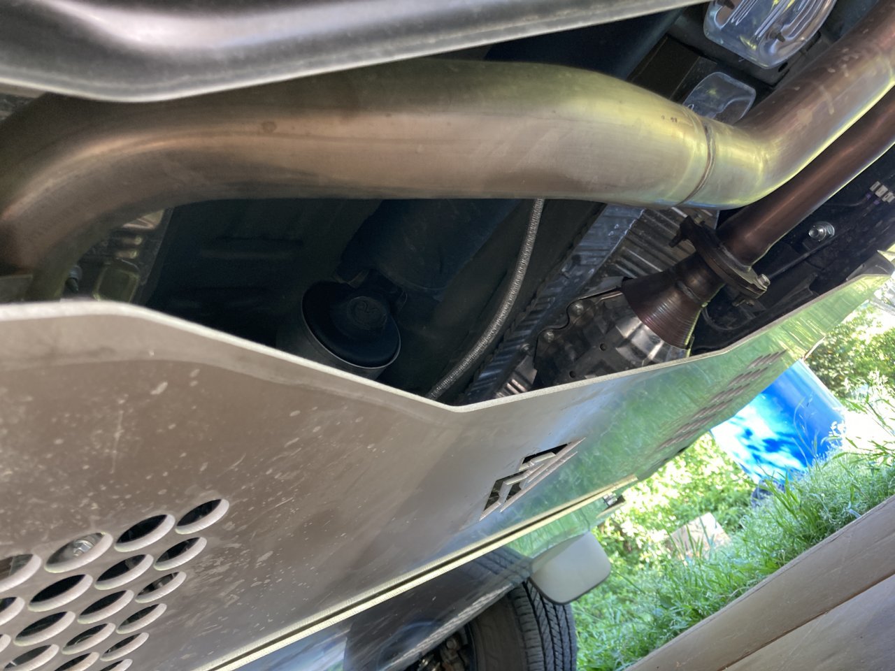

    You've cut this notch or swoosh instead of straight cut across. This is what allows the sawzall to still get in there.

    Ah, that, it was cut in there to avoid a custom exhaust clashing issue

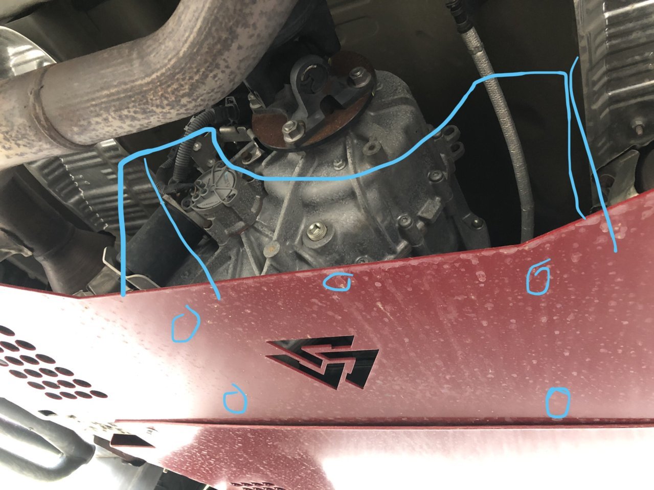

    I went under my truck and snapped this picture and please forgive the finger painting, but if it looked something like this with supports angling in and bolting to the plate. I think this would be a good 2wd alternative

    Yes and I can see it's clear that a 4wd is perfectly safe with the existing plate.
