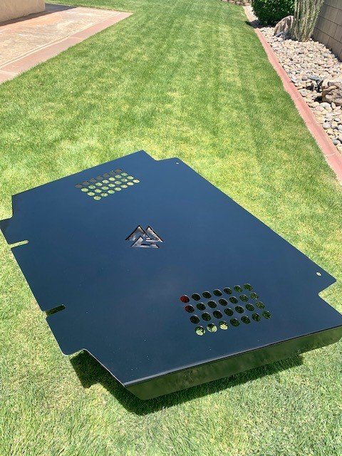

    Paint job looks good. Is this aluminum or steel? What kind of paint did you use, if you don't mind me asking.
    TIA

    I got the steel. I sanded it lightly w/a fine grain sandpaper and threw on some basic rustoleum self etching primer and then some rustoleum high heat/temp spray paint from Home Depot, easy peasy..
