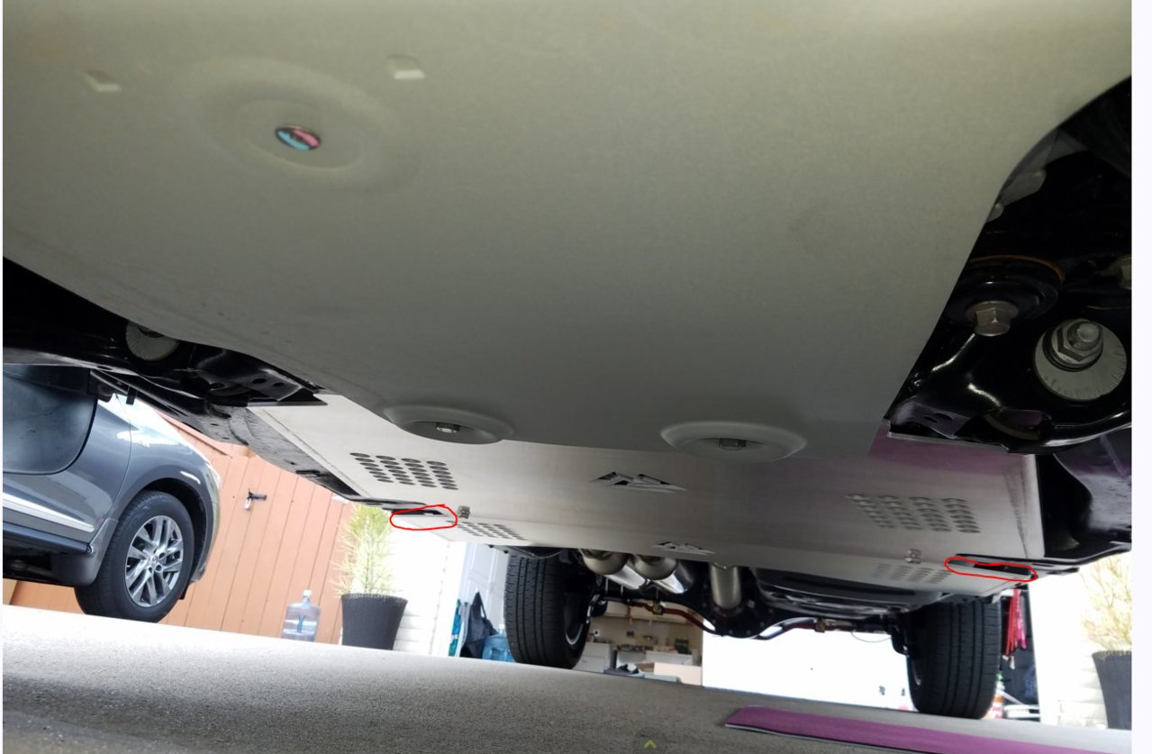

    Makes sense. I'll take a look some other day, I probably could have pushed the rear plate up further before tightening the bolt but there is only so much room before it would be pushed up against the transmission. If anyone else has the same side view of the rear plate at level view, I can take a look and compare in the event I have some adjustment to play with. Overall though 100% pleased
    Uhhhh....[QUOTED] likes this.

    Not being combative here - - you're rightly worried about the underside of your truck and I believe minutiae are important too. The pics also show the gas tank and mufflers hanging below the plates. I think Tundra engineering presents more of a risk footprint for rock damage than Tyler engineering for that. As for chinks in the armor - the cat plates' benefits as skid plates are really peripheral to their intended task; but the only way to cover everything perfectly would be to weld plates across the full length of the frame. Some gaps have to be there in order to install via bolts. As to hitting something in reverse - I don't think there's any increased risk versus the truck without plates; but adding angles to the plates, considering where bolts have to happen, would probably force them down even lower than they are now.
    I've thought of different engineering options on these as well, but none would really make them more effective at their primary task. I think they're as close to perfect as can be made, and they certainly beat the 5h!+ out of any other available solutions.
    goodonya, sir.

    "the gas tank and mufflers hanging below the plates" yeah, I thought that same thing after I replied lol. They were just thoughts I had when looking at the pics. I know most won't be doing serious offroading - I haven't, but would like to someday. I was just surprised to see it below the frame - I guess I assumed all along that it was flush or above it & it took me off-guard.
    "the cat plates' benefits as skid plates are really peripheral to their intended task" Yes ++
    "adding angles to the plates, considering where bolts have to happen, would probably force them down even lower than they are now" - yeah that makes sense after seeing that the rear bolts are right there. I was thinking maybe it could be cut where the solid line is (1st pic below), and then folded up where the dotted line is. But then I just weakened the entire rear support structure.
    Or....maybe just the bottom of the rear plate (not the lip on the sides) could extend an inch or so beyond that bolt, then it could be folded up at an angle? Second pic. I'm not sure the potential gain is worth all that though. I suppose even with an angle on it, the brackets could still get bent if whacked good enough.
    "I've thought of different engineering options on these as well, but none would really make them more effective at their primary task" Good point. I'll stop now.

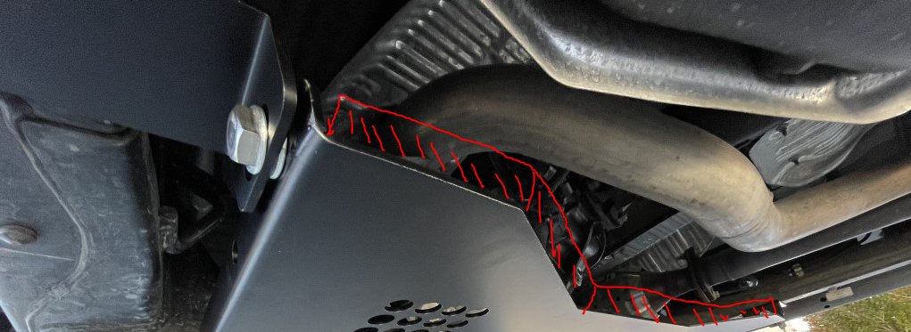

    So, if I can ever make time to spend modifying a rear cat plate, I will make V3… it will fix a lot of issues.
    as for the suggestion about having another inch on the back and bending it up, I like it, but the cost will go up because of all the changes for the machinery. I have another solution that is very close to this.

    Just 2 cents worth , but what about just a cutout where the trany plate is and bolting it up tight to frame? This is what I tried with the mesh , only haven't cut hole yet , wanted to see if being up tight on trany plate would affect anything , and so far after about 200 miles no problem, but am going to take angle grinder and cut out around trany plate anyway. Just a thought. Could be done with a solid plate as well as mesh, and still bolt up with brackets , instead of drilling holes.IMG-1627.jpg

    Agree , but then it is 3/16 " thick, and in all reality just as easy to cut brackets holding plate, and someone commented on plates hanging down so far, Was just looking at ways to get it up against the frame , and doesn't need to be mesh , could be a plate , I just wanted a lot of air flow, Those cats get really hot. Only deterrents for all of us. LOOKS LIKE ALL STYLES ARE WORKING SO FAR. Just thoughts. THANKS.

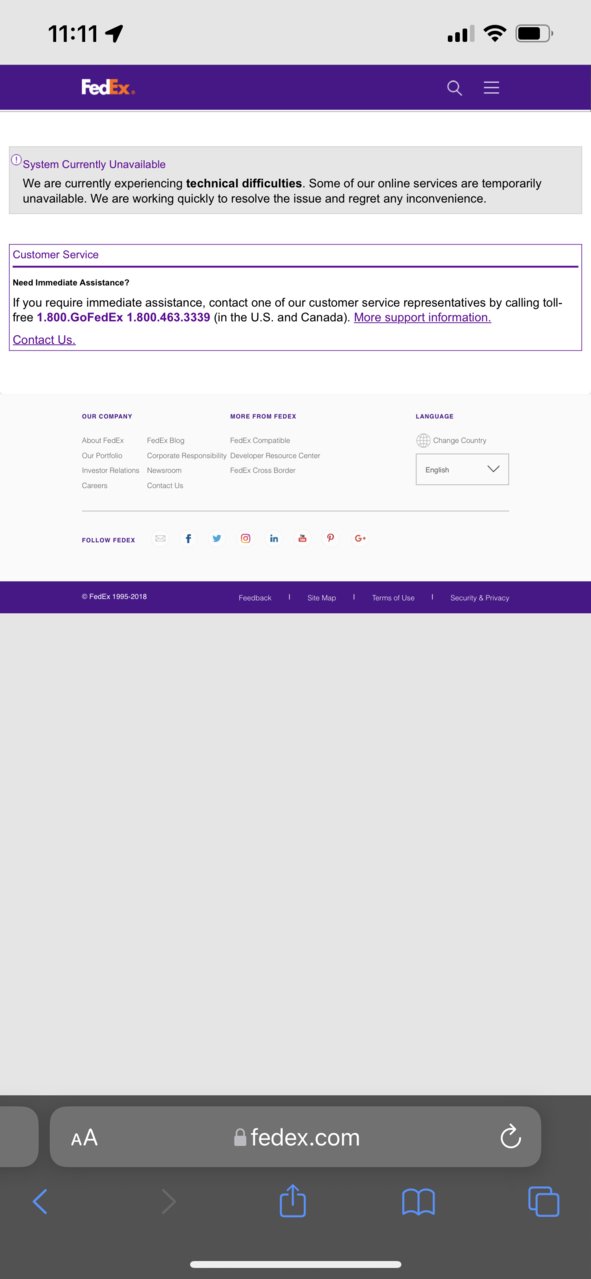

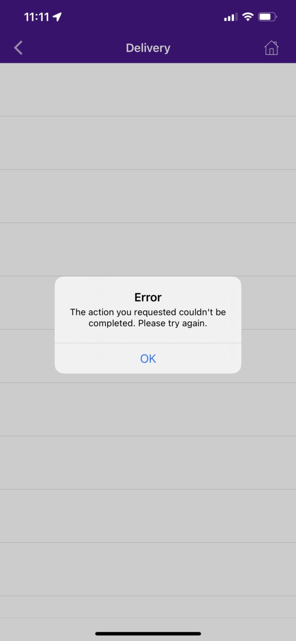

    Here is what I get from fed ex… app and website
