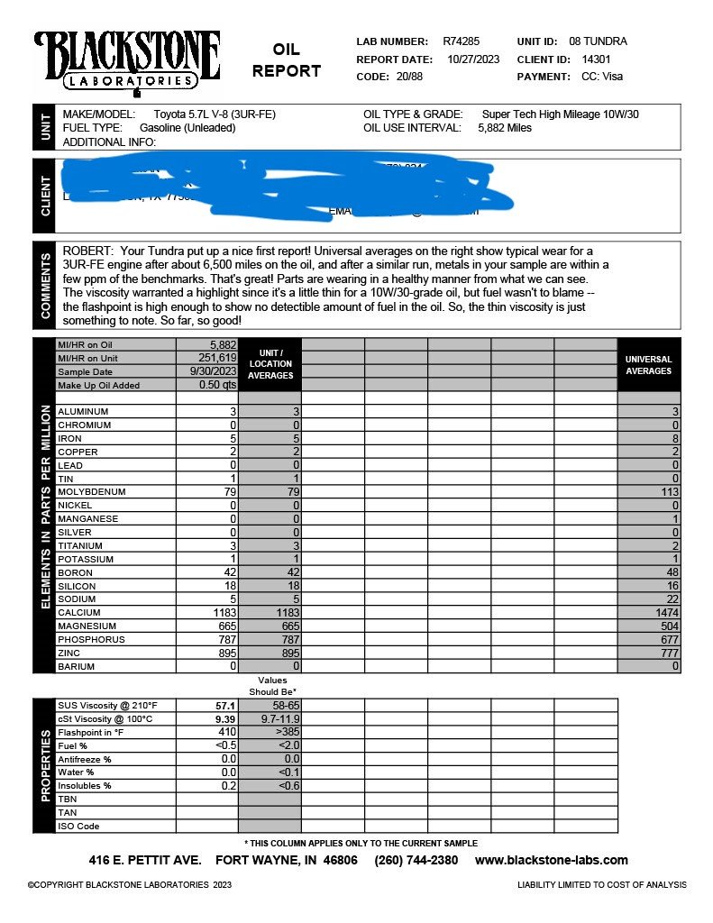

    On this oil change interval, my wife and I took a vacation to Big Bend NP and Guadalupe Mountains NP. We towed a 5000 lb trailer through the West Texas mountains in some of the most brutal heat possible. We also did some really cool 4 wheeling at Big Bend. Looks like the oil and the engine did just fine.

    Went on the wild side with Super Tech!!
    Sounds like a healthy report to me.

    Y’all get tbn next time
    it tells you the condition of the oil

    TBN or TAN might be useful if I were interested in extending my oil change interval. I am not so I didn't see the point in it.

    Interesting even with 10/30 they say it's a little thin viscosity wise
    Thanks for posting this

    understood.
    I only go 5k.
    The TBN tells me how much life is left.
    Ex..Kirklands 0w-20 still had a 4.6 tbn after 5k miles. Pennzoil PUP was 4.8 after 5k.
    all my wear metals were fine.
