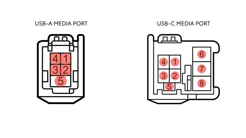

    Very cool diagram. If I'm reading this schematic properly the usb-c media support port also supports higher than 5amp charging because of the inclusion of a6,7,8 (vbus/gnd)? 65 watt laptop charging, possibly?

    No. The extra three pins are communication to the headunit.

    Interesting. Are they specifically for car play or just to relay information about what's attached to the port and what it's doing (charging for example) or?
    I looked up usb 3.0/3.1/3.2 pin and wire diagrams and was impressed with how different they are from usb-A or 2.0. I was unaware of the additional wires required for 3.0+ specs.

    The additional pins are to communicate device specs to the headunit.
