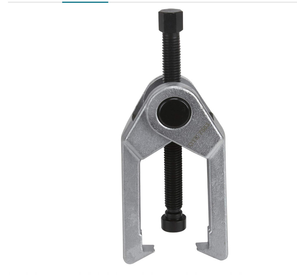

    hey sorry I’m late to the party! I’m needing to replace both my lower and upper ball joints, as the previous owner did a kit from 1A auto and I’m paranoid as hell.
    Anyways, I noticed you recommend this tool from autozone. Would I set it up the same way as they do in the little tutorial video? As if I were doing it for a pitman arm?
    Also, when you used it, did you remove the knuckle/spindle or were you able to use this tool in place? Thanks!!

    Yes it would be set up in the same way, but you'd have the mouth of the puller facing down towards the wheel hub to push the upper ball joint down out of the steering knuckle.
    I was able to use this tool to remove the upper ball joint with the knuckle in the truck still. Keep in mine all of this work was on my '03 (first gen) Tacoma, but that Tacoma and your Tundra have virtually identical front suspension setups.

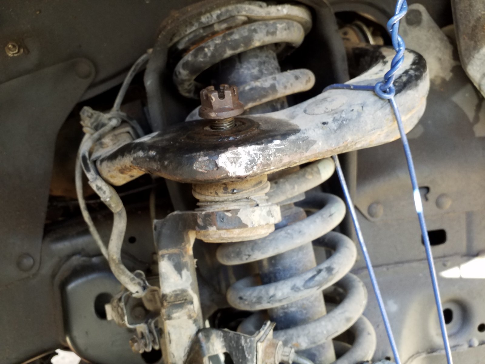

    Understand something: The distribution of stress/torsion/load between lower and upper bj is probably like 90/10 or something, where 90% of the load is on the lower bj, and 10% (maybe even less) is seen on the upper. Basically my tl;dr way of saying, "your fears are unfounded".
    You're at a higher risk of cracking that hoop in the knuckle where your upper bj sits while pressing it in/out than you are of having that A1 upper bj fail on you. I wouldn't recommend swapping it, honestly. I've seen a couple of knuckles now that had cracked at that upper hoop/mounting hole for the UBJ, actually more times than I've seen failed UBJ.
    It's really important not to conflate the two with the design on these trucks and some gens of Tacoma:
    • LBJ = Tons of load, high risk of joint and mounting hardware failure.
    • LBJ = Very little load, low risk of joint failure.
    A very easy way to separate the UBJ from the knuckle without using pullers and without beating the living shit out of the UCA is as follows, so you can repurpose as needed, using @bmf's pic above, and hacking it a bit...
    Take the castle nut. Flip it upside down so the crown is facing downward as hacked to show here. Get it to the point that (A) the nut is almost flush with the UBJ ball stud but the stud must be flush to or nut a fraction of a millimeter higher, and (B) there are 2-3 stud threads visible between the nut crown and UCA, like this pic tries to show. With this setup you can give a couple of stout BFH (big f'n hammer) blows to the base of the nut. If you try this with the castle pointing upward, big mistake, you'll fuck up the crowns of your castle nut. But doing it like this with the crowns facing down, you preserve the crown, you won't damage the threads of the nut or ball stud, and the joint should pop free. If not, wedge something solid between the ground and the UCA to lift up the UCA slightly, so the suspension won't articulate when you smack (maybe necessary for some rust belt folks).

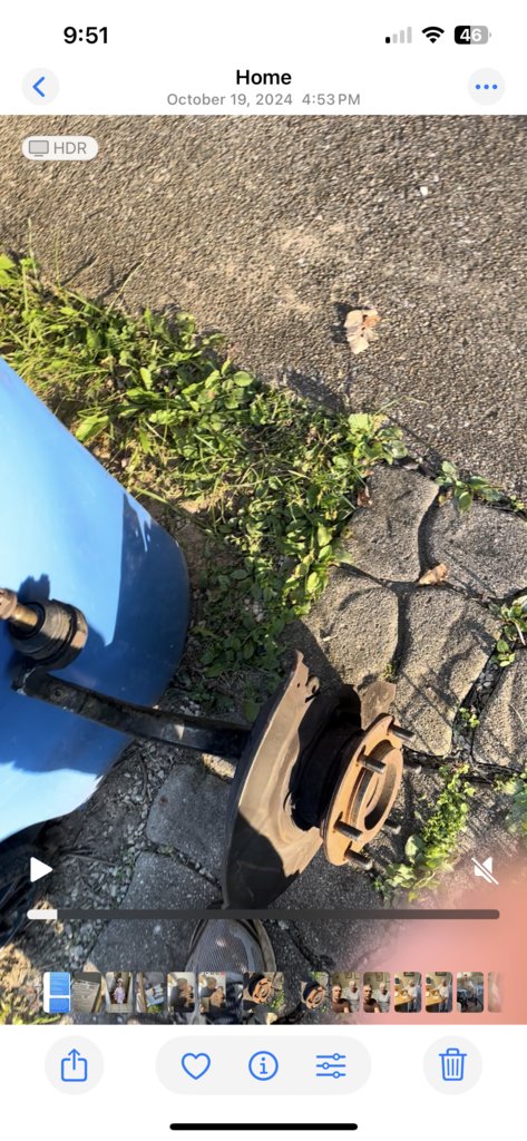

    My goal was to remove the whole knuckle to change the wheel bearings possibly, since I have an annoying noise. Hence needing to get the upper control arm ball joint loose.
    No, I didn’t have luck with the last tool rented from Autozone, which possibly was the one mentioned above. The two feet/hooks at the bottom of the clamp weren’t long enough to grab the rounded shape of it—and the bolt and wing nut were not long enough to open the jaws wide. I went to my bolts bucket and the hardware store to widen it. Can’t remember exactly why, but it didn’t work for me. I can’t upload my iPhone’s video for some reason (too long? a minute, and my still shots have adjacent thumbnails along the bottom, so I won’t upload now. What a pain to have to go to a laptopIMG_4398.png ), but I filmed as I sat on a metal fence pole lodged carefully between the UCA and the knuckle, and, combined with propane heating and pb blaster, my weight and hammer blows broke it loose and ripped a hole in my favorite jeans in the butt. The old 3-sided pole was about 5’ long, and I sat on it and bounced while banging it. Have to be careful with rubber grease boot and abs wire.
    The hub turned out to be dead silent and never had any play, so I delayed the bearing replacement and will monitor the noise. Watch and wait for now. The vehicle weight may bring out the noise, I know, but it’s not a drive ability or safety issue yet.
    I have no idea how this image will upload. Apologies if it’s a huge pic.

    No doubt, I believe you. I'm just saying, the way I described, the UBJ popped free with two or three not-even-that-hard taps. And having the castle nut threaded on with 2-3 threads between the nut and UCA, the nut naturally prevents the knuckle from dropping out totally, which is a very-real risk, while also giving enough space for it to dislodge. I hear that tool is handy for other jobs too. I have an old school pitman/idler puller and used them for the LBJ.

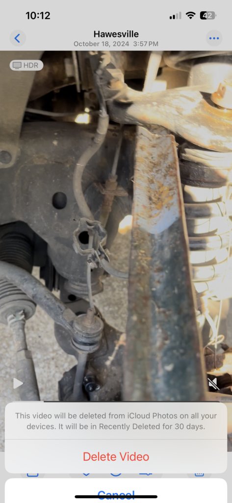

    My goal was to remove the whole knuckle to change at the wheel bearings possibly, since I have an annoying noise. Hence needing to get the upper control arm ball joint loose.

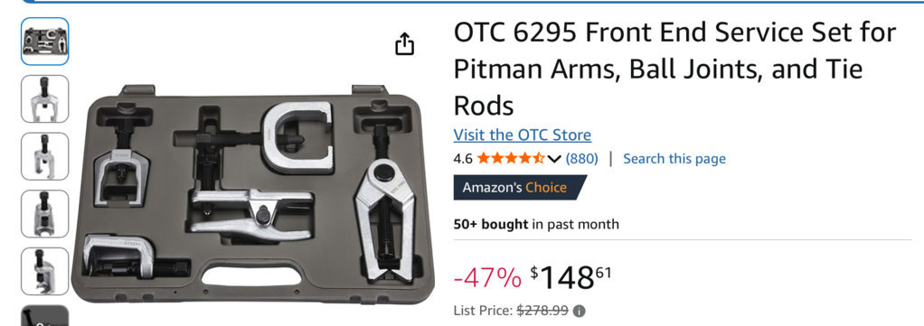

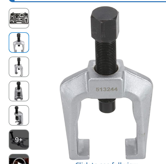

    OTC front end kit has had everything I've needed for front end work, except for the specialty cups needed to actually replace, not just pop, the UBJ.
    I don't remember off the top of my head, but I used one of these. Probably the larger, "scissor" type one.
