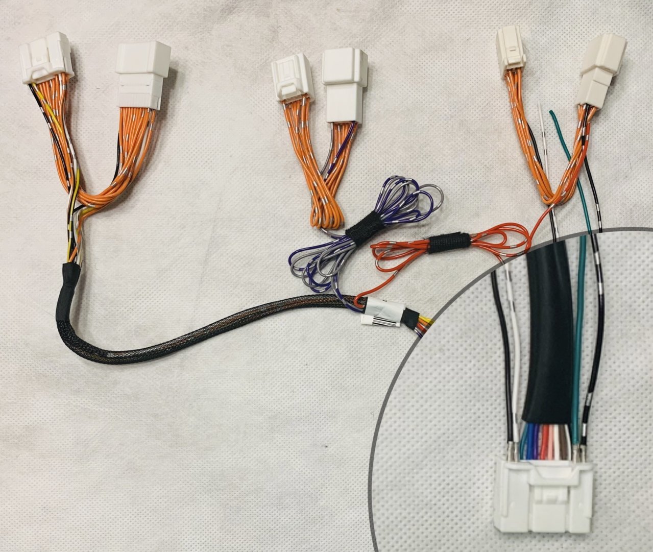

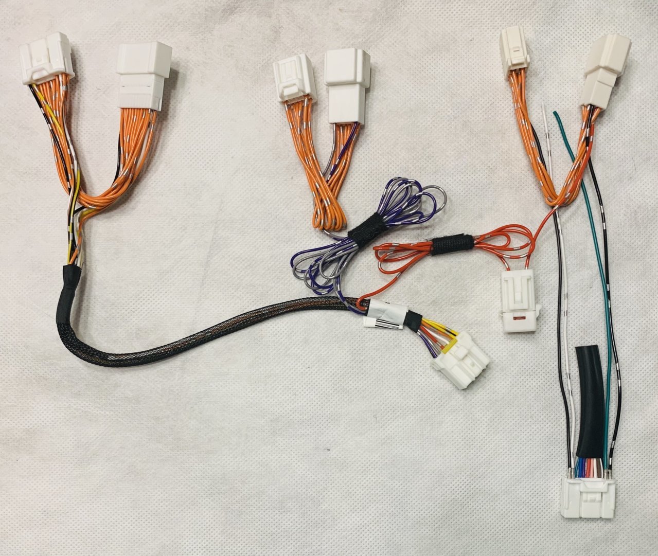

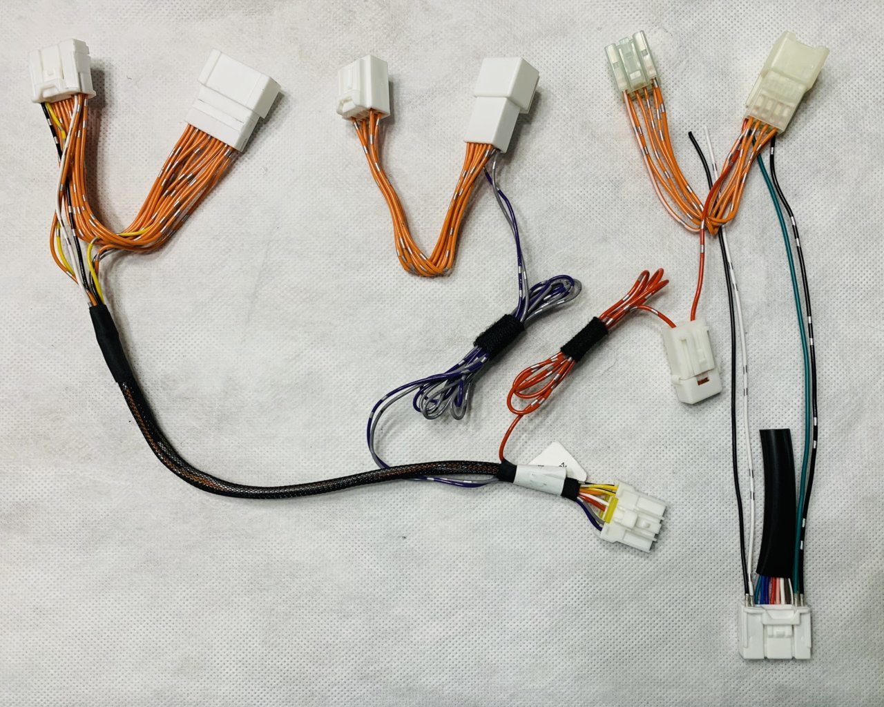

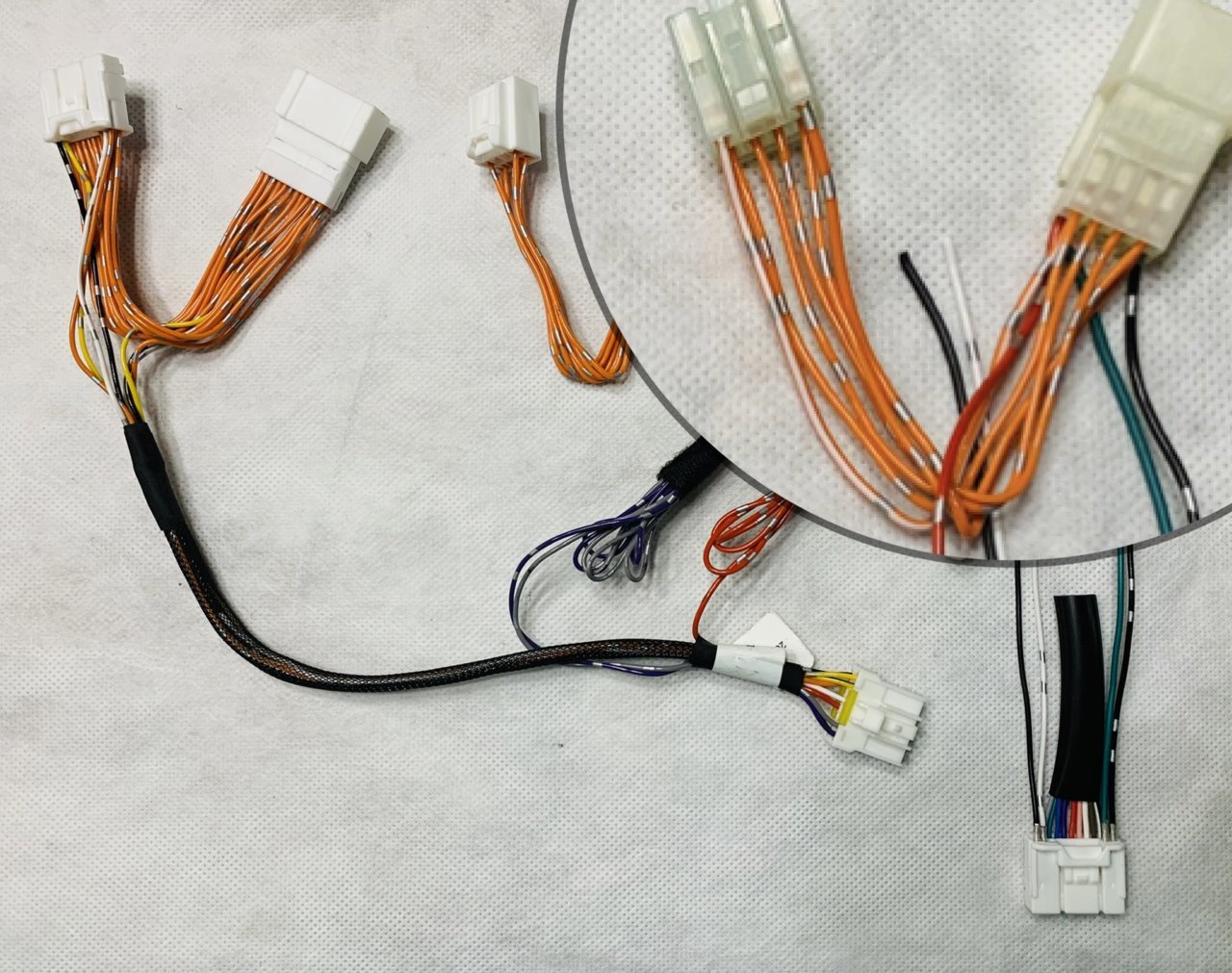

    UPDATE:
    Ok you SR5 Folks, and there seems to be a lot of you over here in the Tundra World compared to the Tacoma World. I may have the main harness with these Connectors.
    Here are some pics of the PNP Harness with the SR5 model OEM F/M Connectors that were delivered to me last night. I was able to mock up the FIRST SR5 Plug-N-Play Power Folding Mirror Harness tonight that I will be sending off to one of my Tacoma First Batch SR5 testers tomorrow to make sure everything matches up prior to the full release! If all works out, we are 100% good to go with EVERYTHING and I think all minor issues that were brought up during the testing phase have been addressed!!!:bananadance:
    SR5 PLUG-N-PLAY HARNESS
    3RD GEN TACOMA PLUG-N-PLAY HARNESS
    What is the difference...Here is the SR5 OEM Connectors
    How do you like my little mock-up of the 3RD GEN TACOMA OEM O1 Connector :rofl:
    I thought it would be nice to show how you connect the Power Folding Motor Wires (Black & Green) from the Extension Harness, as well as the Power Window PNP Harness (Black) and the Power Window Master Switch PNP Harness Wires (White) into the OEM O1 Connector.
    For you guys, you wouldn’t have the Power Folding Mirror Extension Harness because your OEMs have the Power Folding Motors already. So you would take the Power Motor Wires, which we would have a PNP Harness, and it would Connector to this Harness. I have my vendor currently working on your Harness as we speak but I will not release it until after the Tailgate Locks are all out and one other mod I haven’t mentioned yet :D
