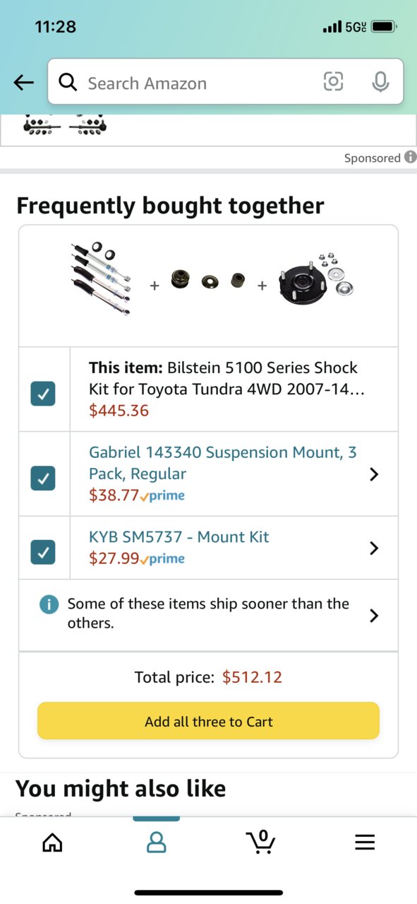

    I’ll be upgrading my shocks to Bilstein 5100’s in all four corners sometime soon, probably when my truck hits 100k miles. Should I go ahead and install new springs to make the install a little quicker by swapping out the old with the new?
    Are my springs with close to 100K miles still good or replace them? If so, I’ll eed recommendations on which ones to buy.
    Thanks

    For that money I’d go with Eibach and use the replacement springs. Your top hats are probably still fine.

    I may have to switch it up and go with Eibach then! I was pricing the new oem coils and it was pricey so I’ll prob go with that setup in the link.

    Just looking to level, no lift.
    My friend sent me this last night and I may go this route instead!
