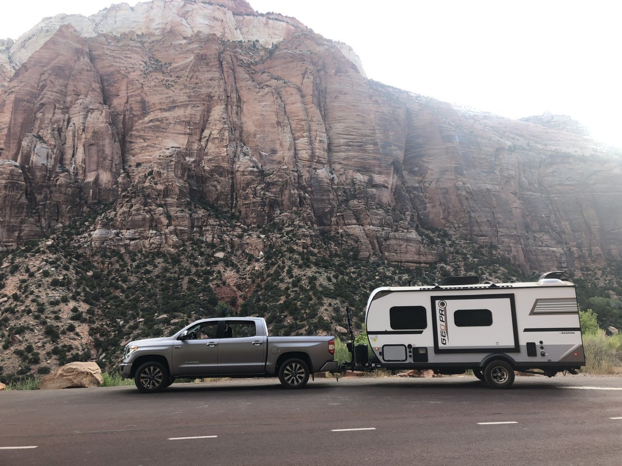

    I’m looking at same thing. I will be getting a travel trailer. You might want to look at a WDH they can be pricey the one I bought is $500 it’s rated to handle up to 800lbs of tongue weight w/sway control. Air bags just remove sag. WDH puts trailer weight across both axles so you don’t have sag. I’ll show you a pic with my in-laws WDH pulling my in laws TT.

    What size trailer are we talking here? If it’s like a 4000 pound lightweight then hook it up and go
    if it’s closer to 7 or 8 then I’d rethink it

    Oh well it’s sitting at around 4000 but tongue weight is around 450. Book states 500lb max tongue weight without WDH so I have one regardless. Also helps with sway control. I wouldn’t tow without one, even a 4K trailer. And even with a WDH, the back can still sag. Neighbor has a tundra (he’s actually buying my like new shocks and springs on my tundra) and his sits about level with stock rake and no front lift.
    Maybe I’m overthinking too much, I’ll prob just ask them to not level it out if the box and only give me a 1 inch lift in the front.
