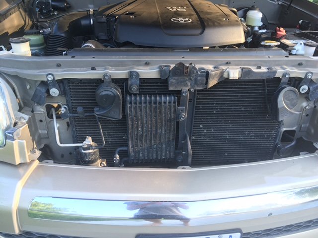

    I went out to check for fluid lines coming out of the trans and I was pleased to find them. I followed them and look what I found.
    That is the trans cooler, right?
    This truck does not have the towing package, and I thought that the cooler came with a towing package. I know that a tow hitch, 7 pin plug, and a high output alternator come with the towing package. Is the trans cooler standard on all Tundras, not just the towing package?

    That is the cooler. Mine is a limited 4x4 but only has the 70a alternator. I would guess it was standard.

    I have one as well on my 2000 LTD.

    That looks just like the Tow Package Cooler on my 4.7L which does a tremendously good job in keeping the fluid temps around 160°-180° in high summer and around 130-150° in deep winter.
    I’ve installed a By-Pass Valve that is designed to funnel trans fluid from the Cooler back towards the transmission in winter. This keeps the temps higher for better shifts. Without this By-Pass, temps would stay around 120-130° in deep winter.

    My 2000 AC has both the in-radiator cooler and the “small radiator” cooler in the grill. And my truck seems to have not come with the factory tow package since it’s doesn’t have a factory hitch or factory wiring.
    FWIW: I think every car (from compacts to full size trucks) in the last 20 years equipped with an automatic transmission has the in-radiator cooler.

    From what I have seen (and I could be in error):
    2002 and previous with V8 - all had transmission oil cooler (there was no separate towing package). Unknown to me if V6 trucks have them.
    2003 to 2006 - transmission oil cooler included with towing package only. Only time towing package was standard was on 2004-06 Double Cabs. It was optional on all other V8 trucks (Access Cab and Regular Cab) regardless of trim or 2WD/4WD.
    Unfortunately, all trucks have the built in ATF cooler in the lower radiator.
    And there is always the chance that someone ordered the factory parts back when the trucks were newer, and added the ATF cooler to their truck if it didn't have one.
