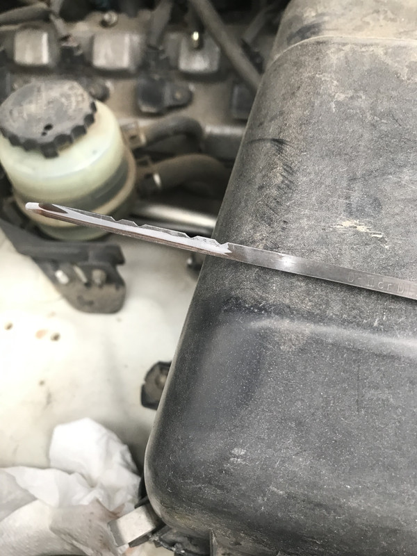

    Someone with greater knowledge than myself maybe can answer some questions I have. The Hayden cooler is rated for 30K GVW vehicle. Obviously much beefier than our Tundras. In my mind, I would think the this cooler would have no problem keeping things around 160* or below in all conditions.
    I’ve been monitoring it every day since the install and as previously posted, on my mountain drives, it was knocking on 194* which I chalked up to ambient air temp, uphill at 70mph for an extended period of time (40ish min pass). Still, I would think this cooler would have no problem keeping things at cooler temps. I also don’t have a baseline from my OE cooler given the same driving conditions.
    When I swapped the coolers, I must have added a little too much fluid because the dip stick shows it’s over full by a tad. Would that cause higher temps?
    This is my reading from my drive home today, roughly 20 miles, 80*-90* ambient air temp, mix of city/highway, no big hills or anything out of the ordinary. Hottest was 178* and after getting home and idling for 5 min while I checked fluid level, it went down to 145*
    Level after the drive home today. It’s a little high but not by much. It’s due for an oil change so I plan on correcting the level when I do the trans service/oil change.

    These are my opinions only and not expert advice:
    1) Your fluid level looks fine. I’ve run mine a tad high (roughly a little below your mark) since discovering the transmission ‘felt’ better in drives. Higher level shouldn’t cause high temps. Too high level is obviously not good. Fresh Fluid is better at cooling.
    2) Maybe your new cooler is set too close to the AC Radiator? Most online instruction says to provide at least a 2” gap. My memory says you installed too closely like most of the others pics I’ve seen. If you look at the OEM Trans Rad it has a large gap behind it for air circulation. This may not mean anything, but it might provide insight.
    3) Maybe a thin cooler (3/4”) isn’t the best? Maybe a thicker cooler, say like the thickness of the OEM (1.5”), that is slightly larger in area would be better? I posited this theory early on before, but an expert member in all things shot it down. Square inches make a difference when factoring in thickness.
    From my research, thin rads are better than thicker ones with no air moving across them. The thicker rads are better with air moving across it. We always have our cooling fan pulling air, so to me a thicker one is better suited.
    SouthPaw[QUOTED] and Jerry311SD like this.
