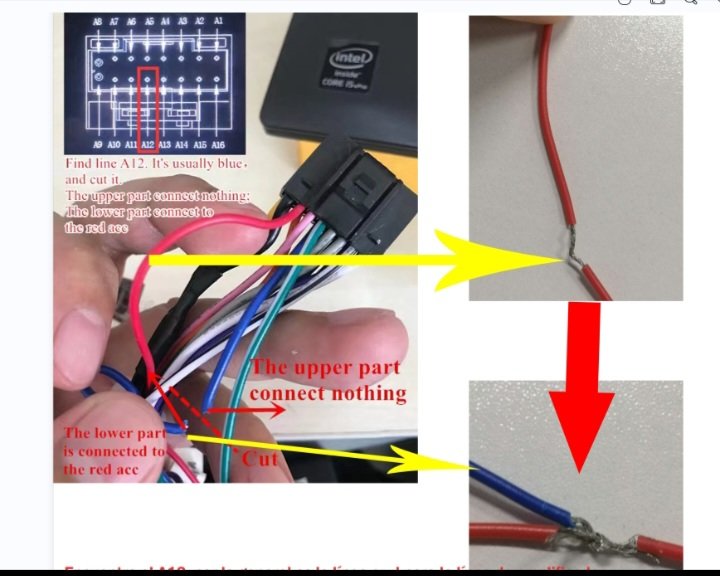

    I had one of those units. It was surprisingly good. There was a sound issue that was fixed with a wiring harness modification that the company helped with. Carplay and android auto worked well. The only thing I disliked was there wasn't enough ram. Do you have a link to the one with 4Gs of ram?

    Some of them got the sound issue, just change the CAN BUS settings to get it fixed.

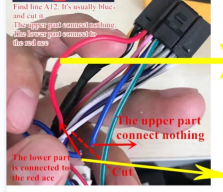

    The fix for the one that I had was to cut one wire on the harness and move it to another location. Nothing was mentioned about a canbus setting.

    Your car is with JBL amp, right? Then AMP control wire should be connected to make sound work.

    No sir, don’t have the JBL. When I get a chance I’ll find the pic for the modification.

    Found it.
