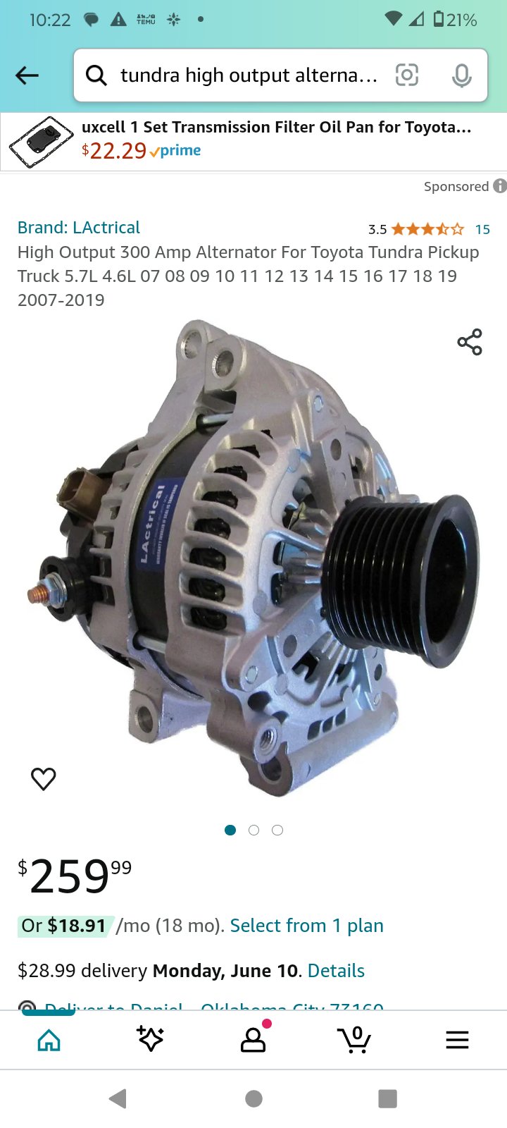

  5. Jun 2, 2024 at 8:21 AM
    Dawoofles
    Dawoofles New Member
    Mar 2, 2021
    #59884
    467
    John
    Santa’s Village
    2021 Cement Tundra SR5
    TRD rear sway bar, SS3 Max Amber Fog Lights, Carthartt Seat Covers, Morimoto LED interior lights, Ihacker LED Headlights swap, Driver Side Grab Handle, Husky Floor Liners, Weathertech full SunShade, Cat Back Stainless Works Dual Exhaust, OEM metal Oil Canister, Bed Mat, Deck Rail System, OCD Center Console, Full RCI skid Plates(Engine,Transmission, Cat Guard, and fuel tank), 12” Fi Car Audio Neo 3.5 Subwoofer, Gately Box, Rear seat delete, Sundown Audio Salt 2 Amp, Stereo Integrity front stage, Pioneer DVD/CD/wireless Apple CarPlay Receiver

  6. Jun 2, 2024 at 8:28 AM
    2mchfun
    Dec 31, 2020
    #56879
    6,553
    Dan
    I think @Cruzer runs this or similar
  7. Jun 2, 2024 at 8:38 AM
    Cruzer
    Cruzer Wheeling Full Size
    Oct 12, 2020
    #53461
    3,249
    Cruz
    Sunnyvale, CA
    Build Page: Cruzer's Re-Build for the Rubicon
    Yeah I’ve got this one. Works great with stock belt and never had issues with it.
