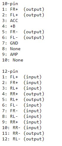

    I seem to understand the entire concept here with the amp/amp power, harnesses etc. however what I don’t get is the harness adapter (input/output) part. Each of the + - outputs are supposed to go to the amp on the output side to the speakers(one per channel). Where do the bare wire input signals go to?
  5. Nov 21, 2024 at 2:41 PM
    #35
    Snert
    Snert New Member
    Jan 31, 2024
    #111218
    681
    2021 SR5

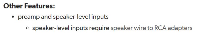

    On some amps there will be 2 different ways for signal input, RCA's or sometimes you'll see a proprietary wire harness/plug for the amp/manufacturer. Most common way for signal input everyone knows about are RCA cables. RCA cables are just a + and - wire in one wire/connector. To use that Kicker 5 channel as an example, you can see it only has RCA inputs. Back in the day some amps would only accept "low level" or "low voltage" inputs, which is what RCA cables usually are, however RCA cables are just cables and they can be "low" or "high" voltage, i.e. say 1 volt for low voltage or 10 volts for high voltage. Again using the Kicker 5 channel as an example, if you look under the specs you'll see (and most amps nowadays fortunately) it can accept low or high level inputs:

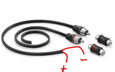

    All that said, what you would do in this case, is buy 2 pairs of speaker wire to RCA adapters, which look like this:

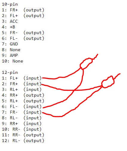

    As an example/like I mentioned earlier, each RCA plug has two wires, one + and one -. From your 10 and 12 pin integration plugs, you'd match up your inputs, so for channels 1 and 2 of input you'd find your wires on your harness for front left + and -, and front right + and -, and then solder or crimp those bare wire ends to the bare wire ends on the RCA plugs like this:
    Rinse and repeat for the rear channels, and then you have 4 RCA plugs to use for input into the amp. Like I mentioned before some amps will have their own wire harness for "high level" or "speaker level input", in which case you'd have a little plug that goes into the amp and has it's own bare wire ends, and then you'd match up/connect those to the bare wire inputs on the integration harnesses.
