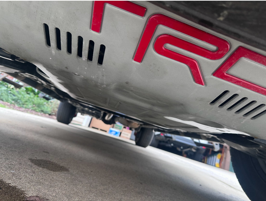

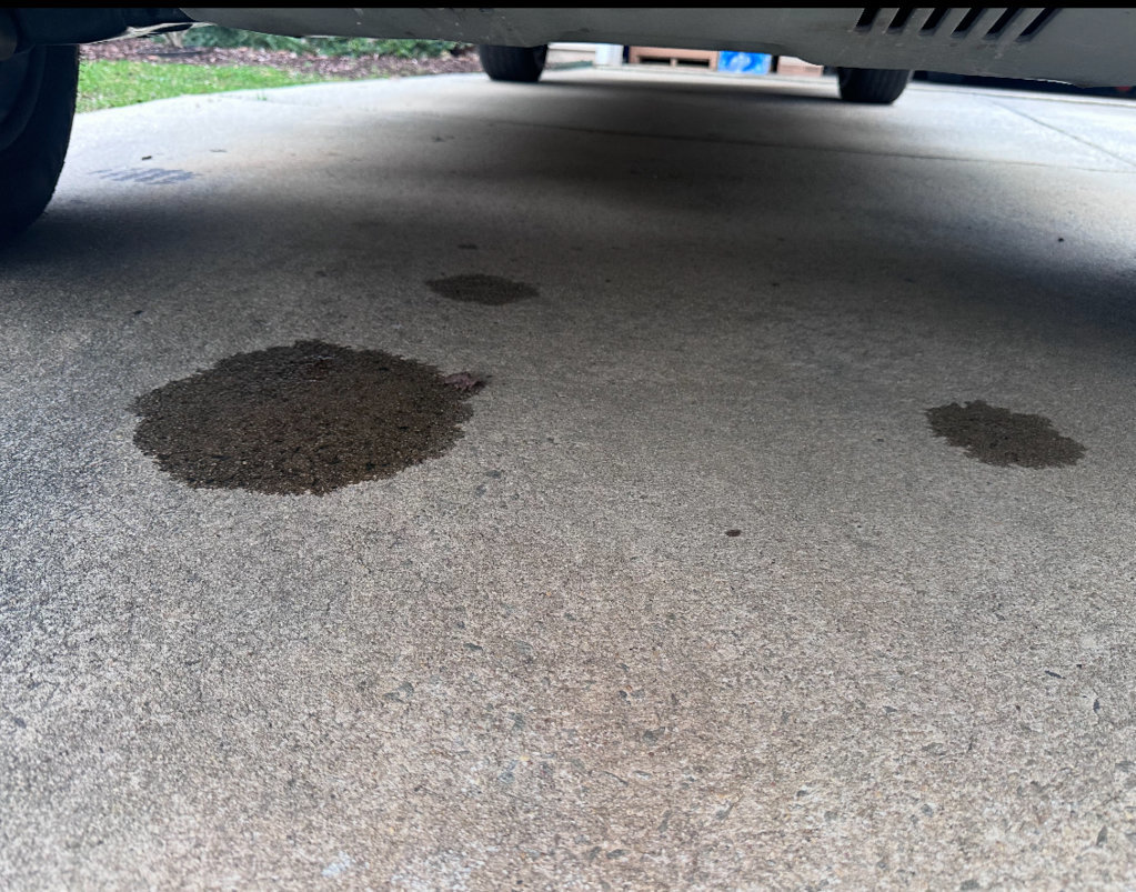

    My BIL got his truck back after almost 3 weeks, unfortunately the leak is even worse than before. Back to the shop and to say the least he is very unhappy.
