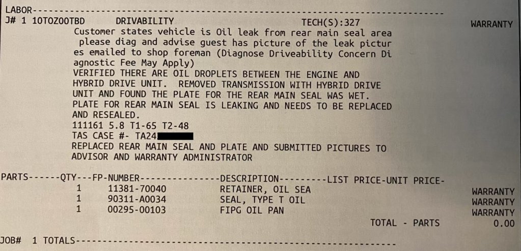

    After driving around in a loaner Corolla for almost a week, I got my truck back today. Turns out it was the Rear Main Seal (RMS). Drove home, immediately went underneath to verify and so far it's dry.

    Keep an eye on it after a week or so. They replaced my rear main seal also thinking that was the issue but it wasnt. Mine was a freeze plug on the block. Hopefully it is though so you dont have to go thru what i did....

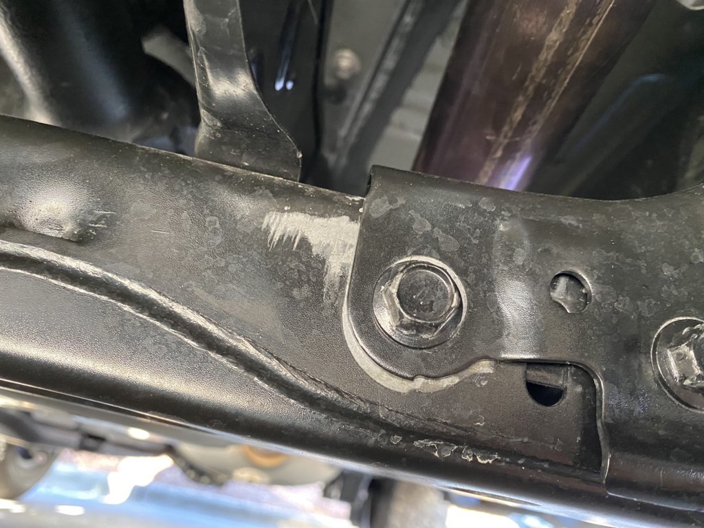

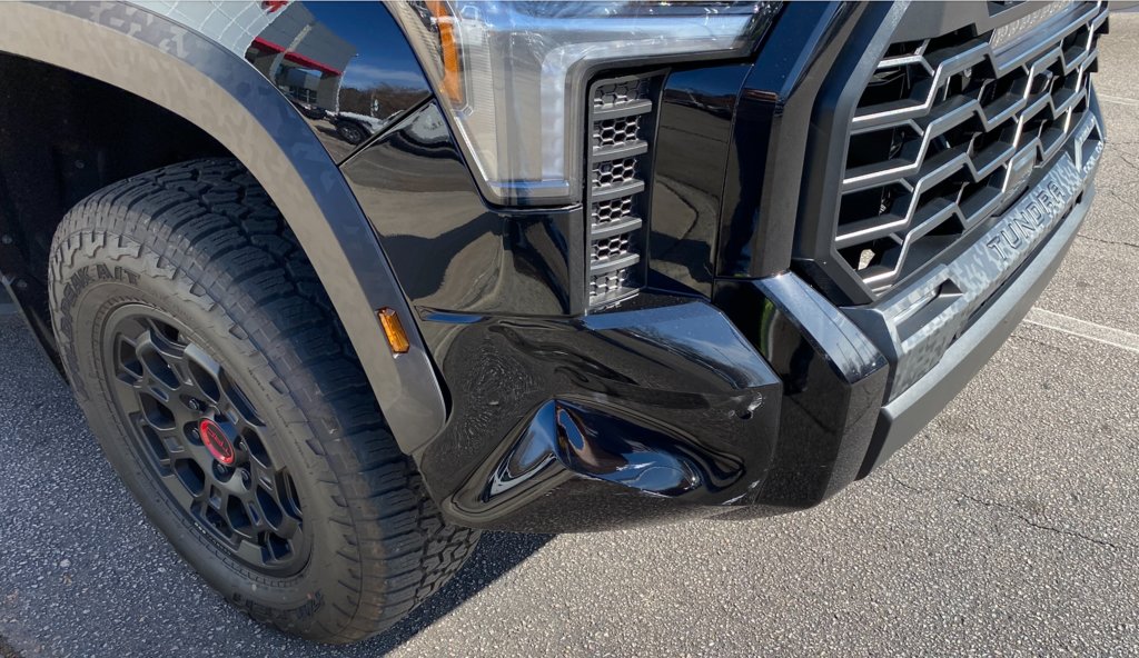

    I must have the worst luck. Look at this 'free gift' from the dealer while my truck was in for the rear main seal. The dealer at first denied being at fault. So together we looked at their camera footage (I took pictures of their screen) showing my truck with under 1500 miles going in was perfect, and when they brought it around to deliver it back to me, the passenger side bumper was damaged.
    Obviously they are going to fix it, but I really rather give them a parts list and do it myself. Another reason why I try to never let anyone touch my truck!
    I better not need a short block like @Esoto787 after all this.

    Thats obviously dealer fault. Someone either backed into it or tech hit something. Id be mad but at least they are fixing it. Ridiculous.

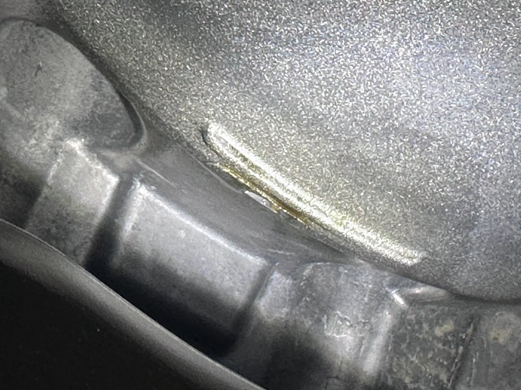

    And mine is leaking again... just started but I look at it every day now.
    Toyota might be monitoring the freeze plug situation because I got copies of the pictures that were taken by the dealership and sent to Toyota for warranty approval, and one is focused on the freeze plug (below), others are of the rear main seal.
    I guess I'll get the front end damage fixed first, then go back to a different dealership for attempt #2 to fix this.
    Updated (Jan 2) picture showing the leak is continuing, still waiting on body parts to be painted so I can install them before I go in for another attempt to get this fixed.

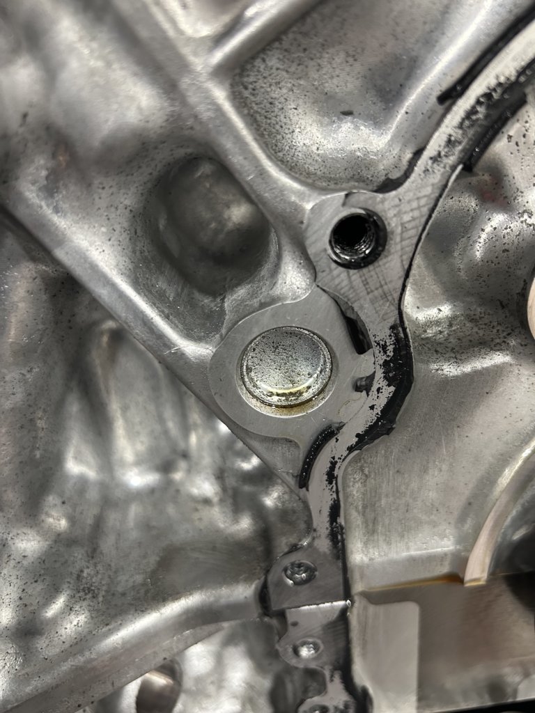

    They use loctite as a sealer when they press those rear plugs in at the factory. An oversized drilled hole is the reason for replacement.

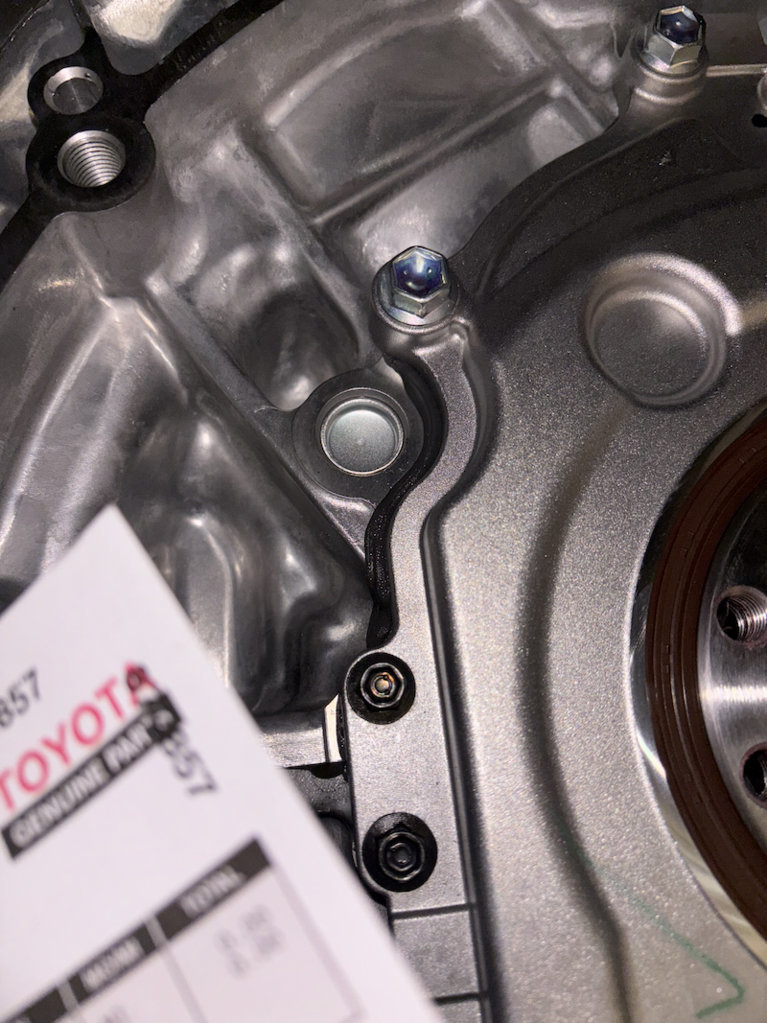

    Best of luck for your BIL with it. I just got mine back after 10 days in the shop with a new short block. Hoping to be problem free now. I'm doing another engine break-in for the first 1000 miles on the new block and then another break-in oil change right after that.
    The dealer confirmed that the oil gallery plug (picture below) was where the oil leak was coming from.

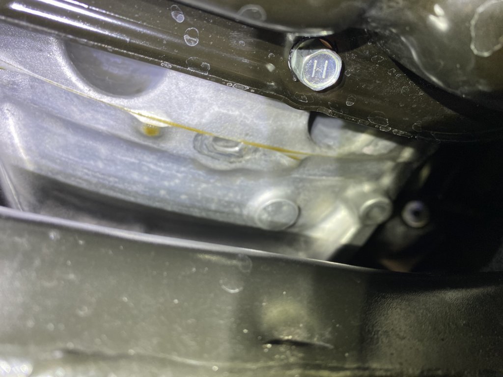

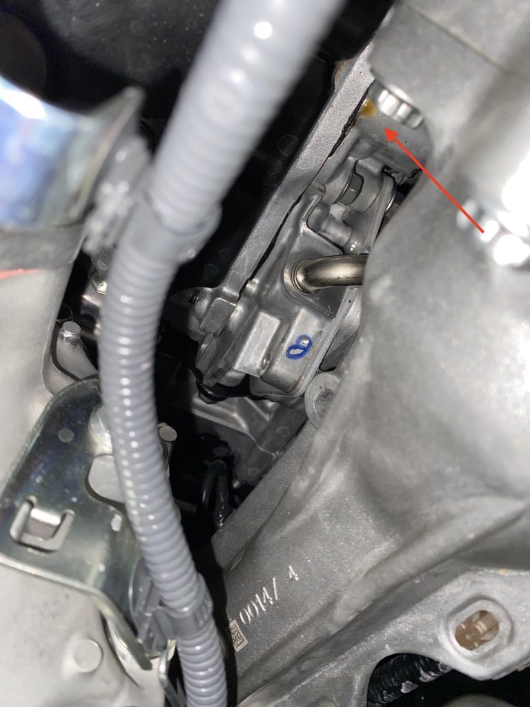

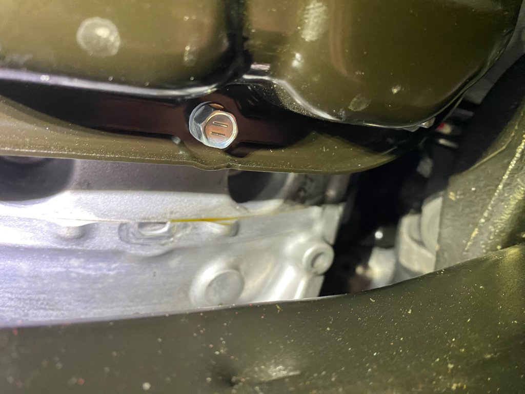

    Wish I didn't have to post this but I still have an oil leak (and maybe a new one too) after the short block replacement. First picture is the rear main seal area about 100 miles after the short block was replaced. I took pictures of this same spot bone dry at the dealership when I picked it up. Yes I go underneath before I leave to check things out. The second picture is a new area where oil is seemingly leaking from front timing cover above the power steering rack near the FIPG sealer (red arrow). I have another appointment for fix attempt #3 next week. I really do like this truck but I'm losing confidence in it and I'm now hoping to get over the 20 days in the shop for a buy back (at up to 14 days currently, depending on how partial days are counted) so I don't take a bath on having to trade/sell it with a vehicle history report showing how much repair work has been done in its first 2K miles. I'm a Toyota fan with 4 prior Toyotas that have been great, but all had designs from 2010 or prior. Maybe that means I should be in a 2.5 gen Tundra with it's 2007 design quality and much easier to work on the 3UR-FE than the V35A-FTS.

    it really shows the difference of a quality dealer, mine just takes care of everything with no BS at all. really lucky in that regard, not so much when I had my ram with the local ram dealer.
    his service dept needs to step it up, looking at the pics I almost see too much squeeze sealer or gasket stuff in there, I wonder if they fucked up the install, hard to tell though.
