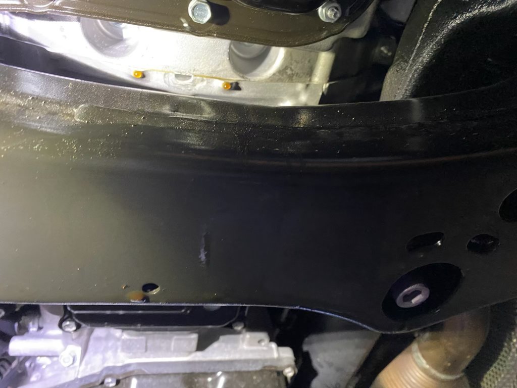

    Same leak on a 24 with less than 600 miles. Im really hoping this isnt a bigger issue that needs a major tear down or long wait to get fixed. Stopping at dealer this week to see what they say

    Well, went to dealer. They replaced rear main seal. 5 days later, leaking again. If this isnt fixed I'm getting rid of it.

    Man that sucks! Sorry to hear it's turning into a big issue for you. You should try to initiate a buy back with corporate. I mean a new truck with less than 1000 miles | the couldn't fix it right? Toyota sucks these days. I love my truck but at the same time I hate it. It seems so fragile. I want to get rid of mine. Just waiting for the engine recall to get situated, then hopefully I'll trade it in.

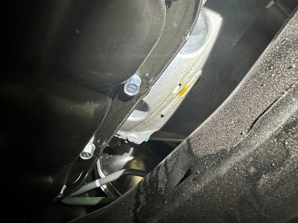

    2024 Tundra TRD Pro (06/24 build date, purchased 10/24)- 1400 miles and I found this... Seems to be leaking enough to get on the cross member and skid plate.
    Could this much be from assembly? I really don't want to let anyone touch my truck if it's a clean off and monitor situation but this seems a little excessive to me. I usually do all my own work (DIYer) however this is my first brand new vehicle, so having to deal with a dealership for warranty items is new and very painful (someone else working on it) for me.

    Thats a leak, not from assembly

    Well, hate to say it but i was one of those guys. 24 Limited. Bought the truck, drove it home 400 miles and it was leaking oil from what we though was the rear main seal in the exact same spot as yours. So dealer replaced rear main seal and it still leaked oil from weep hole between engine case and tranny. Apparently a "freeze plug" was leaking oil. Got corporate involved and they were on top of it! I will say for what it was they had me in and out within a few weeks. They put a new short block and 4000 miles later shes doing fine. No issues. I was worried at first about everything but havent had an issue since. Was i mad? ABSOLUTELY FURIOUS!! But now that i look back at it they gave me a rental Tundra to use, and had a short block ordered and replaced with in 3 weeks total time. So they took care of me, cant complaint there.....
    But it looks like you *might* need a short block if its a freeze plug and not the rear main seal. Been there done that. Very frustrating for a brand new truck.

    exact same leak
