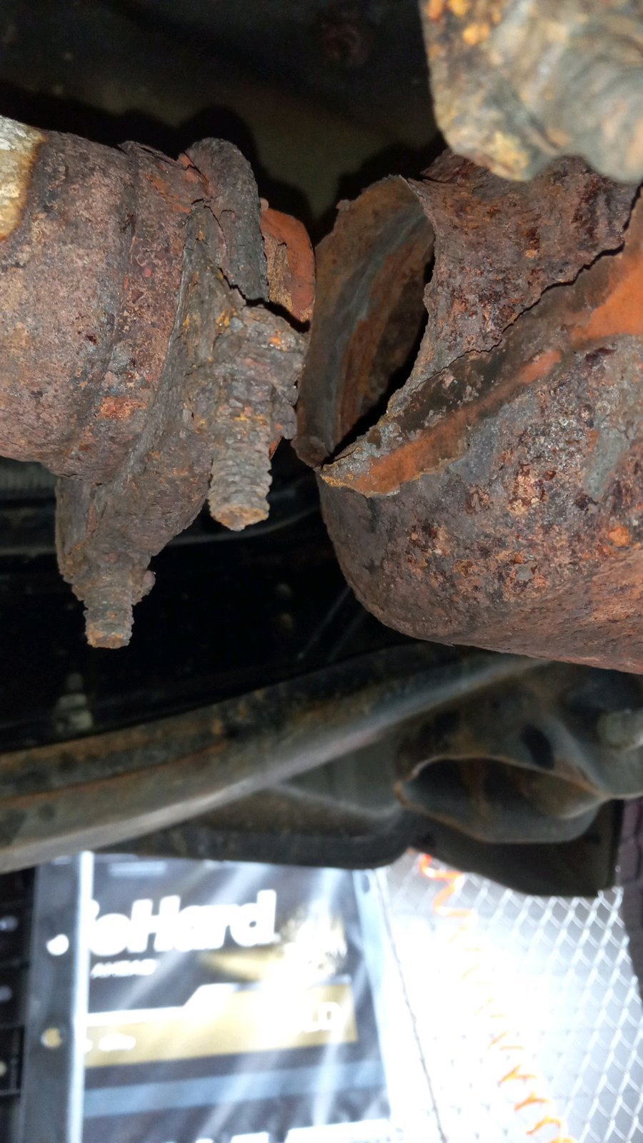

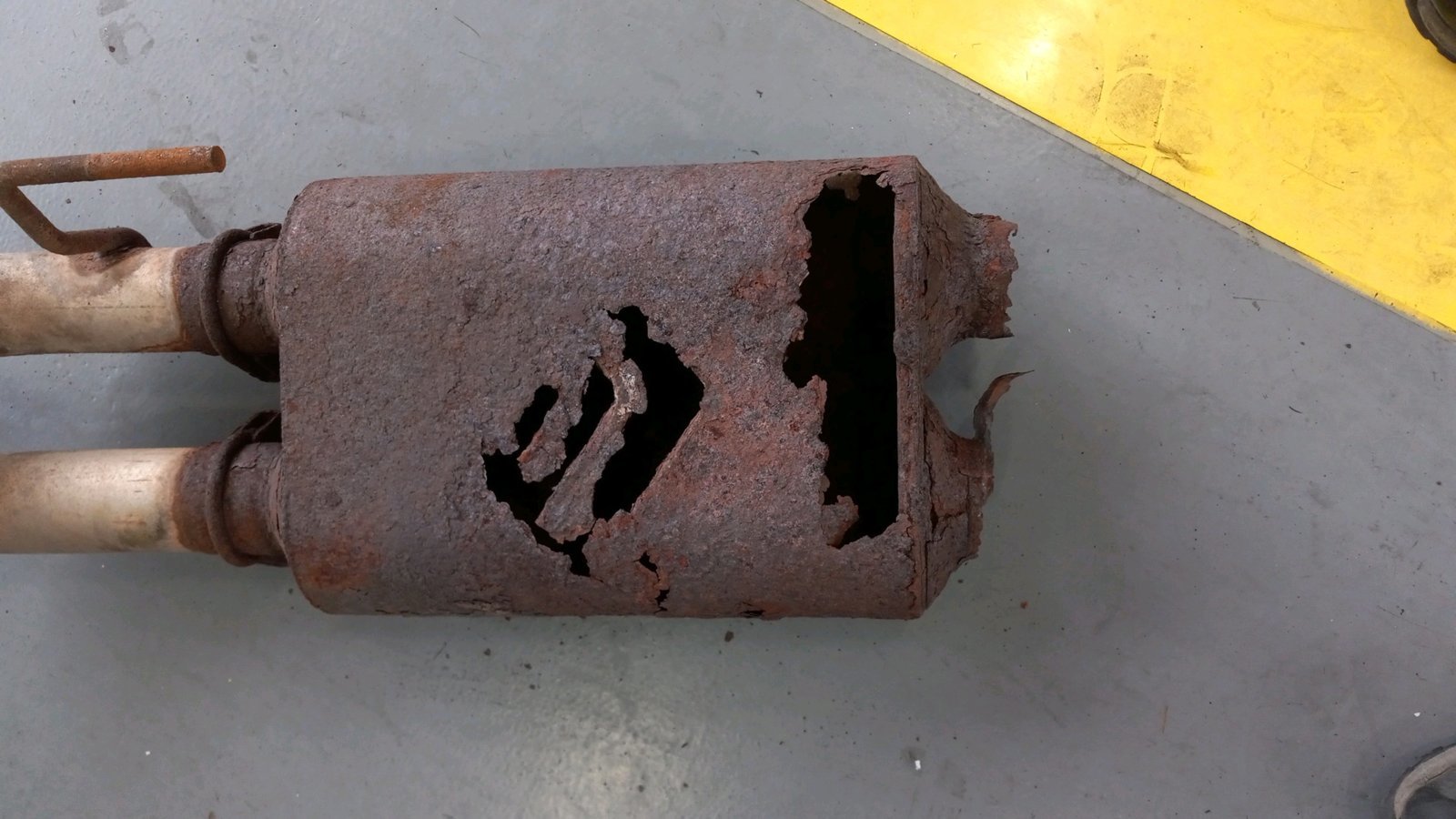

    Well, I wanted to throw one more update on here.
    I did speak with @dirtydeeds and Keith is amazing to work with and has been very helpful.
    In the process, I had to pull my old exhaust and ... I found the leak, the reason for the smell, and also the heat on the floor board. IMG_20240722_152217.jpg IMG_20240722_152427.jpg IMG_20240722_152217.jpg IMG_20240722_152427.jpg IMG_20240722_170531.jpg
    I think I might be able to reuse it... :p
    I know that this was worse than when I was first experiencing the issues on the road. So I cannot say the dealership missed this but perhaps it should have been looked at closer? I don't know.

    I did. I knew it got louder, but I also had larger exhaust and dual to boot. So I attributed it to that.
    I also had a couple others who rode in the truck and they were also shocked it was not louder than it was. So it is strange.
    When I crawled under the truck on the trip, it did not look that bad so I know that it got worse from then to now.

    For sure. I would have thought it was screaming with all those holes!

    Agree. That was why I was absolutely flabergasted by it. I thought it would have made me deaf but no, it only really got slightly louder. I just attributed it to the dual exhaust, and while pulling the camper, just being under load.

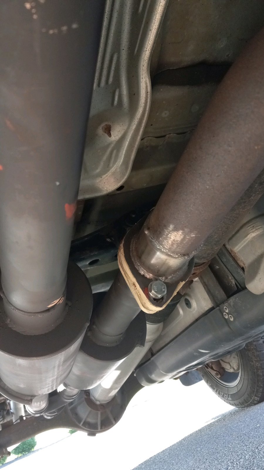

    Just a final update:
    I did work with @dirtydeeds and Keith was amazing to work with! I got the system installed but it took a little while. After it is all said and done, my truck is back up and running. No smell, no burning on the floorboards.
    To answer why I did not hear or know the exhaust was bad was because it NEVER, since I owned it, sounded this quiet. I did not know this was what it was supposed to sound like. So that is why it never raised a warning in my mind becuase I just thought it was the dual exhaust.
    The new system sounds good. I am now trying to decide if I want to add the resonator or not. Will the resonator make it sound more aggressive or less? Thanks.

    I would hate to see what the rest of that undercarriage looks like; if the exhaust was that bad, how bad is the rest of it? I am glad you got your exhaust figured out and hope that was the extent of the damage.

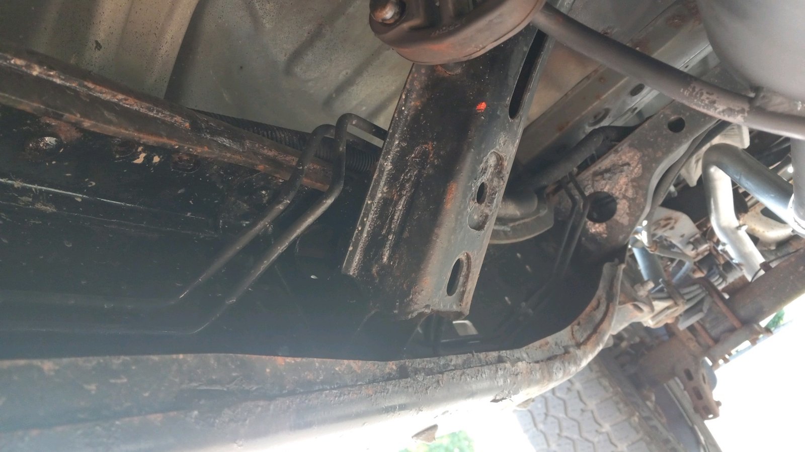

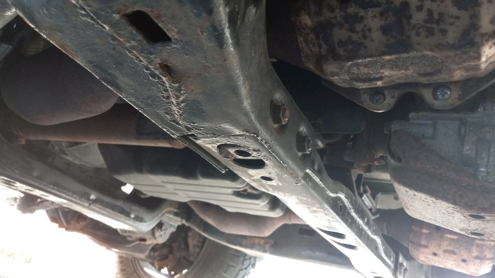

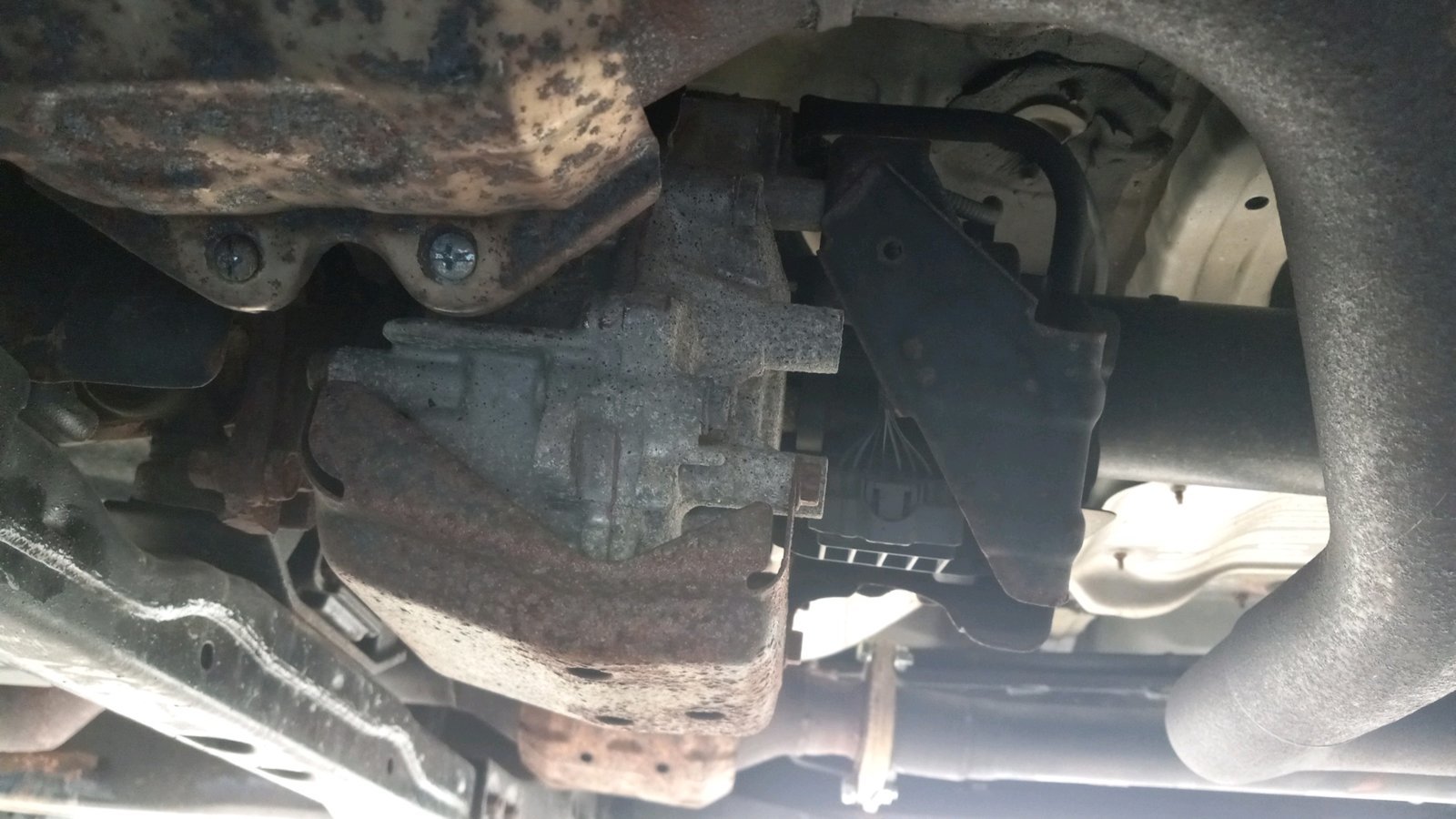

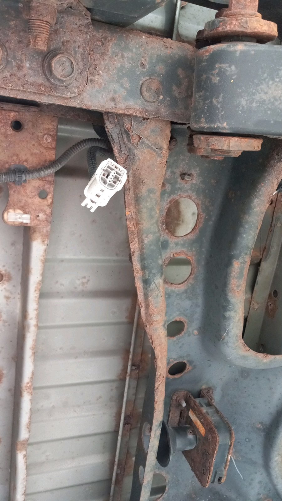

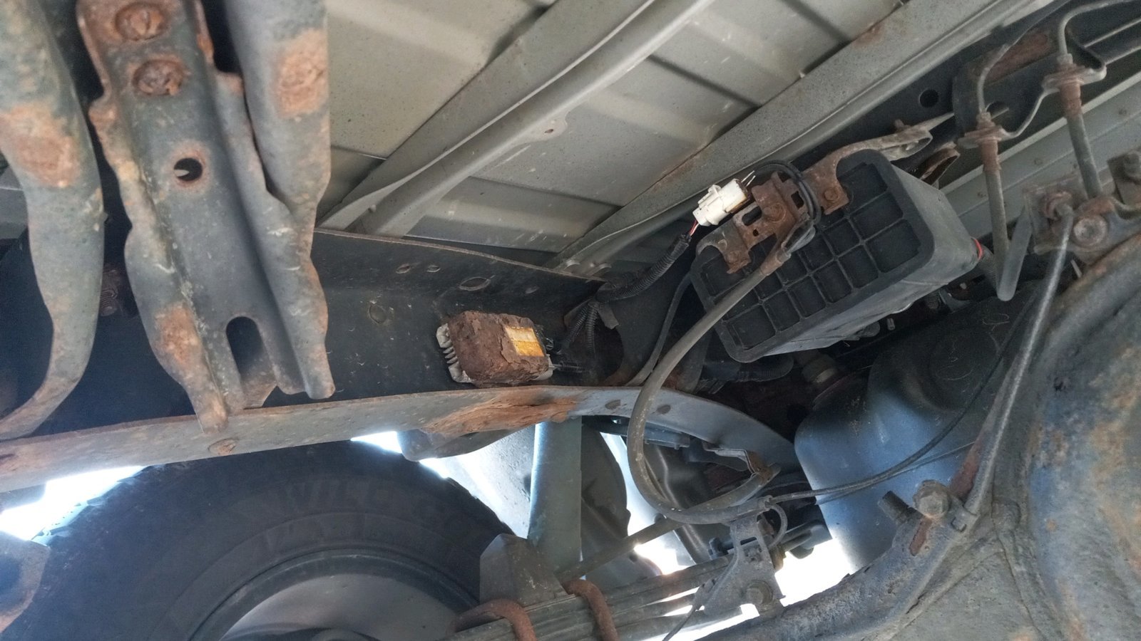

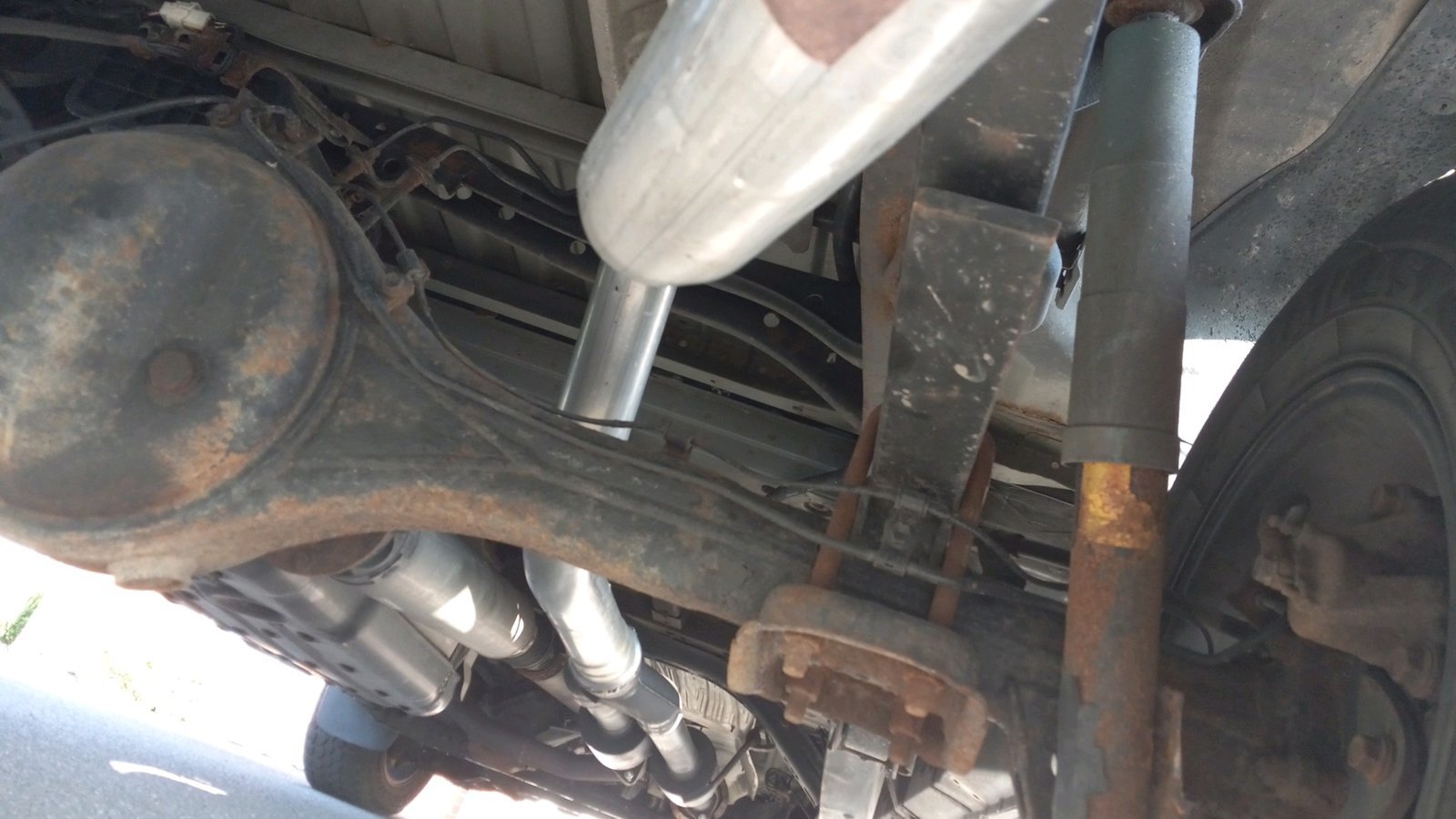

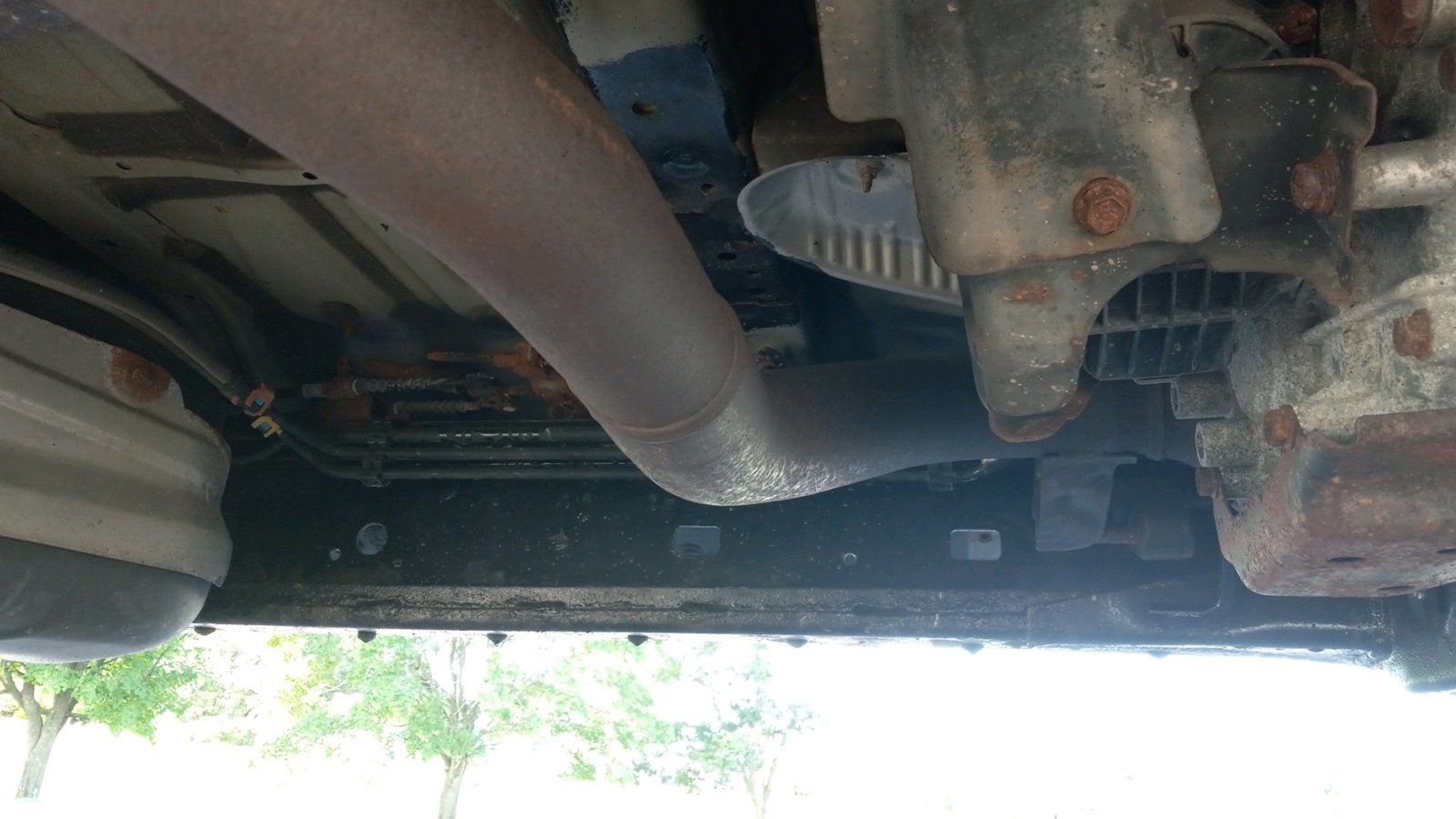

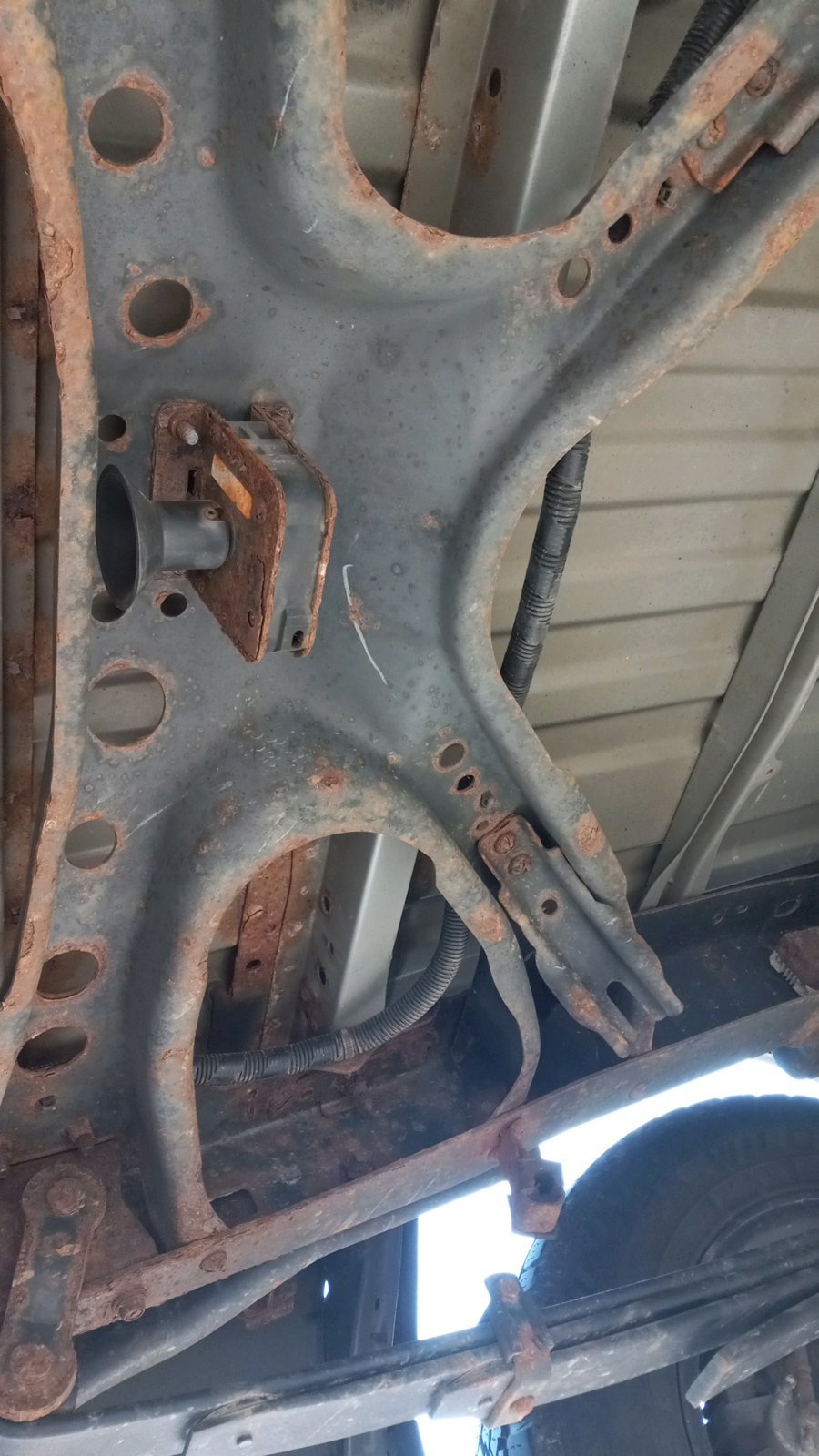

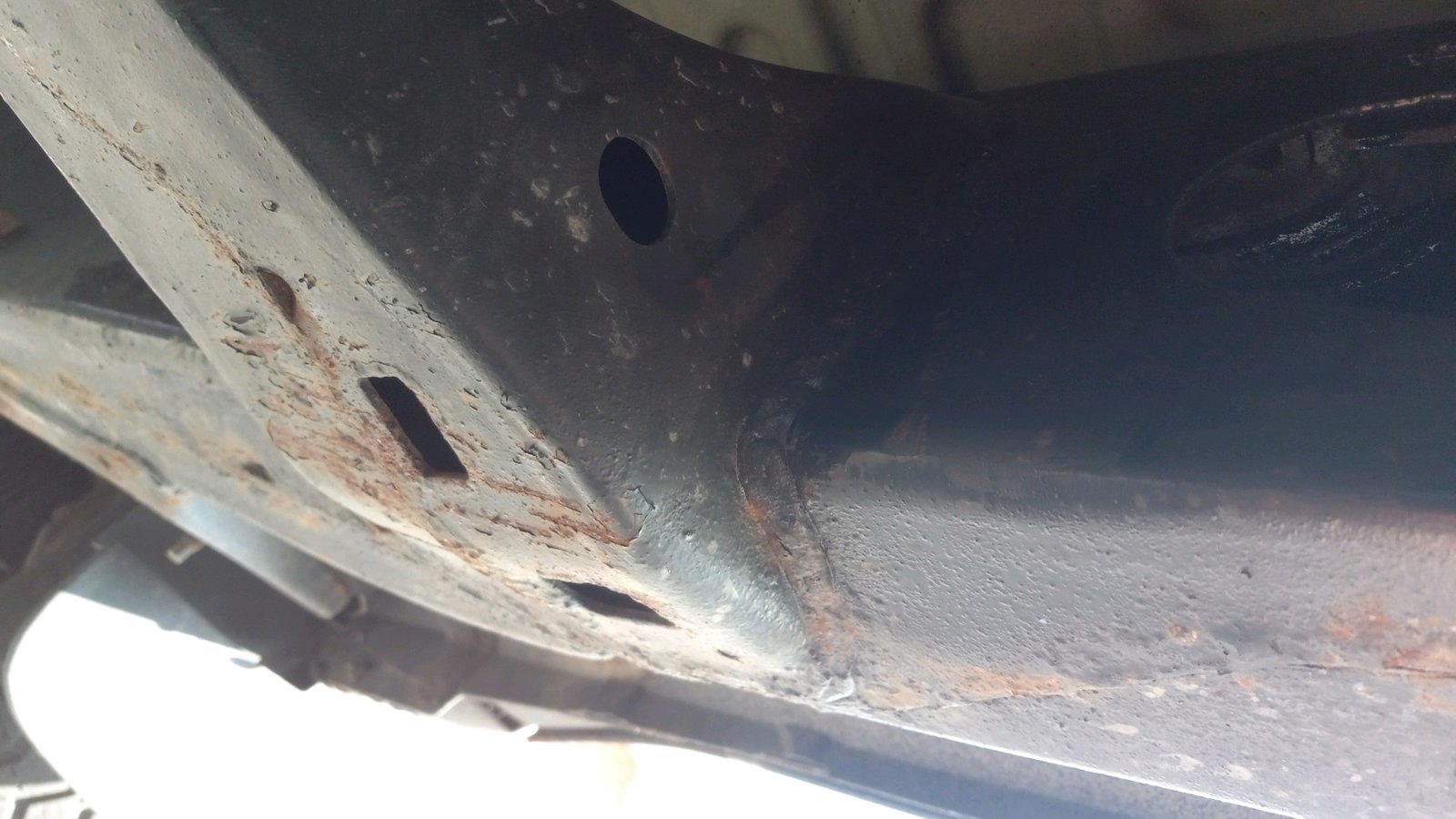

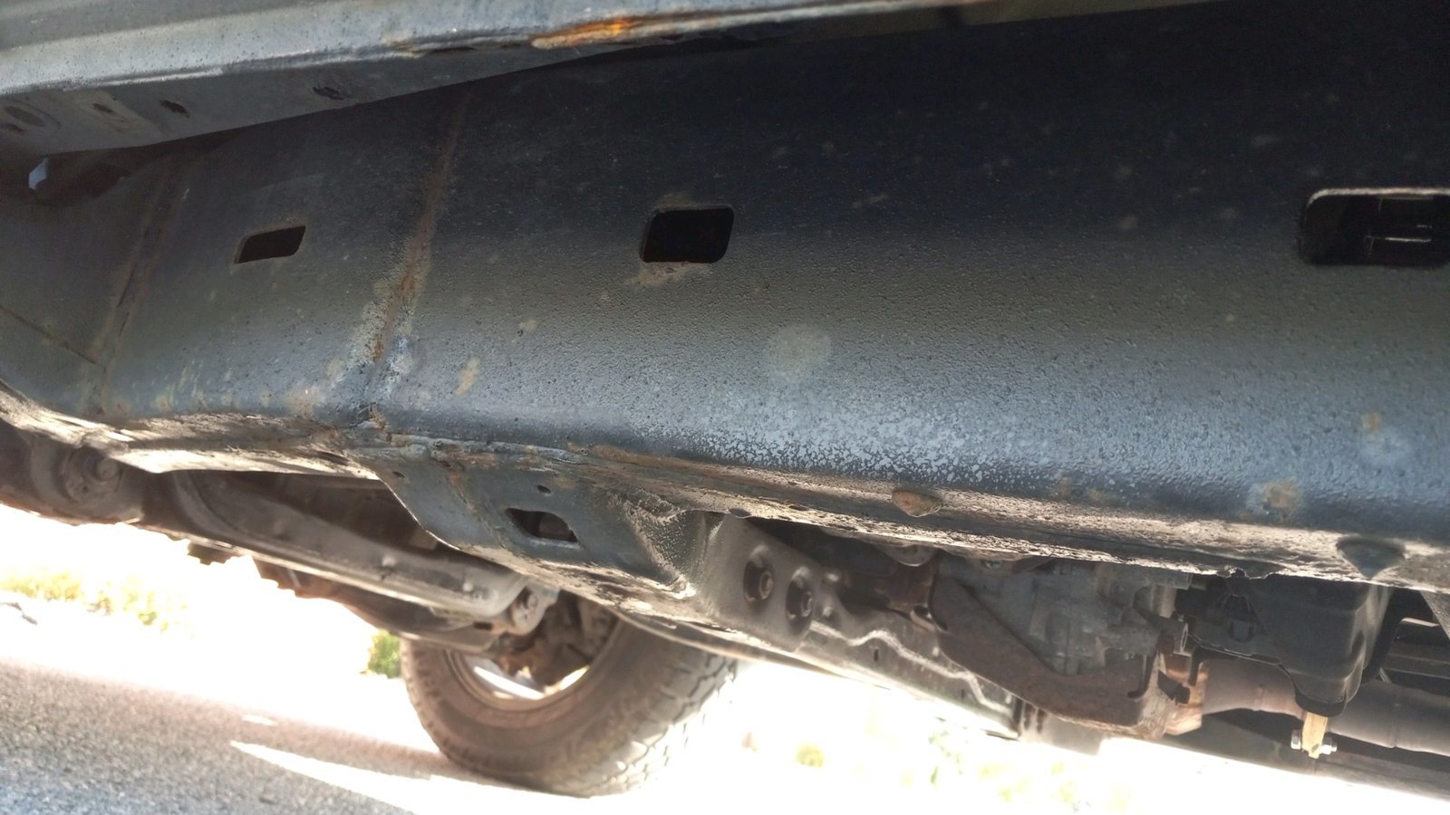

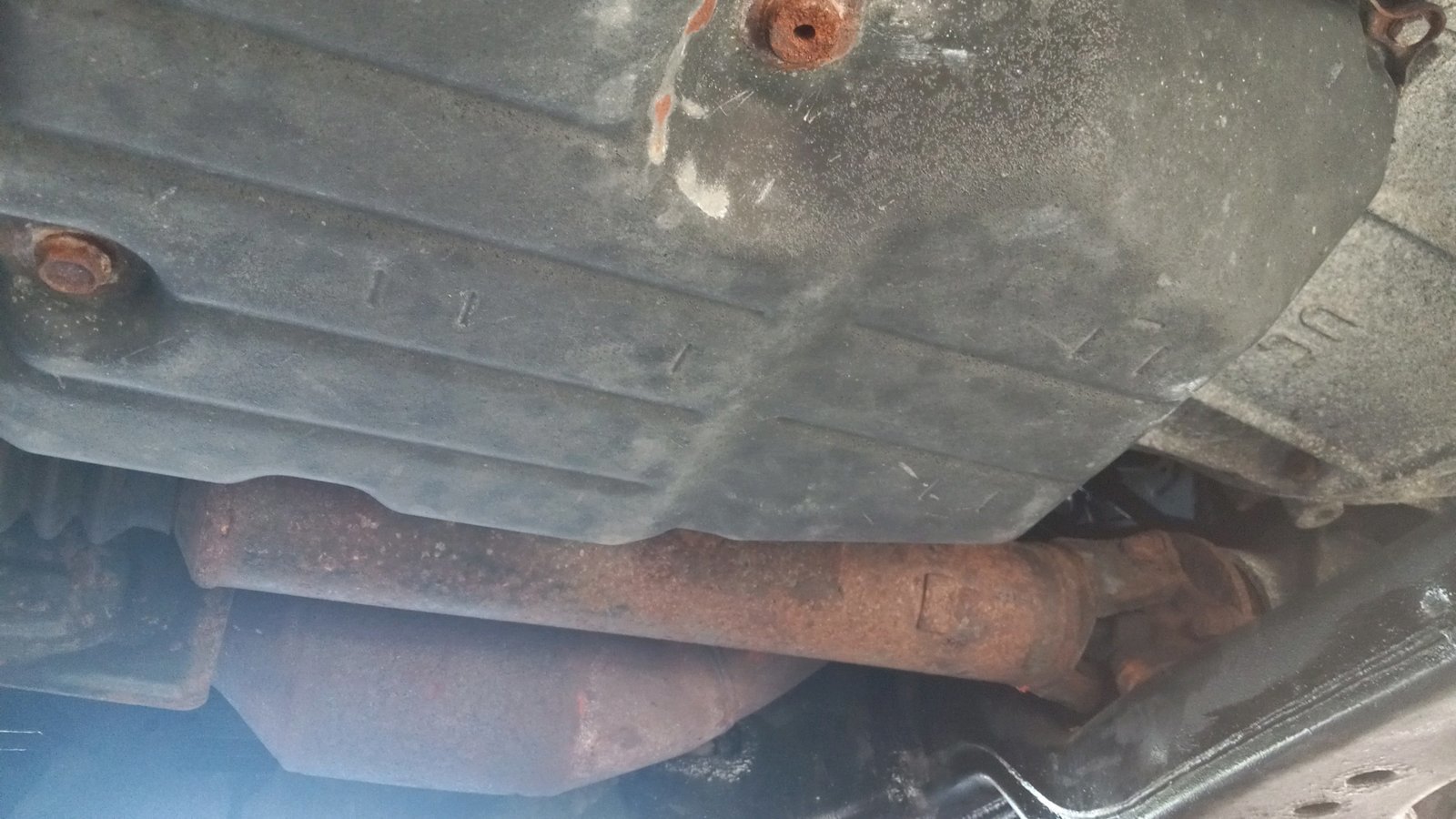

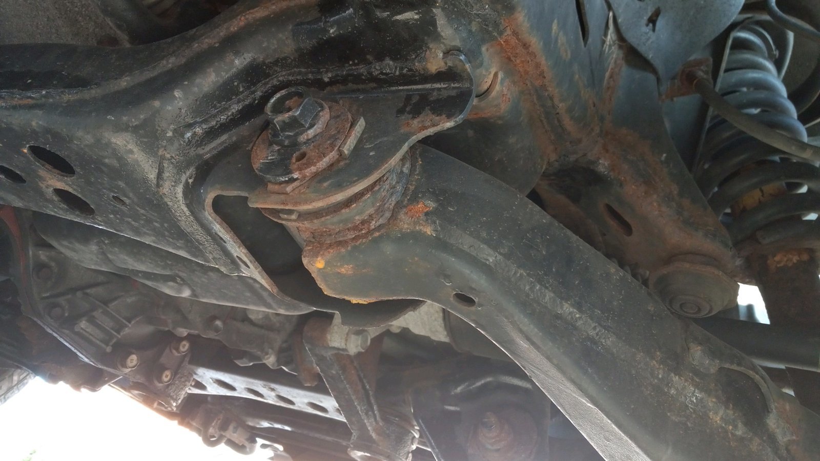

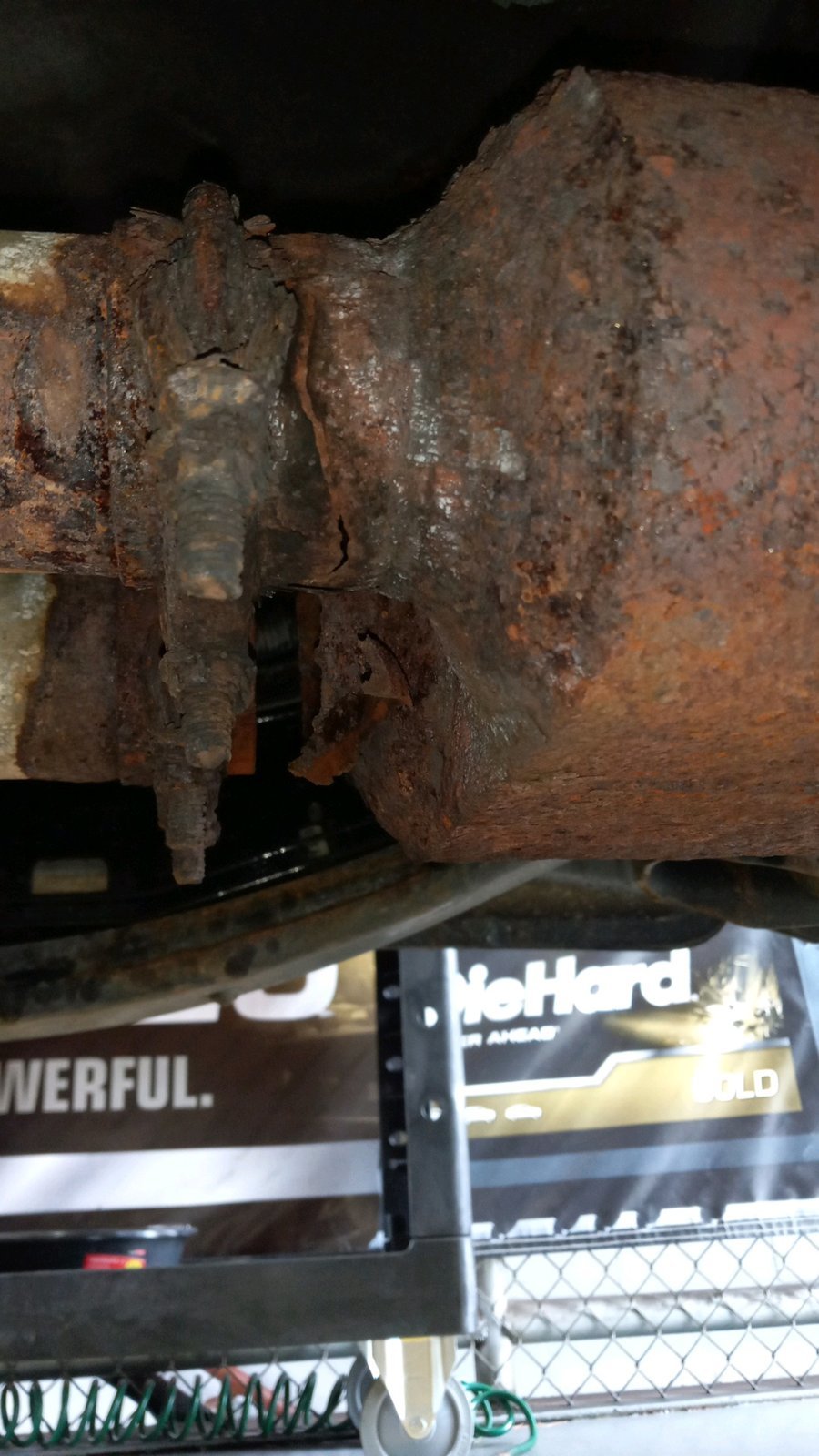

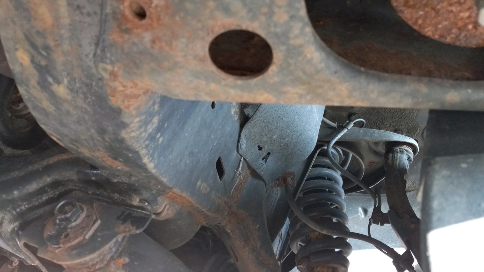

    It was not really that bad. I did, and do, have some rust along parts of the body, and some of the changable parts, but the frame is really solid looking. I did have some surface rust on it, but I ground out as much of the rust as I could, hit it with rubbing alcohole, and then coated it with Por 15, I think is what it is called?
    The parts that are changable I have just left because when it gets bad, I'll just change it. But the truck is 14 years old and has 186K on it at least.
    Here are some pictures of random places underneath.
    Pic1.jpg Pic2.jpg Pic3.jpg Pic4.jpg Pic5.jpg Pic6.jpg Pic7.jpg Pic8.jpg Pic9.jpg Pic10.jpg Pic11.jpg Pic12.jpg Pic13.jpg Pic14.jpg
    MTRock and koditten like this.

    That looks a lot better than I was expecting considering the condition of the exhaust. You have a done a good job of ensuring longer life out of that for sure....
    TRDGoodness[OP] likes this.

    Thanks. I have been working on it. Trying to take care of what I can with the money I have. This exhaust was a huge hit on reserves, but had to be done. Hey, still cheaper than buying a new truck!
    I still have some rust on the hood, and had the money for that (along the inside under the plastic "chrome" front grill. Trying to balance expenses with family and vehicles in a single income home. This website has been a huge help with diy tips.
    As you also notice, the spare tire mount is rusted (was this way when I bought the truck), and the spare tire has a crack in the rim. Those two things will have to wait as this is usually towing my camper or doing light overlanding with a bed of camping gear. Perhaps one day.

    If you’re towing the last thing you want to do is get a flat and replace it with a spare with a crack in the run. Do yourself a favor and get a stock run that someone is unloading and mount the spare on an intact rim. You should be able to find them for cheap - some people even give them away occasionally

    I noticed your spare tire winch was was bad, that will have to replaced before you can suspend your spare under the truck.
    Regardless, the small amount of rust issue is nothing to worry about.
