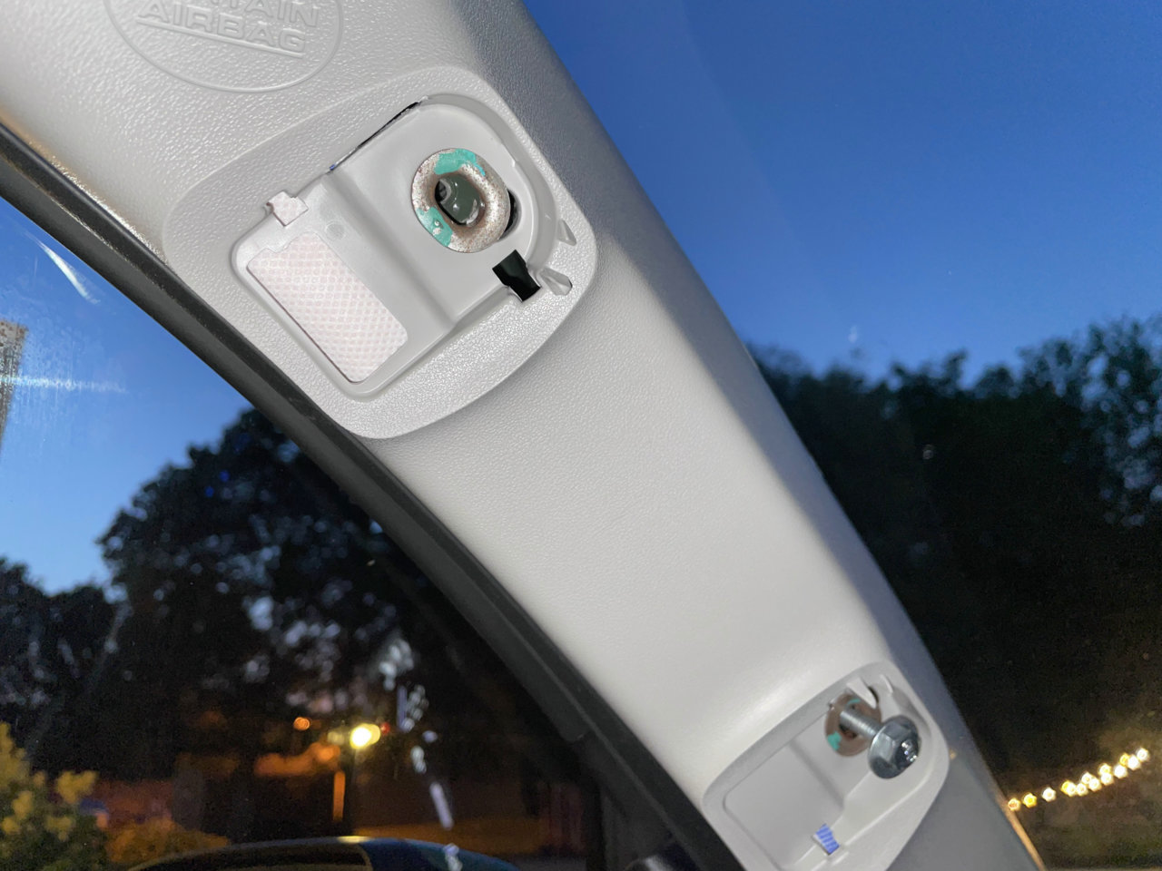

    They are making the same number of A pillars per vehicle as before, so no, I don't think there is any added cost to that aside from retooling the drivers side mold. Whoever or whatever is tasked with making the A pillars is still making the same number of them; it's just that they pick up a different tool (mold for 2014+) to make the Tundra driver's side A pillar.
    It would seem to me, they have the same costs (labor, supervisory, energy consumption, regulatory) for the pillar (as every truck still has two pillar trim pieces), and lower costs in all the aforementioned areas for the handle (which is the part they made 100,000 fewer of each year).

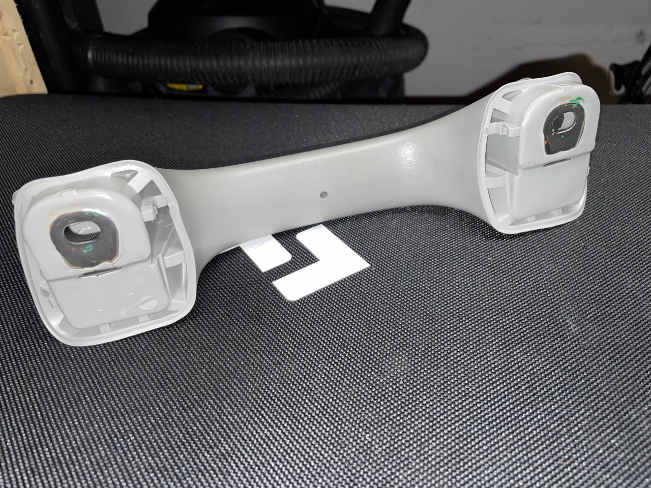

    Yeah we can google all day and find tons of handles made out of plastic that are cheaper than this one. Those handles are not made by Toyota, and they don't retail for $70.54. I highly doubt that this steel-reinforced beast of a handle cost $1 to make:
    There are at least 5 pieces to it that I can see (3 plastic, 2 steel). It feels like there might be more steel in there, but I'm not sure. I don't want to cut it open to inspect it further, lol. It feels fairly hefty in the hand, but I don't have a postal scale to weigh it with. Toyota designed it to repeatedly withstand Tundra drivers (up to what, 300-lb?) yanking themselves up into their seats without failure. By the way, when is the last time you've heard of one of these failing?
    And just to show the difference between the pillar pieces, here's what the A pillar trim looks like with the handle:
    It is more complex than my stock A pillar and is reinforced with steel as well at the handle mounting locations. Toyota's retail price on that piece is $161.19. Interestingly enough, it feels to weigh substantially less than the handle, yet it costs more. Reasonable conclusion: there must be costs associated with producing these parts other than materials costs.
    I still think they spent relatively little to save a lot, and the IIHS test results don't show any correlation to removing the driver's grab handle. All head/neck results were at the highest rating from 2010 on.

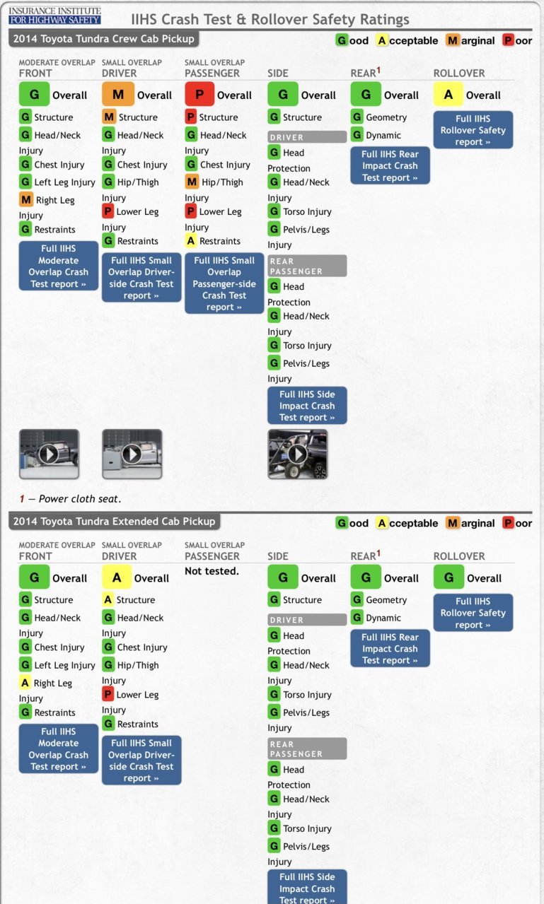

    Pic from IIHS

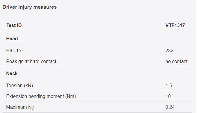

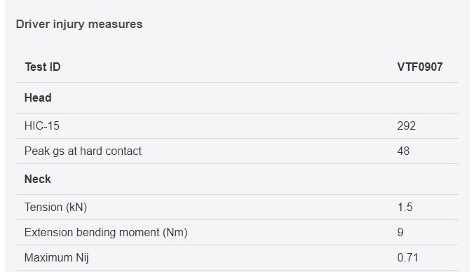

    Examples of data not included in the summary:
    2013 truck
    2014 Truck
    Both those above are from the moderate overlap, because there wasn't a Small Overlap until 2014. These are it's numbers.

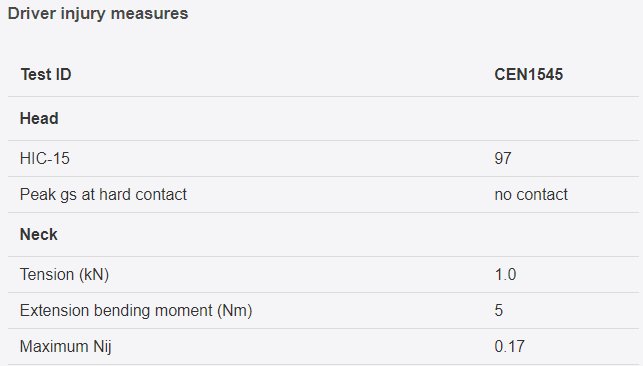

    Yep. Notice that in the 2014+ driver's side small overlap, the Head Injury Criterion, which measures the likelihood of trauma to the skull or brain, despite no grab handle and "no contact" is higher than the HIC for the 2019 passenger dummy that actually hit his head on the grab handle, shown here:
