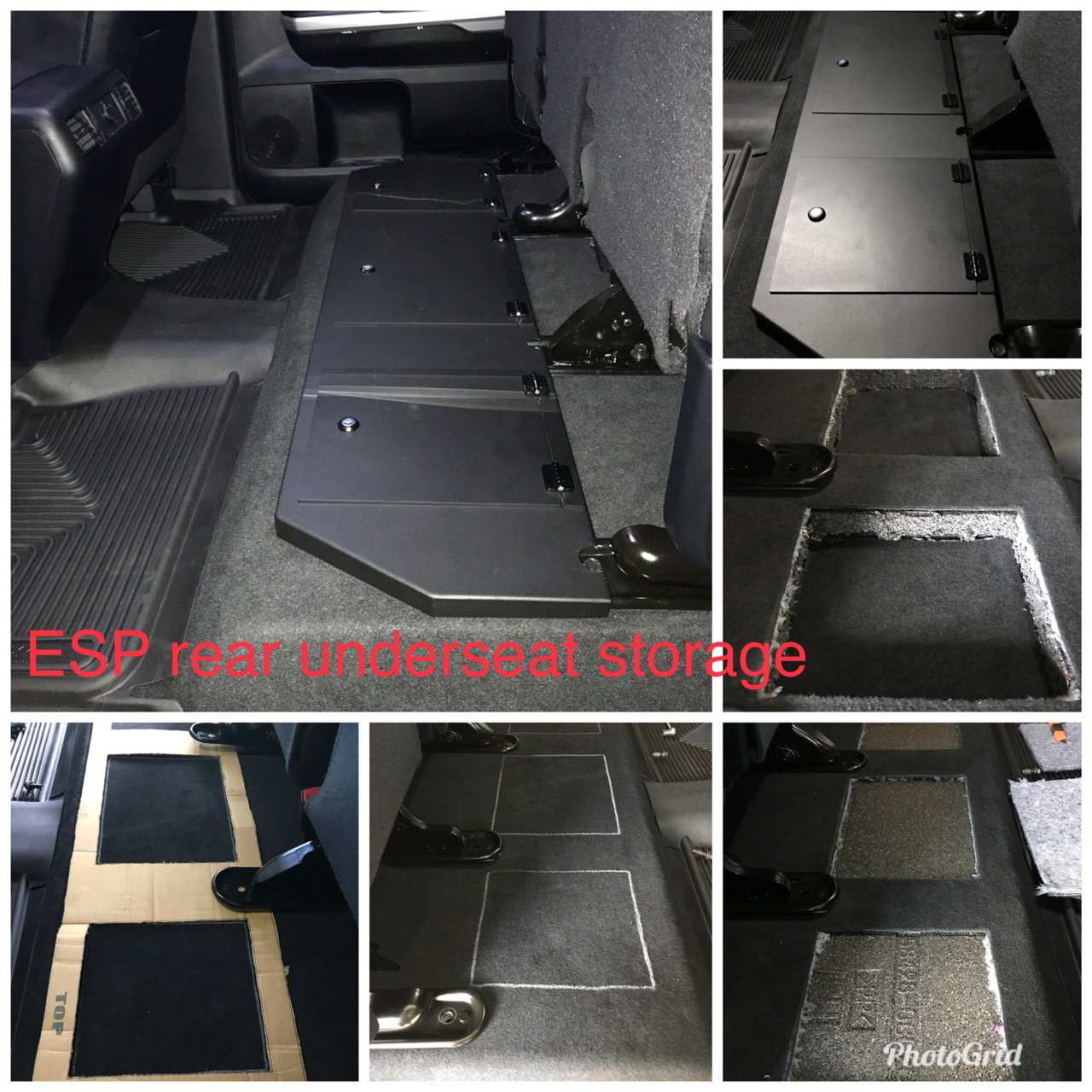

    If you get the ESP Long box it has separate openings under the individual seats.

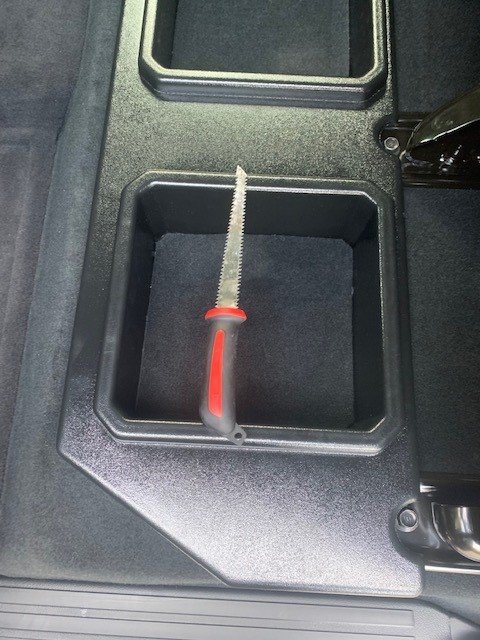

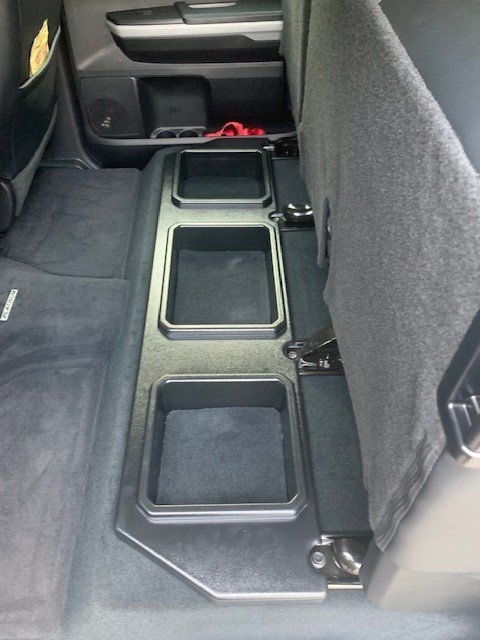

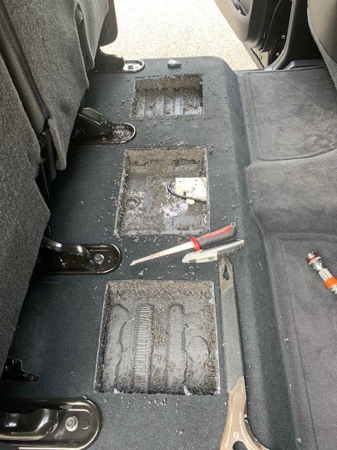

    Just got around to doing this today and came out perfectly. Make sure you align and tape template in place. I used a heavy tip pencil to outline. Sheetrock knife to get through carpet and thin pad under. Then used a keyhole saw that worked quickly through the styrofoam. Once you cut the squares, cut the styrofoam down the middle at a 45 and it will lift right out. Trimmed left over carpet to size which took some back n forth. Took about an hour and a half with interruptions.
