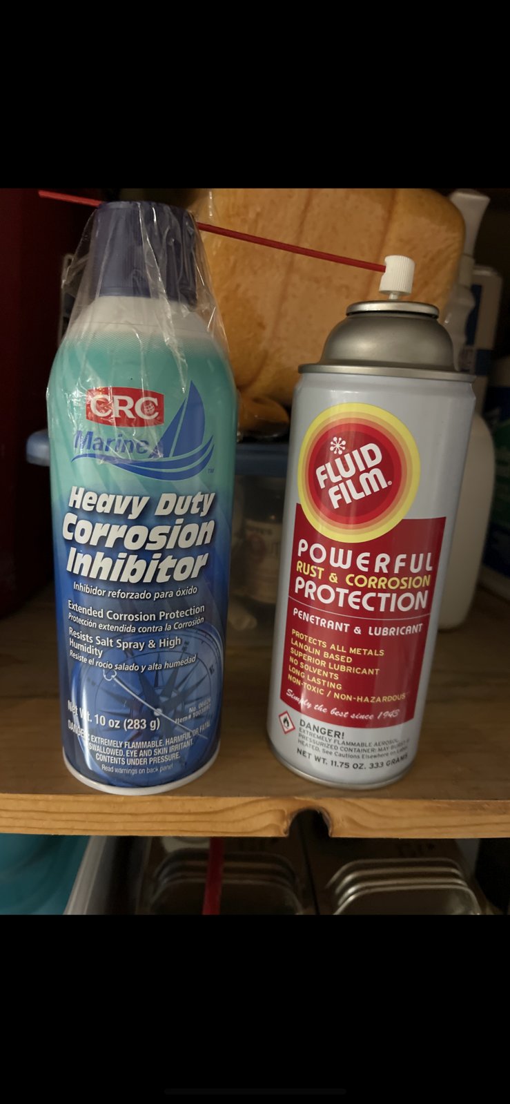

    Another vote for CRC Marine coating. I use that and FF in some areas. The CRC lasts much longer. IMG_3859.png

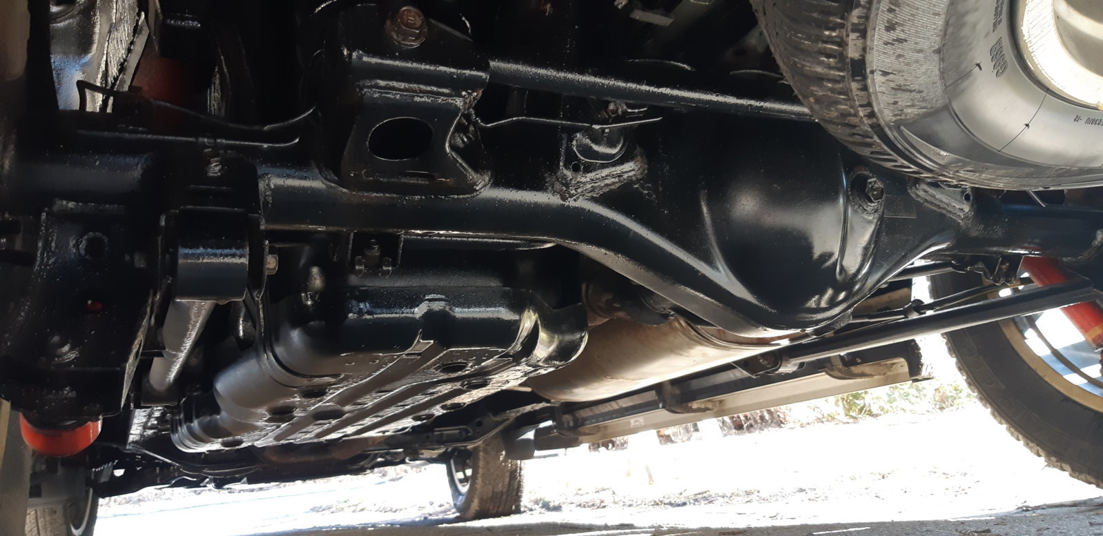

    Moly bearing grease via sponge held up for 3 winters in Maine with no rust.
    Previous fall I removed bed and treated with Cosmoline RP342 and another layer of CRC marine.
