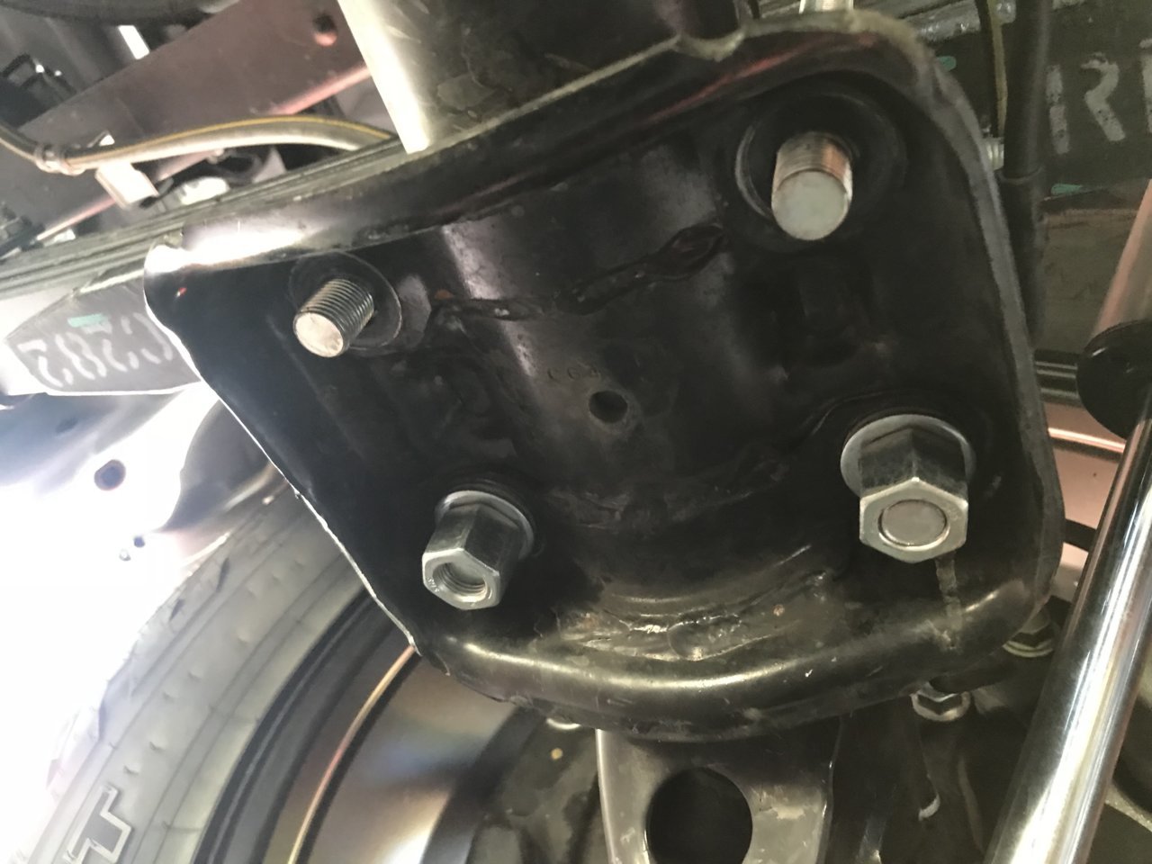

    Do you think they put them on but it was not fully threaded so they fell off sometime while I was driving? Leaving a couple nuts off is seriously kinda crazy.

    Hard to say for sure. Still horrible even if that's the case

    I dont think so. Those nuts need pretty good torque, around 80lbs if I remember right. I remember laying on my back and having a hard time getting there from lack of leverage when I did mine. They wouldn't fall off and shouldn't be barely on like that, u bolts stretch so they would grab more thread as they are tightened. Guaranty they put them on finger tight and forgot to torque them.
    Not saying blow up their spot but from how they left you that's an incomplete install and seriously dangerous. If they didn't know what they were doing they should have declined the job.

    Might go without saying, shouldn't drive the truck until it's fixed. The nuts that are on aren't torqued, your truck is just waiting to snap that center pin and your axle will depart, taking your brake lines and such with it.

    Dude, that's no joke. If it were me, I'd let the BAR know. There's shoddy work, and then there's negligence that could put people's lives at risk if that were to fail when you were doing 75mph on the 99 Fwy. That never should have gone out the door like that.

    Dude, OP, i would go back and get a full refund! i also would not drive your truck anywhere!!!
    Get that thing AAA to either Milogen Fabworks in san jose, 4wheel drive parts, or Me! one look at the picture, I would have never ever ever ever went back to that shop! that is just down right pathetic. I doubt they even put the leaf pack together properly the second time...
    Also
    Ubolt torque for a 9/16 bolt is...
    galvanized u-bolt is about 136 or plain ubolt is around 109
    I would be worried about your front end even...

    They didn’t put it on right. They left an extra stock leaf on there which is why the bolts or nuts aren’t fully threaded. I saw a video of SDHQ putting some on and they only left the top leaf. It also looks a lot higher than 1.5”

    Yup, I’m gonna try this weekend. I’ve already put new Ubolts on. That’s when I saw the extra stock leaf lol.
