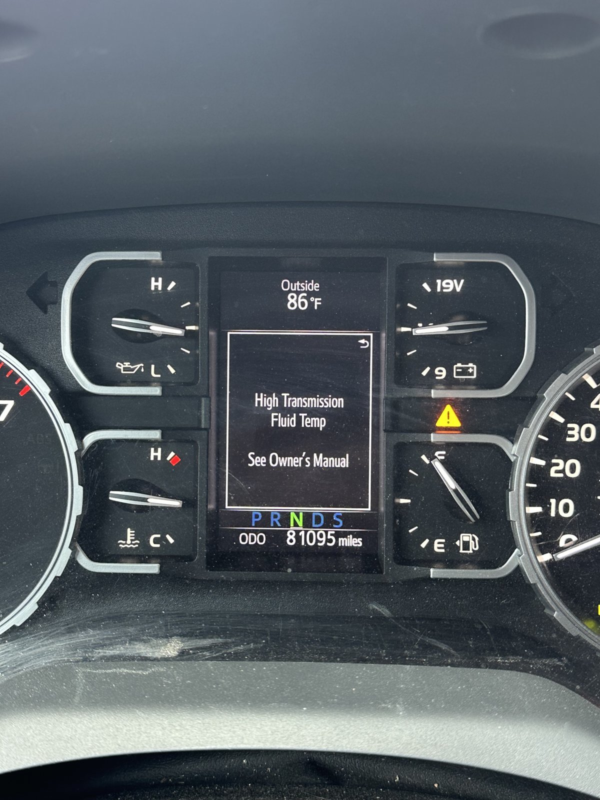

    Was on a 15 minute all highway drive home and backed in the driveway. Put in 4H and began to pull out a 15' Arborvitae tree. Light came on shortly after I started. I shut the truck off for a an hour or so. Think any damage was done or just perfect time to do a spill and fill?

    These transmissions are extremely tough / overbuilt for a half ton - I doubt damage was done if you shut it off when the light came on and allowed it to cool.
    I’d do 3-4 drain and fills to try and get as much of that overheated fluid out as possible - or purchase a cooler and you can do a full swap pumping it out the cooler line 2 quarts at a time.

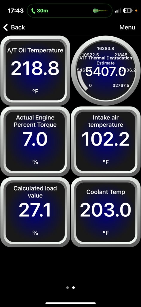

  18. Aug 26, 2024 at 3:35 PM
    #258
    Jaypown
    Jaypown New Member
    Aug 19, 2019
    #34878
    2,044
    Justin
    Rubber City
    2020 Tundra TRD Sport CM 4x4 MGM
    Bought a OBDII reader. Here’s what I’m at now. The trans temp was after a 24 mile round trip with most highway and some town driving. Interestingly, as I’m sitting here in the AC while my wife is in Aldi, the degradation number is now up to 5409

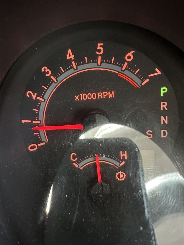

    I could use some feedback from someone who might know more than me. I have a 2011 SR5 with the 5.7L gas engine. It has the “built in” transmission cooler and a gauge on the dashboard - pretty useless (no numbers and just semi circle gauge that goes from C to H). Pretty much if the truck is running, that needle is halfway between the two (see pic). Only goes lower if the truck has been sitting all night and I first start it. Never seems to go higher either.
    But, I have an OBD II reader and use OBD Fusion. According to it, my A/T temp in the pan - when on the freeway whether I am towing or not - sits at 207-210. That seems WAY too high, especially one that has the cooler. Had the transmission fluid flushed less than 2 years ago, drive about 8-10k miles/year, tow my travel trailer during the summer when we go on a couple road trips. But for the past two years it has run that hot - could have been for longer but I only started monitoring it via OBD during the last two years. Could my cooler be bunk, or could there be something else going on? Worries me driving when the temps get that high. But if there is a problem, why doesn’t the needle on gauge on the panel seem to go closer to H? Thanks.

    Needle is engine coolant temp, not trans. Those trans temps do seem high with a cooler though, have you checked for any debris/mud/oil etc. on the fins that would reduce heat transfer?

    The gear symbol around the temp gauge typically means transmission.

    I stand corrected, you are absolutely right, didn't realize that was a gauge on 2 Gens.

    You're realizing why many call that a dummy guage. It won't notify you of a problem until its too late. I'd suggest you try pinning your thermostat to see if that helps bring the temps down.
    Does your truck have the standalone cooler up front on the passenger side? Or do you see 2 lines entering the top of the AC condenser from the passenger side (this would indicate you have the later integrated cooler that combines the AC condenser with the trans cooler). Either way it would be worth inspecting the cooler you have and seeing if the fins might be gummed up with bugs or other debris that is causing it to cool less efficiently.
