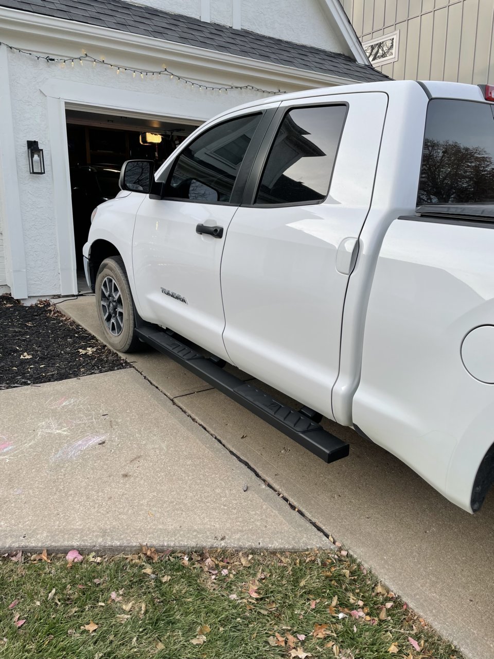

    2012 Tundra
    I added the Tyger Riser 5 inch running boards to my 2012 double cab today, install was simple, only tip I have is to just hand tighten most of the way to allow play on the brackets or you won’t be able to line everything up. The brackets can move about 1/4 inch where they bolt to the truck body which allows you to line them up properly with the actual running boards. They seem pretty well made although I did touch the brackets up a bit with flat black paint as there were a few scratches, but I got them NIB from a local guy and I think they may have been factory seconds based on markings on the box.
