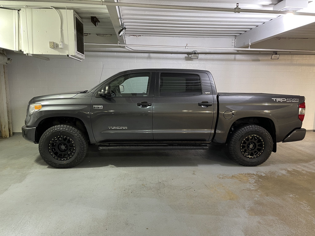

    6112s installed t 1.9 setting - rear 5160 stock height. I love the stance and no rubbing at with my coach builder bumper shims. FWIW I noticed a decent difference in ride quality between stock tires and E load Falken 295s - i didnt notice the ride getting worse after i got the 6112s put on

    also - it is a tad high in front but i will add the warn bumper insert and winch at some point which adds 140 lbs or so and evaluate the stance at that point. it has a tonneau cover which i love for looks but if i decide to swith to a cap , add on board air etc i may have to change the rear up. I know i dont not want sag if loaded up for vacation or towing a 3- 4k lb trailer
