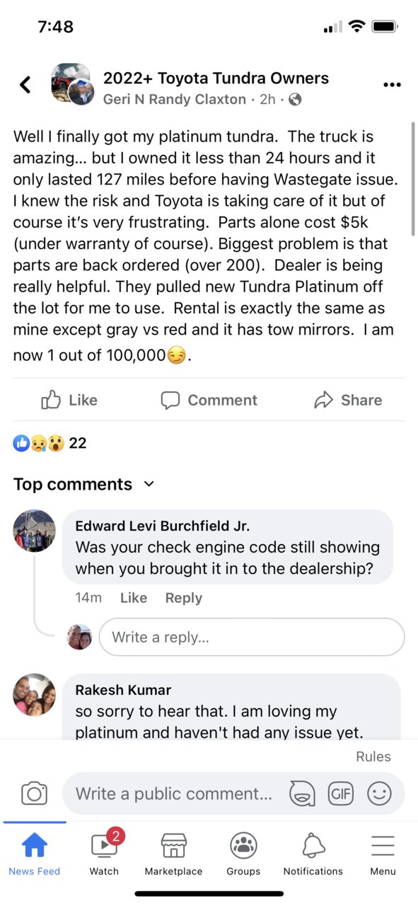

    Not sure what to elaborate on but i'll try. What i wrote was what our conversation consisted of. After sitting and talking to him about Tundras for the better part of an hour and comparing his comments to what i've learned/watched/read/etc about the Tundra over the last 4 months, it was obvious to me that besides working at a Toyota dealership he's also a Tundra geek (and owner of a '22 by the way) because he knew details of the truck the average person wouldn't have a clue about. In other words my bullshit detector didn't go off. Like many on here i've studied this truck.
    As far as my point on the turbos, just because there's a potential software or some other fix for the wastegate issue doesn't mean the turbos are immune from other failures. There's many other ways for them to have issues just like any other part of a vehicle. Example: if you truck doesn't start does that mean the starters bad? Of course not, it could be the fuel system, battery, injectors, etc. are the culprit. The turbos have many other parts besides the wastegate and there's a computer controlling all this stuff so it isn't the only possible problem turbos can have, that's all.
    The main point I was steering towards was with the cabs being lifted off for wastegate issues. Are others seeing this still happening. If not then perhaps Toyota has discovered the core issue and subsequent fix that doesn't require that (software for example), and maybe that helps others with more direct knowledge of this into whittling down the potential possibilities of what is actually happening.
    At the end of the day none of us know details on this issue/fix. What i find interesting is how one theory catches and everyone seems to believe it. I was just sharing a conversation without trying to steer anyone, take it or leave it.

    Thanks for elaborating. As of yesterday in the official online repair resource, Toyota was still telling their techs to replace the turbo for the wastegate stuck open/closed code that most are seeing. There continues to be a diagnostic procedure that I believe attempts to get the code to come up to double check the code prior to replacing a not inexpensive part. The replacement procedure per the manual does involve pulling the cab or the motor. Apparently can also be done via the wheel well, but not per official recommendation.
    You appear to be far from the first customer told a salesperson told it's just a software update. There is even one on YouTube. However, there are number techs out there asking these jerks to please stop spreading misinformation.
    You can imagine how well these customers are taking being told their brand new truck is going to be in the shop for weeks or months waiting on parts. It ain't the salesperson getting that angry call, that gets transferred right back to the service department.
    We needn't compound the the situation asking the poor techs to argue with the customer over it being a parts vs. software issue. Even if well intended, the salesperson wishing it's a mouse click software update are just compounding the issue.
    There have been several techs on here reporting that the issue is mechanical binding somewhere in the actuator assembly.
