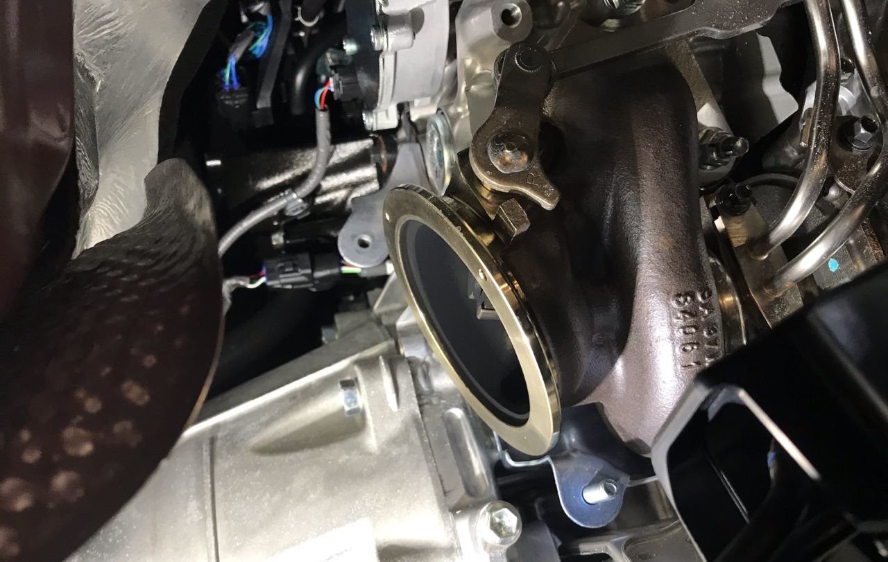

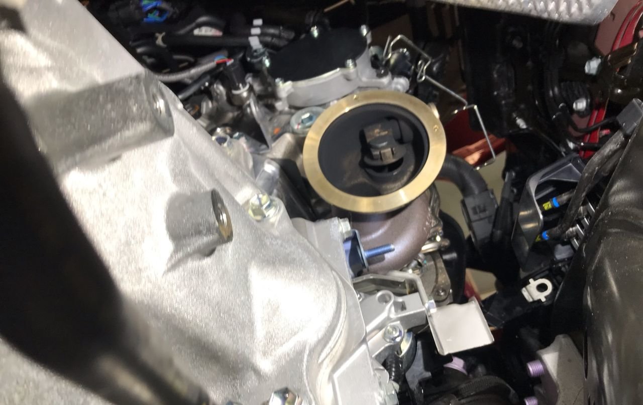

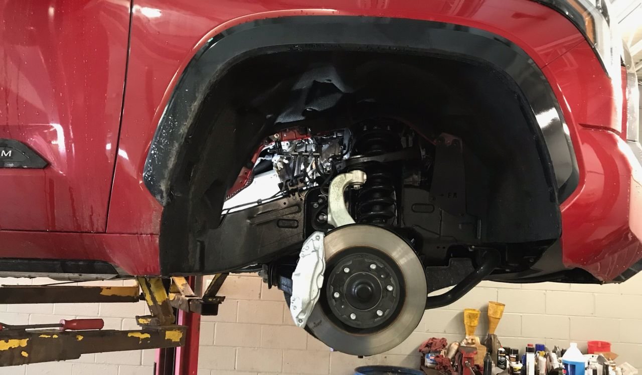

    So tech replaced turbo through wheel well.
    You can see the open actuator in the second pic.
    Original CEL at 54 miles was turbo waste gate stuck open, limp mode, and parking brake malfunction.

    Glad it's fixed. How long did the whole process take (from when you took into the shop till you got it back)?

    Appreciate the photos, glad you got it fixed!

    Great share! Thank you!
    Did the Tech tell you anything specific about what caused the what gate to stick open?
    Others on here will know a lot more, I could be wrong, but I'm, pretty sure I noted something that does not look right. With everything is powered off, I'm pretty sure the wastegate should not be sitting there half open like that.
    In that 2nd pic, I believe that is the wastegate itself. I'm pretty sure it should not be sitting half open like that if the motor is off. Most wastegates open against a spring and without the actuator pushing it open, the wastegate should fully close and returnto its closed fully seated position based on the spring pressure alone.
    Only a guess, but I would think it would take some serious mechanical binding to freeze it open against a strong spring trying to close it. Multiple potential binding points too. At the wastegate hinge, the actuator arm linkage or the actuator itself and probably other locations
