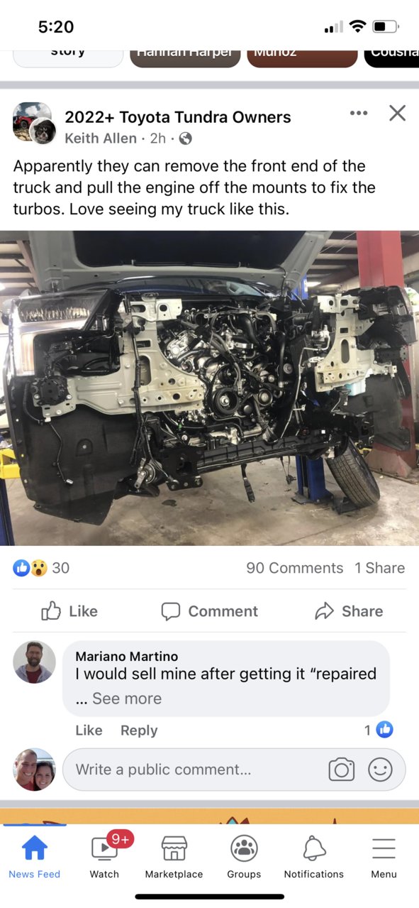

    Someone posted on FB they had the bad turbos but was able to get them out by removing the exhaust system only.

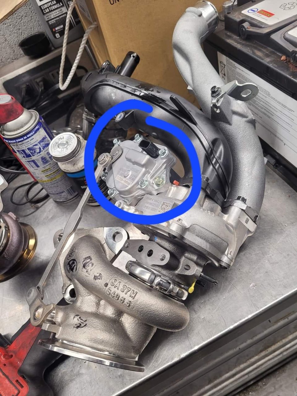

    Good photo from FB with actuator circled.

    Seems like easy to replace that instead of the whole damn turbo.

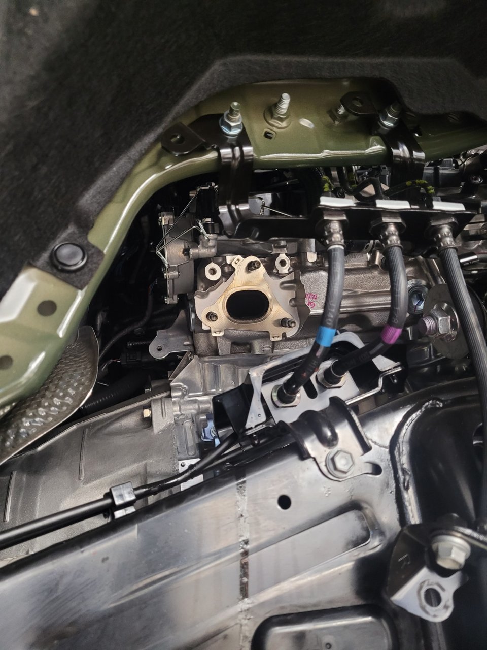

    Wheel-well access, from FB post, so consider the source (just like the frame-off photo).

    This is what I’ve been saying for awhile now. BUT turbo is not coming out the wheel well, it’s pulled out down between the engine and frame. The previous post showed the turbo with all the compressor side piping on it. That probably needs to come off though.
    Yeah, Toyota could but seems like Toyota is collecting the whole assembly for analysis.

    Thanks, now we see the nuts and bolts. Seeing it's a two-part assembly illustrates and explains that TAS bulletin from TakiEvo a couple pages back. The wastegate actuator is a subassembly attached to the turbo. David Chao did a Youtube about this. So (after access by whatever means) the mechanic removes a circlip, a wire connector, a couple of bolts and the wastegate subassembly is out.
    Yeah, the turbo itself doesn't have to come off the exhaust manifold.
    Good photo.
