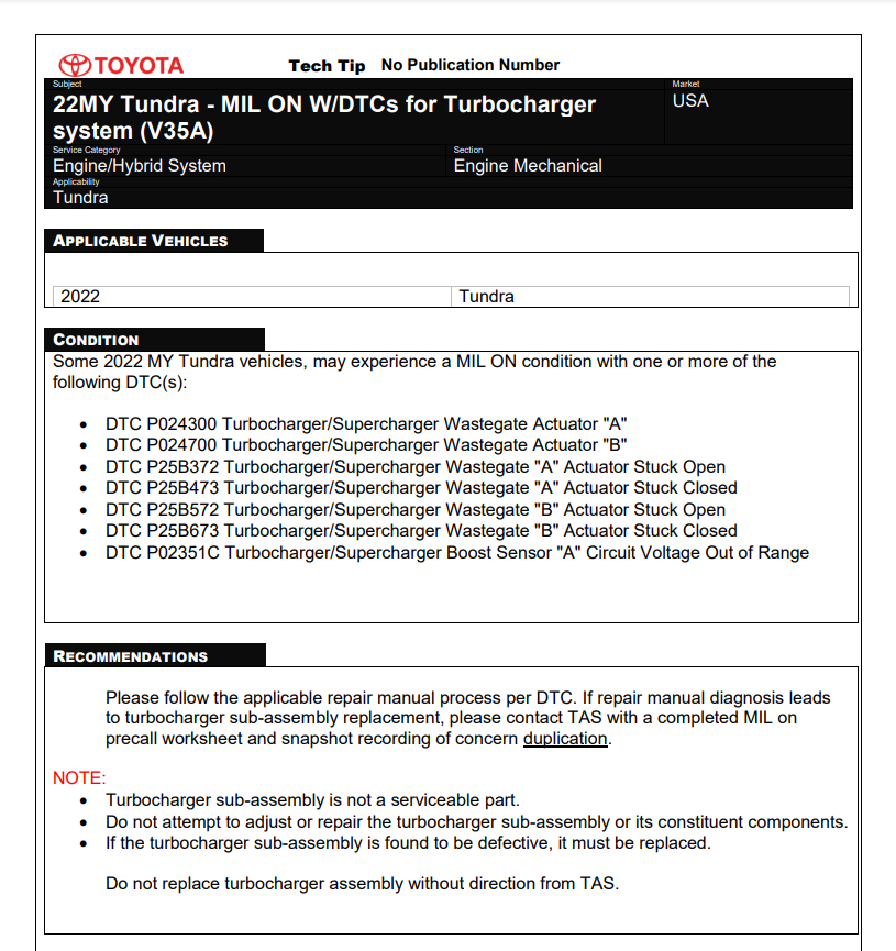

    I noticed that Toyota officially states "turbocharger sub assembly is not a serviceable part"
    This means that despite being 2 main, separate components, it is assembled in such a way that the entire assembly needs to be replaced.
    Basically, if the actuator is a $400 part, and it fails, you get to pay thousands to remove a good turbocharger.
    Not trying to bash the truck, but it's something to keep in mind for those who intend to own past warranty.

    Would love to know more about what the TAS and MIL in the recommendations mean along the last note about not replacing without direction from TAS.
