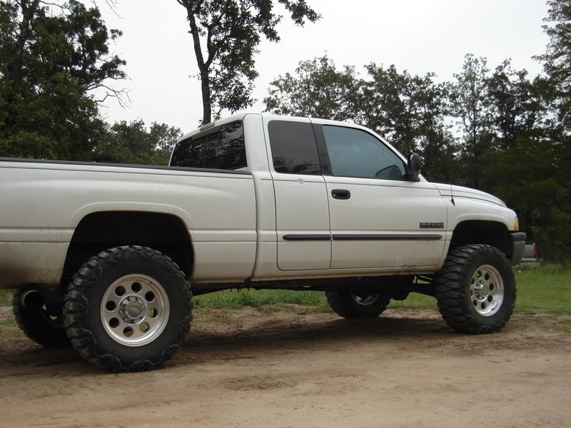

    It does indeed. If you ever spent any time around the track at Marion, I was the guy who broke this truck regularly… billet shafts couldn’t keep up with me trying to cut lights :rofl:

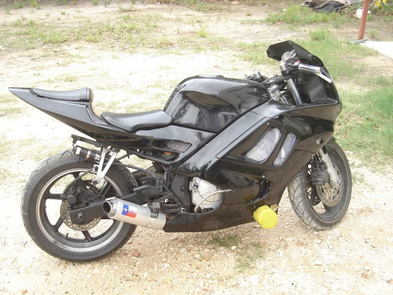

    I also managed to blow this bike up at the 8th mile mark but was pulling just behind a Busa, not bad for a stock length 600, but I got greedy with the boost.

    Never Marion. Did run at Little River a few times. P-Pump swapped 24v, Hamilton Cam, S472, DTT full billet, etc.

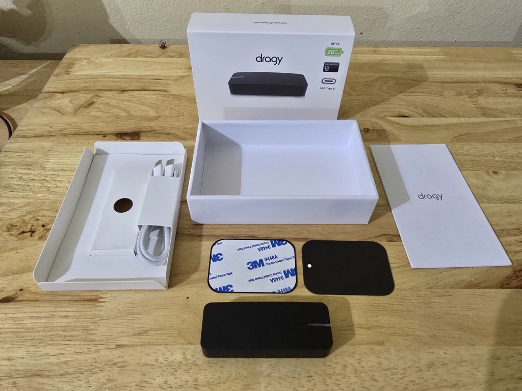

    Received my Dragy DRG70-C today :)

    From website:
    Updated hardware Dragy DRG70-C
    • Ublox 10th Gen high performance GPS Module (DRG69 the previous model was 8th gen)
    • Extremely low power consumption up to an incredible 25 hours + DRG70-C comes equipped with a USB-C charging port (DRG69 & DRG70 feature a micro USB charging port).
    • Better accuracy and positioning vs previous generation Ublox model.
    • Concurrent reception of up to four GNSS systems (GPS, Glonass, Galileo and BeiDou).
    Jego likes this.

    Additionally, I watched some videos on YouTube comparing the old dragy with the new one, where the new version showed faster results and smoother graphics, confirming higher accuracy.
