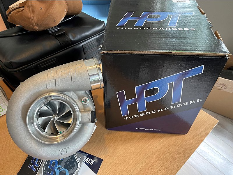

    Quick Update - 08/30/24
    We are already starting our build process on the 2016 TRD Pro, well at least the parts gathering!! LOL.
    Starting with this sick HPT 7675 (F2.5) Dual Ball Bearing Turbo. This thing is bad ass, capable of way more than we will ever need, will spool lightning fast and give us a nice and cool air charge. More Info Here: https://www.turbokits.com/hpt-f3-7675-turbo.html
    https://youtube.com/shorts/Xu76IgfuXpc

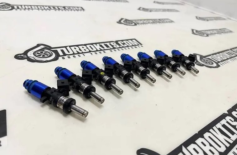

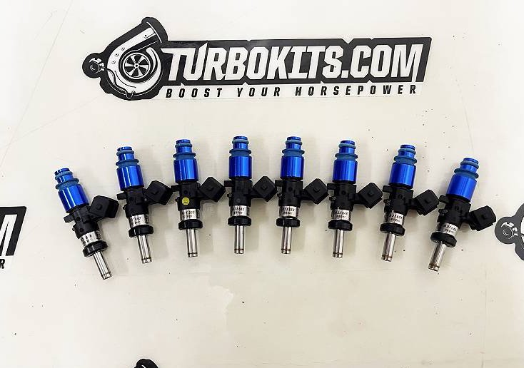

    We also have the new 880cc Injectors in and running on our 2008. They are SILKY smooth! Only took 2 map revisions to have them dialed and running better than anything we have tested so far and at 5-6 PSI, were only seeing about 40% duty cycle, so TONs of head room. They drive like stock, smooth as silk, and idle perfect!
    We will continue to mess with them and get some DYNO results as soon as possible.
    The 2014 is just about maxed on what the Stage 1 can handle we feel, we are running about 5-6 PSI, definitely picked up 50+ HP and TQ by the Butt DYNO. We'll get the tune finished up and get it on the DYNO. Then swap to Stage 2!
    That's all for now. Keep the questions coming. We do enjoy chatting with all of the interested Tundra owners on the phone, it's great to hear use cases and talk about the truck in general and what we can do to help transform it to each want.
    Have a great holiday weekend. We'll see you on the FLIP!

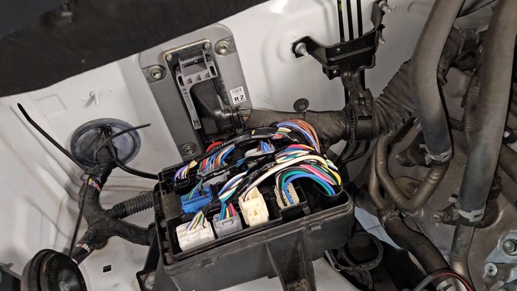

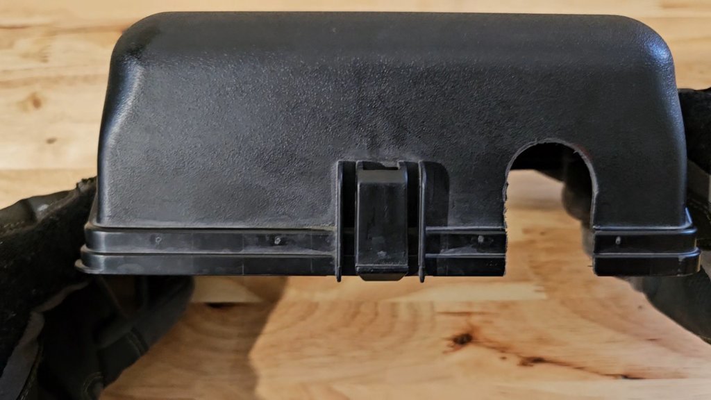

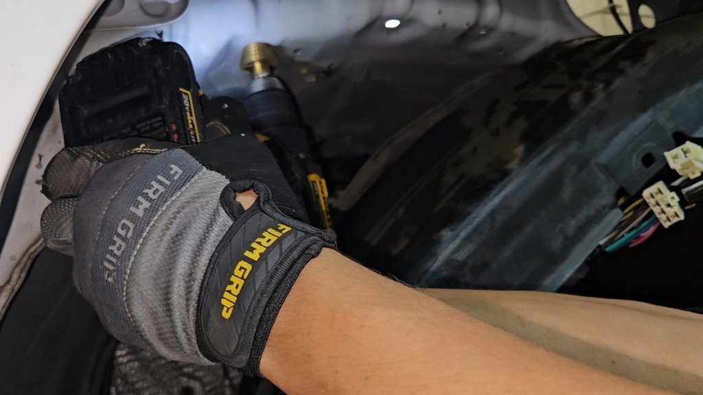

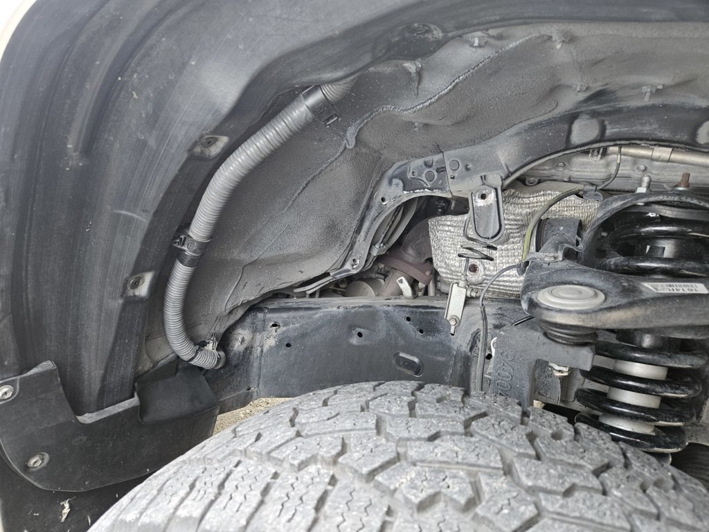

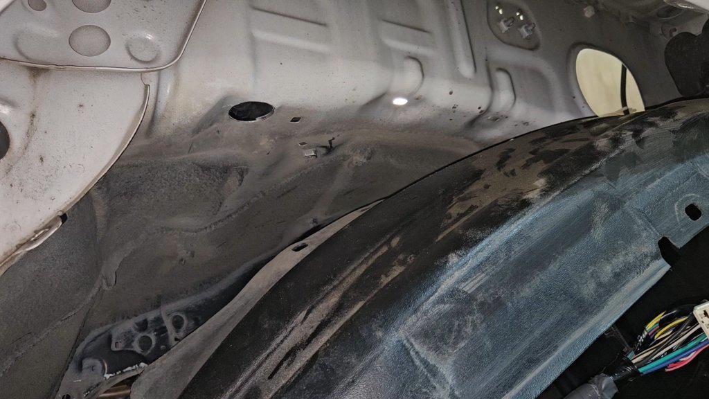

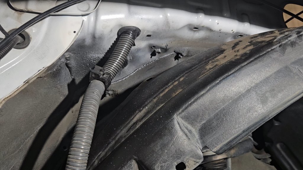

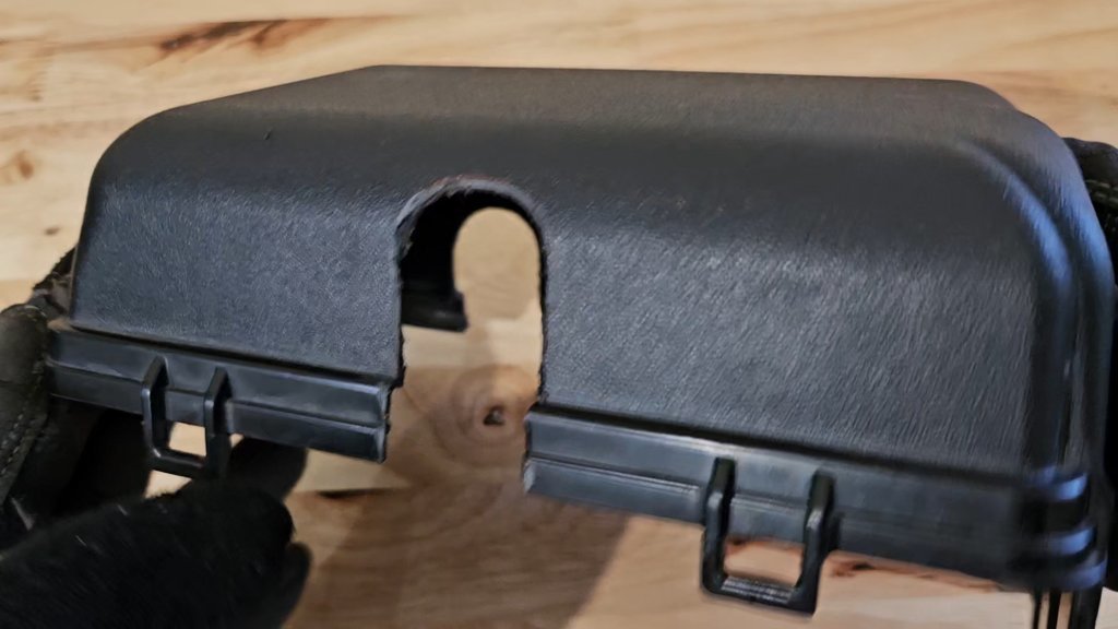

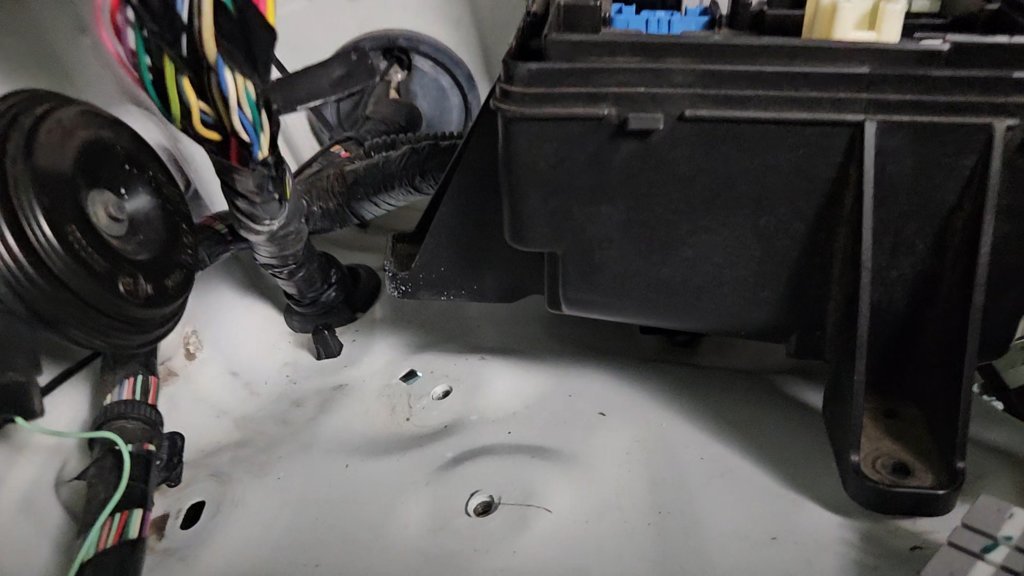

    Quick update: I had a chance to work with the harness and junction box re-location. Here are some pictures about the process and will upload a video soon about these steps!

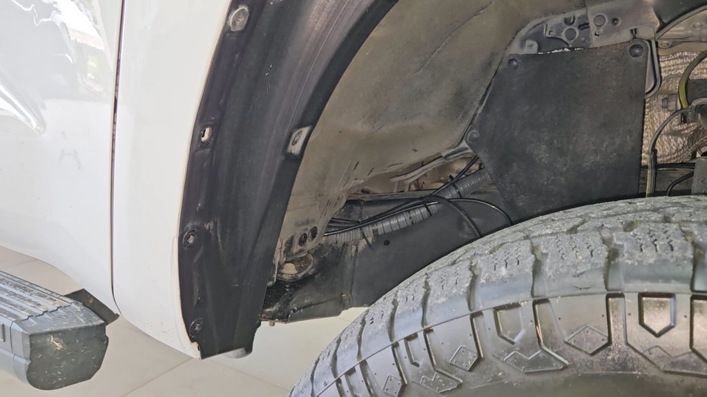

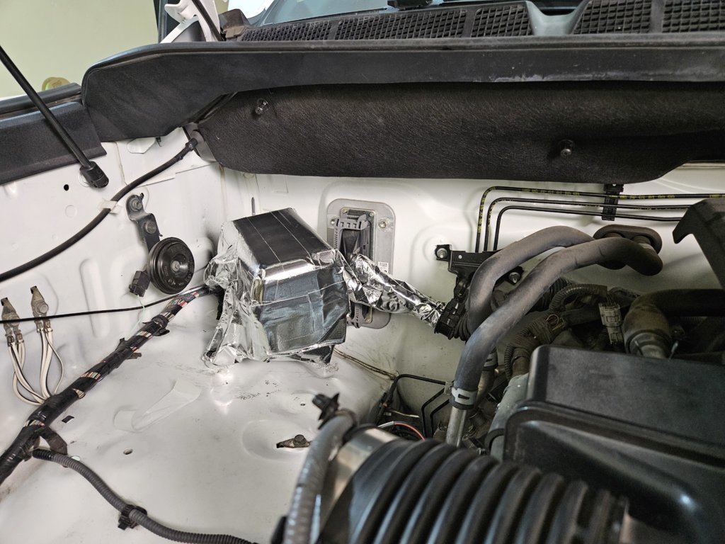

    This is how it looks now from the outside.

    :cheers: Nice work Jego! Super clean look! We will definitely update the instructions with the pics from the white truck. Much better contrast than the black one!

    Good job!! By far the hardest part of the entire project because it involves the only drilling required. Rest is easy and smooth sailing.
    Recommendation: if towing, use the matting on the right side of that box. Your taping skills are far superior to mine, though.
